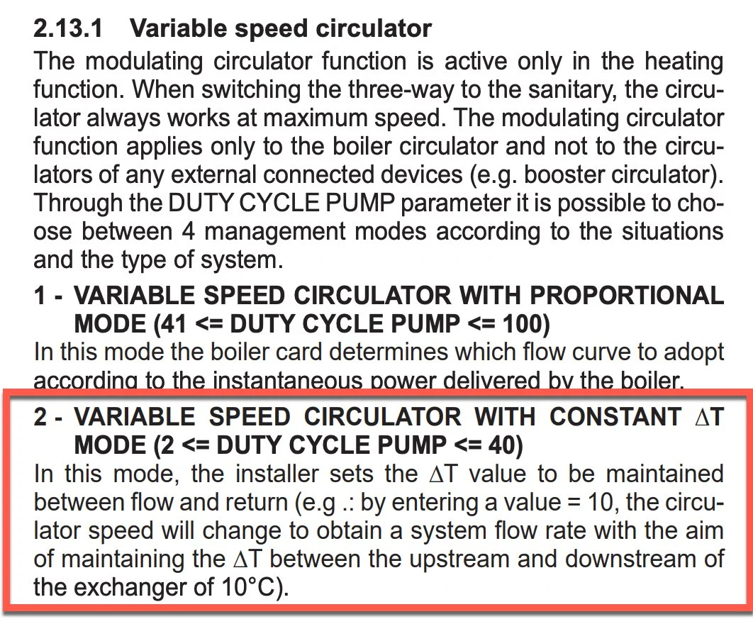

This is from the Unica Max S I think but wonder how compatible this feature would be with standard or smart TRVs that keep increasing the dT as they throttle in?.,
It's all a bit confusing for me at the moment. I don't what they mean by "sanitary" or the "boiler card".
Is this a continuously variable speed pump? As the TRVs throttle in, would it need to speed up to keep the same dT?
As delivered it runs self modulating at setting 85 which can be adjusted. It will operate anywhere in the graph shaded area. If you set a parameter between 10 and 20 then the pump changes to hold that ∆T.
If TRV's close the pump will slow down rather than speed up.
'Overpumping' is the cause of narrow ∆T's.
The software adjusts the pump speed dependant on parameter settings based on current draw in auto mode.
