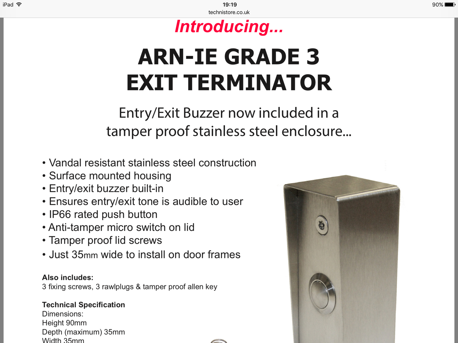

IMG_1796.PNG Yes program it as exit terminate , for setting and set a zone as exit terminate , wire the button to this
