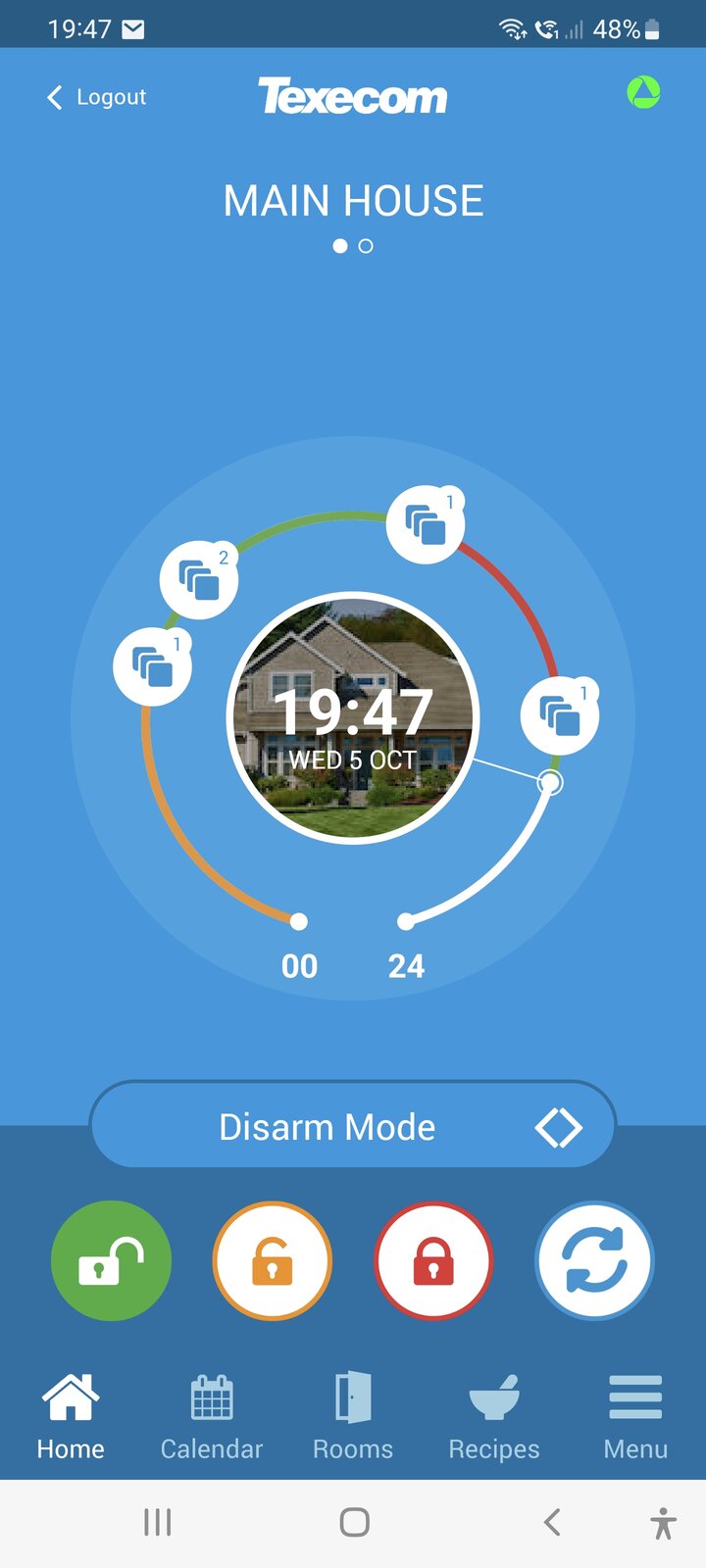

I have the Texecom Premier Elite 24 with smartcom and Wintex. All has seemed fine for a long time, but I've just noticed that the red full arm button on our Apps, puts one of the part arms on instead of full arm!
I haven't noticed anywhere to 'set' what action the red App button does - is it editable somewhere please?

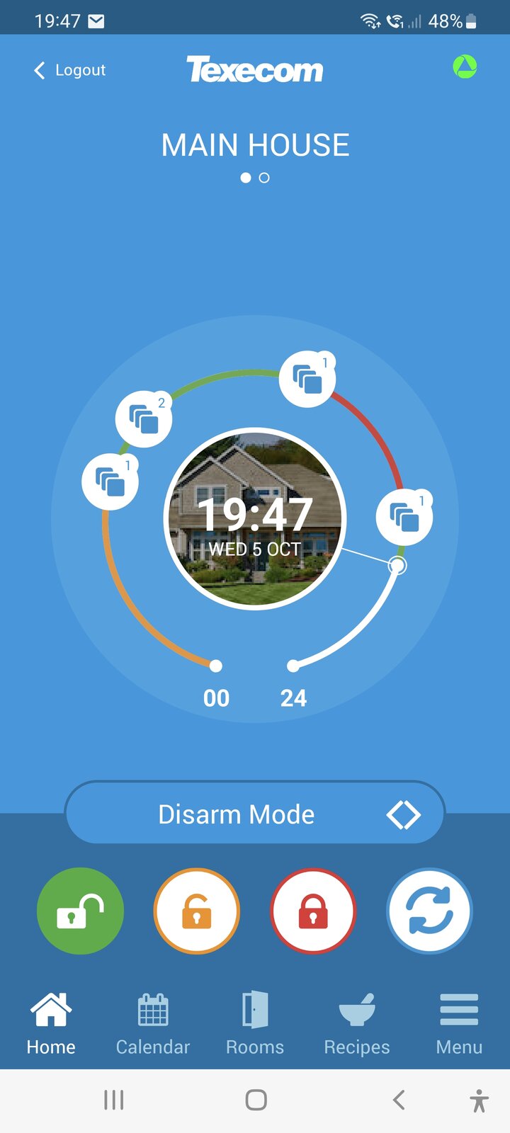

Screenshot as asked for, cheers
Yeah, got area A named as main house and all 3 part sets appear correctly in the app.

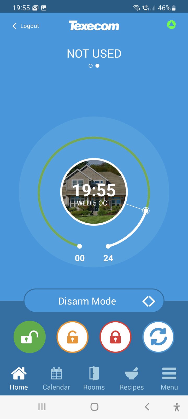

Area B named as 'not used' isn't assigned to any of the zones in Wintex. As you can see, not activity registered on that area at all.

That’s not what I am saying …..from that screen shot of app….the alarm was part armed ( orange ) then disarmed ( green ) then full armed ( red ) ….how was that set on the full arm ? By keypad or app ?
Okay first things first, if you are not using an Area, no text assigned and panel sync the app and it will just have the main house.
