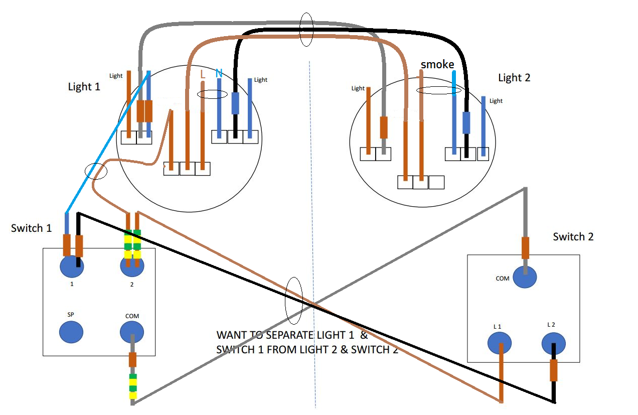

Hi All,
I'm really scratching my head here ! I've got 2 lights in a hallway, which have 2 switches (2 way switching) which operate both lights simultaneously. I want to separate the 2 way switching so each switch operates one light only. And i'm struggling getting my head around the wiring. To complicate things the powered smokes take their permanent feed from the lights too. I've attached some pics and a bit of a schematic. Any ideas how to separate the two; and is it possible given the wires already present ? Really appreciate some ideas please ! Cheers
