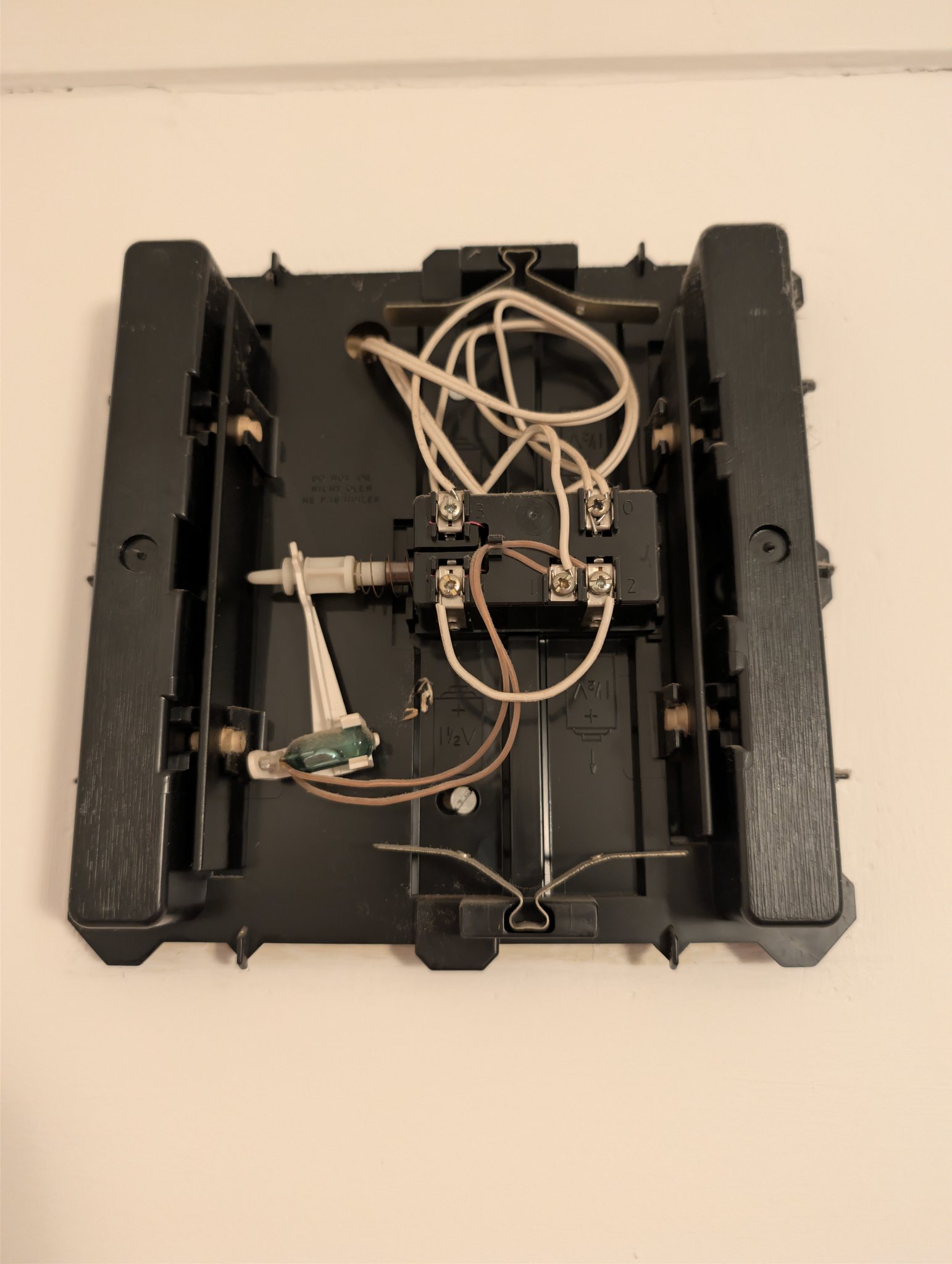

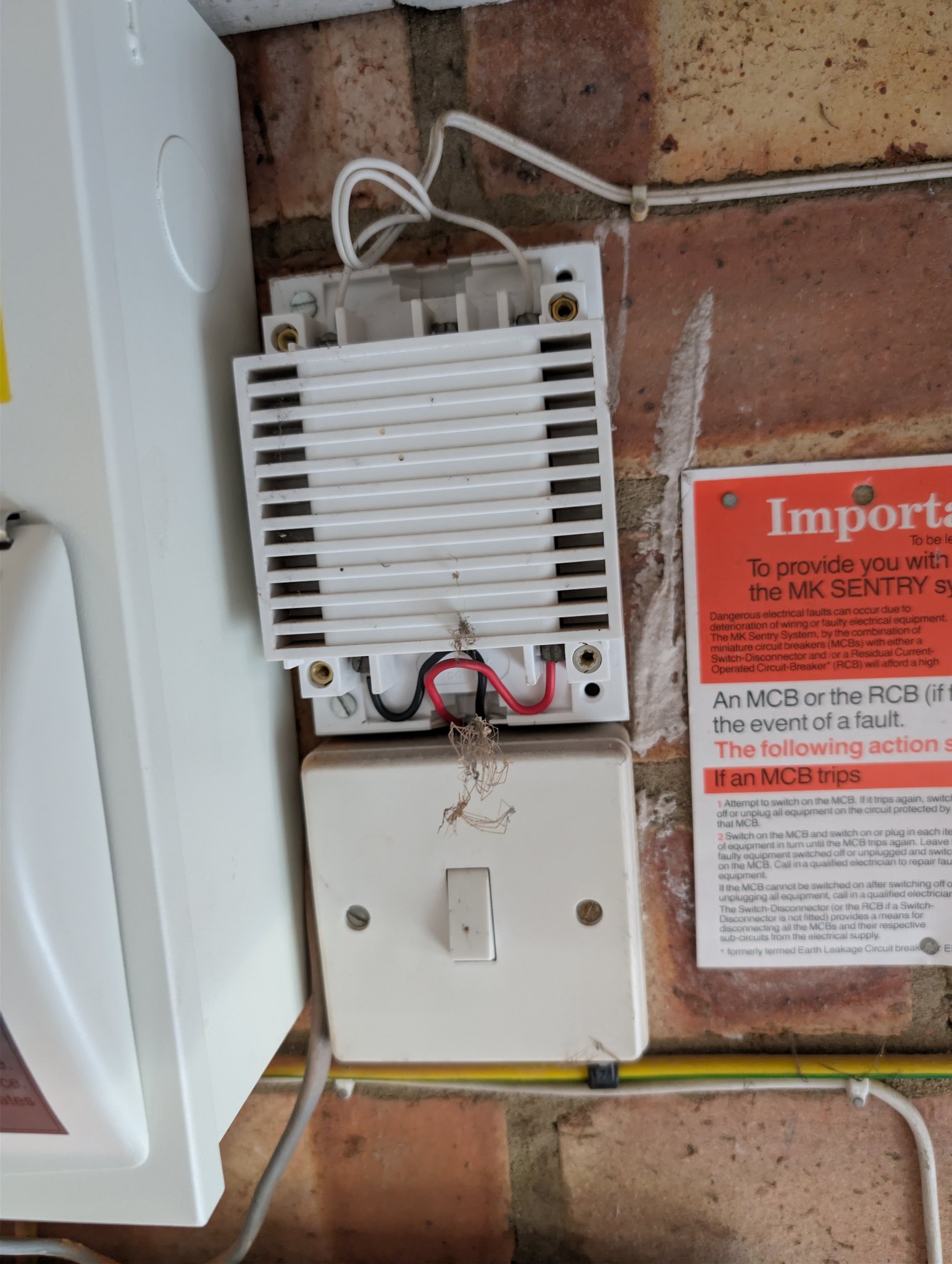

Hey folks, I am replacing an old doorbell transformer in the garage with a new Ring version.
The ring version has output + and - and input L and N
Now, I am assuming, the L and N come from the existing isolation switch underneath existing which is currently in the old transformer. And + and - go to the existing doorbell wire (do the + and - matter on those wires which way round as I know they don't on the doorbell side?)
But the chime is inside the house, I basically want to remove it completely, picture is attached. How can I just permanently bypass / disconnect it, I read up about joining cables but any idea which ones?
Thanks in advance!

You have two pairs, one goes to door push, the other from the power supply, how they are connected depends on the using being fitted to replace it, my old hard-wired doorbell had the door push go to selected terminals as it had a different sound for front and back door. And front door you could select the tune.

What I did was disconnect the chime, pull the cables back through the wall into the garage by the transformer, then just simply connect the doorbell wires to the transformer, as they were long enough, rather than joining the chime wires etc. So chime has gone and new ring din transformer is in, just need the enclosure to finish the job now!
