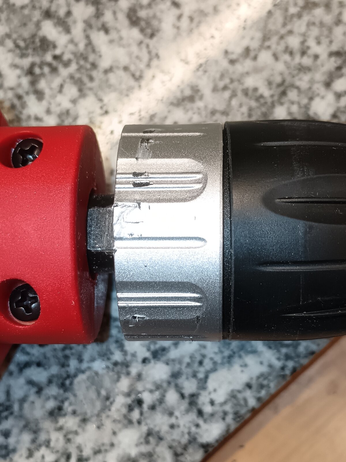

I need to remove the chuck on my drill so it can be fitted to a drill stand. How do i do so?

Drill stands don’t usually require removal of chuck they just clamp above it .?
Make , model?

To remove the older type of chuck, which used a chuck key, the usual method was to insert the key in the hole and tap it with a hammer, in the usual direction of rotation when drilling and if you were lucky, it would unscrew from a very fine thread. I would guess that keyless chuck must do something similar.
Is there a screw inside the chuck? Probably left-hand thread.
Is there a brand name on it, such as Jacobs?
There is a screw... Removed it (left hand thread) and the chuck still won't come off .. Brute force?
That's exactly what i did. Thank you for the tip. Appreciated
