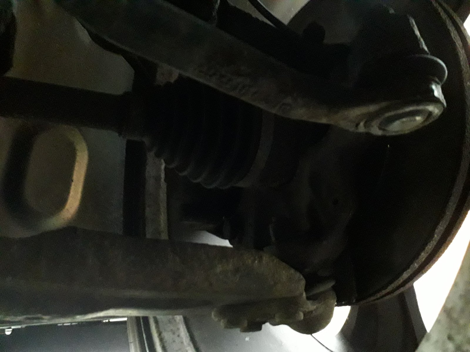

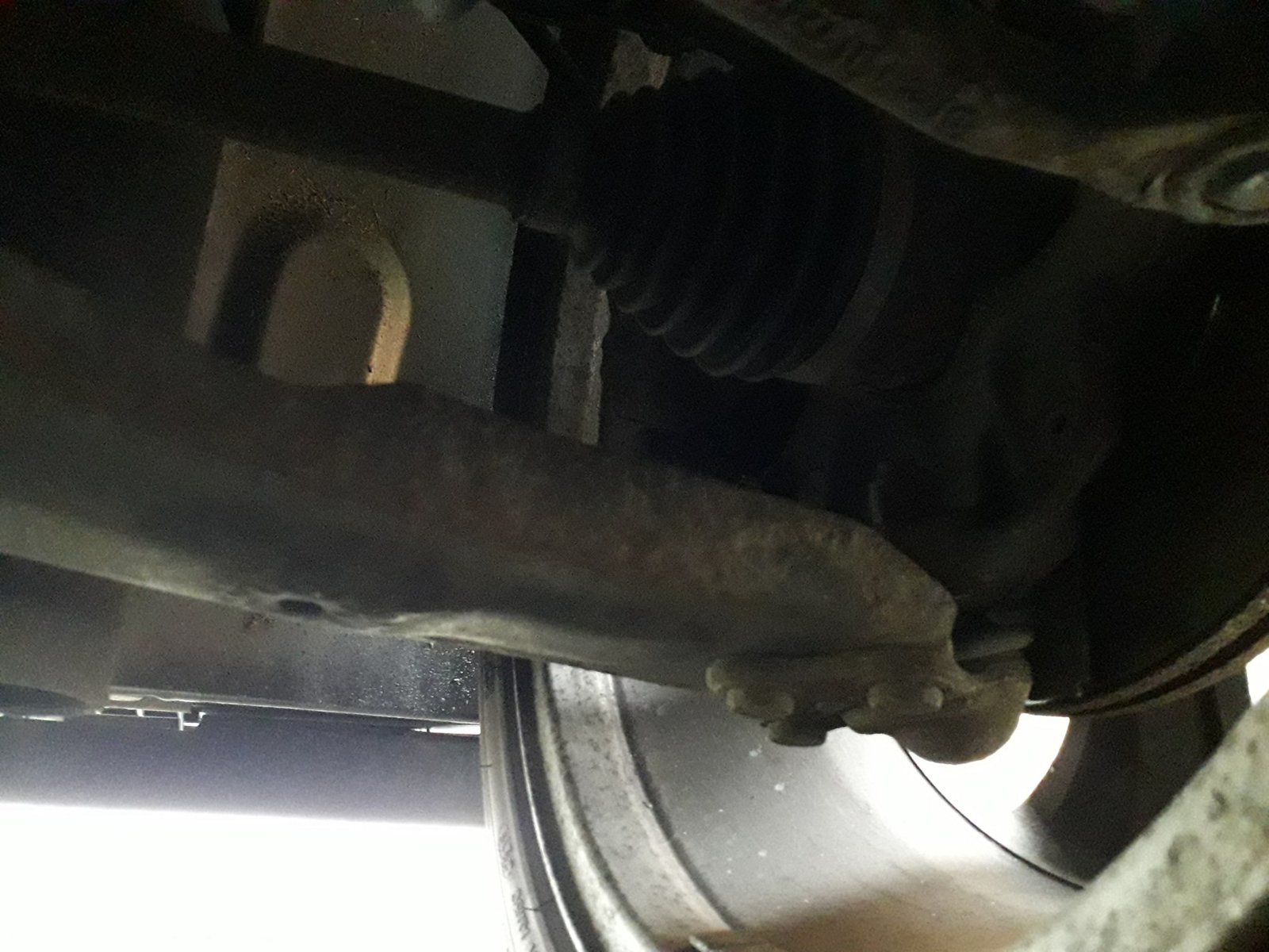

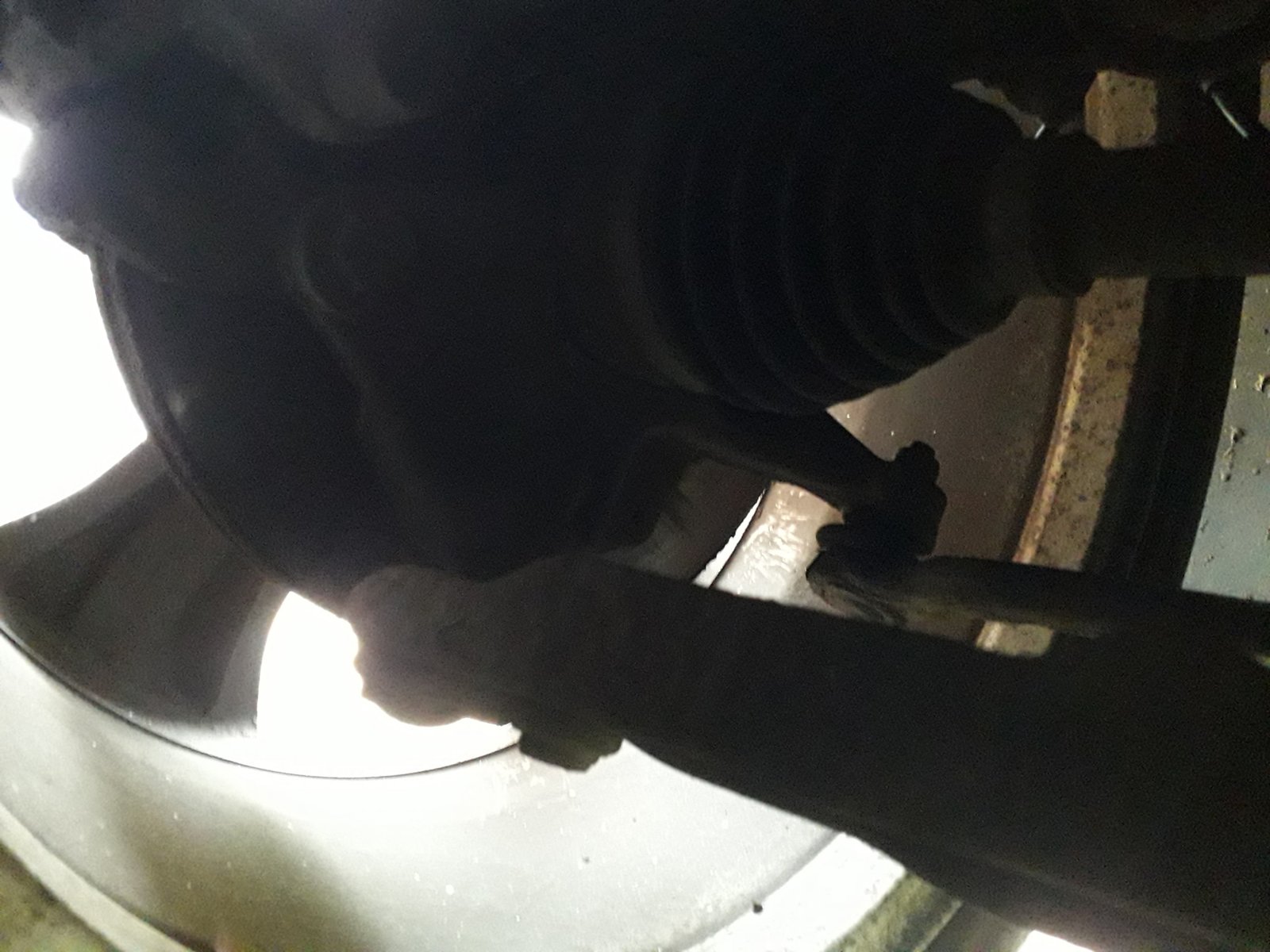

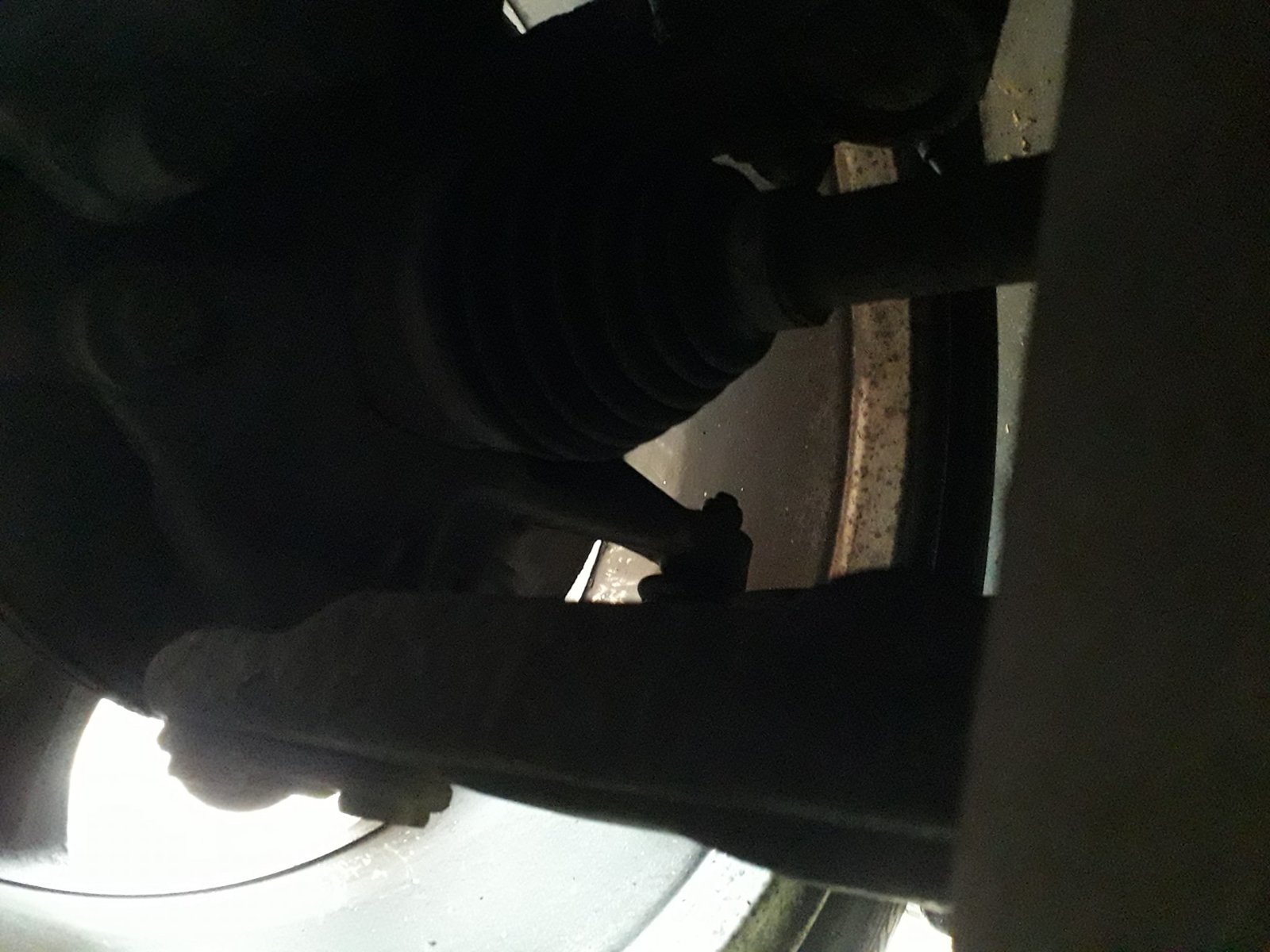

Can anyone tell me if the ball joint is separate as in a cheaper repair or is it part of the wishbone etc and a larger more expensive repair .

I have already done that thx and it shows separate part but what confuses me is the mechanic you ring up looks at the parts on lists like that from your reg so surely they should know . I have included pics in reply above for anyone with a bit of knowledge thanks .
Riveted on ball joint. These can be drilled or ground off. The new joint comes with bolts. About £15 a side. Sometimes though if the wishbone bushes are buggered it’s best to change the whole wishbone. Still only around £30 - £40 each.
