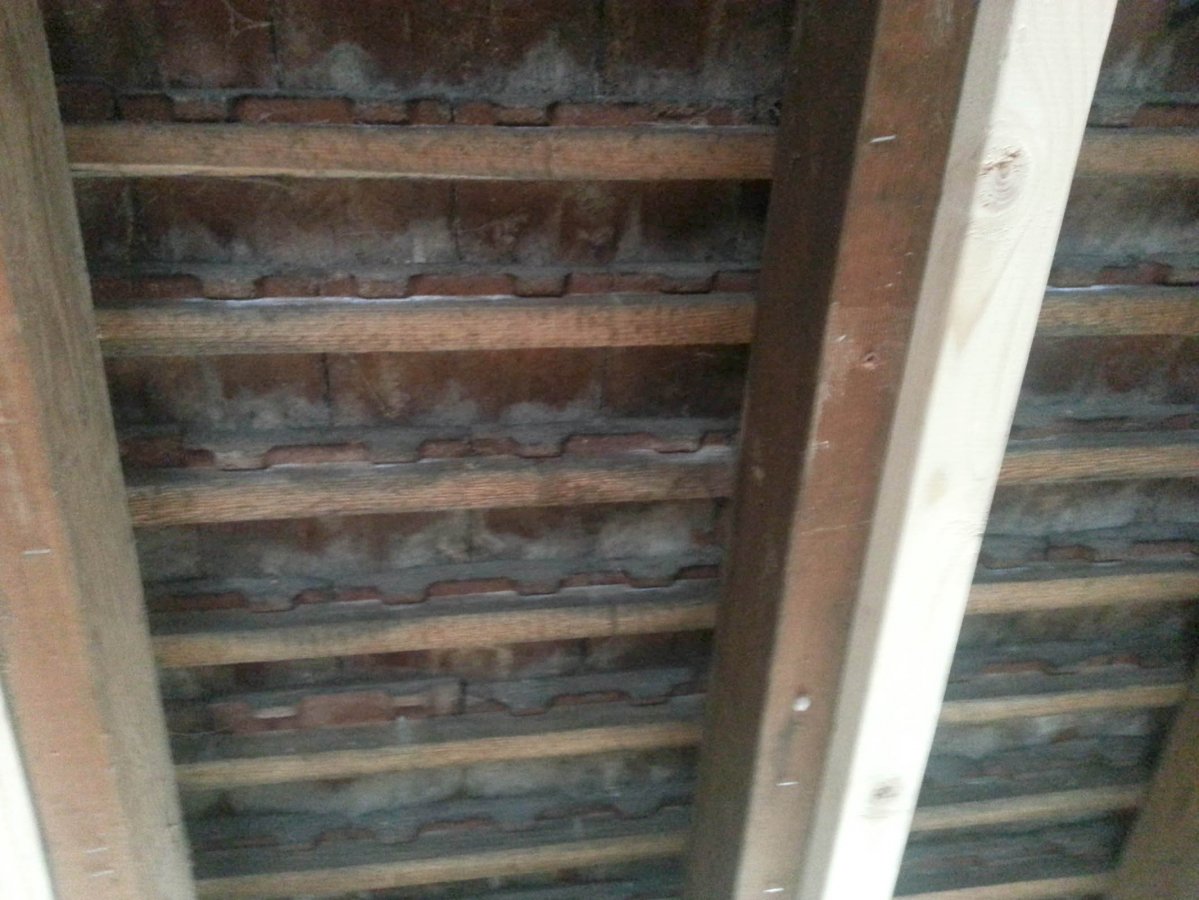

Hi all,
Is it better to re-tile the front roof during a loft conversion? The loft company initially suggested if it isn't broke don't fix it which sounded good to me.
But now the old insulation foil has been removed from the loft and they can see there is no felt under the old tiles, they suggest it might be cheaper in the long run to replace the front tiles and put a breathable water proof layer down first between tiles and rafters.
This makes sense and in an ideal world we would replace the tiles on the front too. The house is 80 years old and the roof has never leaked in the 10 years we have been here, only the flashing round the chimney leaked once and this was fixed with acrylic paint which has lasted 5 years so far.
Its an extra £4k we hadn't budgeted for, £120+vat per m2, outer London prices, and would mean trying to find savings somewhere else.
It looks like around 20% of the neighbouring properties replace the front as well when getting the loft done. Thinking it might be better to just patch the front roof if it ever does leak in the future.
wondered if anyone has any thoughts on this
It really depends on the condition of the tiles and how near to the end of their life they are, as well as your financial constraints, also, I have found that Building Control are often more interested in the condition of the tiles when there is no membrane at all so they may have an opinion. Got some photos? It should be cheaper to do it now and certainly less risk to the loft rooms. But that doesn’t sound exactly cheap but there’s little info to go on. And why would you only replace the front tiles and not the rest?
As Freddy says it depends upon the current state of the roof really and how likely it's going to need replacing in the short to medium term anyway. If you're going to have to do it, then there probably won't be a better time. But I would agree why bother if everything is sound.

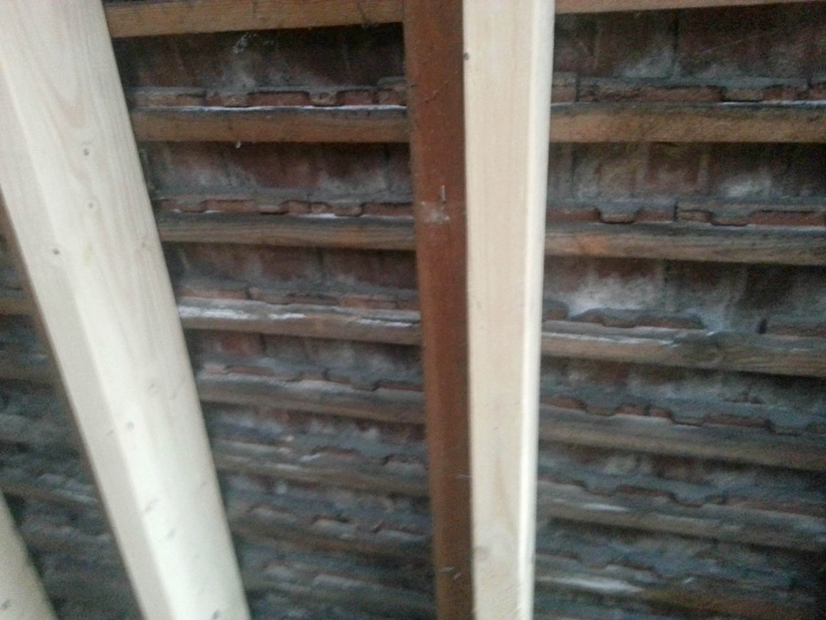

thanks for replies. the builders think the roof could be fine for another 5 years but not longer. When we had the full survey done when buying it nearly 10 years ago, the surveyor said it would probably last another 5 to 10 years. I've included some pictures. The tiles don't seem too bad but the batons look a tad rotten hear and there. I'd like the builders to do it now as they are really good and it makes sense but the price is a lot more than I expected. I wondered what the ball park average was per m2 in outer London, especially if the scaffolding is already there.
yyears.
In light of what you have said, it's a no brainer do it now, the staining on the inner face of the tiles would indicate that they're coming towards the end of their life, you've got men there you trust, you've got the scaffolding and you've got work going on in that area anyway.
£4k seems pretty fair to me, I'm in Oxford and would expect around that figure but would expect scaffold included.
