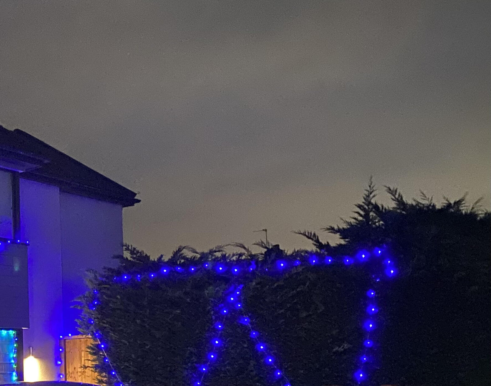

Hi DIYers, I bought outdoor lights a couple of years which has a 10A 220v-240v (50-60Hz) 3-pin plug (picture attached). Product made in China. one of the pin in the plug broke while I was trying to run the lights outside. Can I replace this plug with UK standard 13A (UK plug)?

Wow...I've been using it for 3 years now. Should I stop using it? This is the other end of it. Think I got this from Wish.
it's connected like this
