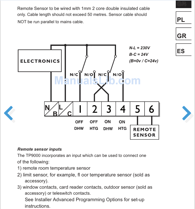

I currently have installed a Danfoss FP715Si (TP9000) 2-channel CH/HW programmer, but the factory-set clock is entirely wrong and it is just getting old. So it is time to replace it with something more modern. Ideally, I would like to be able to replace it with something that can reuse the existing wiring and backplate to save having to install a new backplate and rewire it. So, my first question is are there any new models that would fit the existing back plate and wiring configuration? I believe the wiring configuration is:

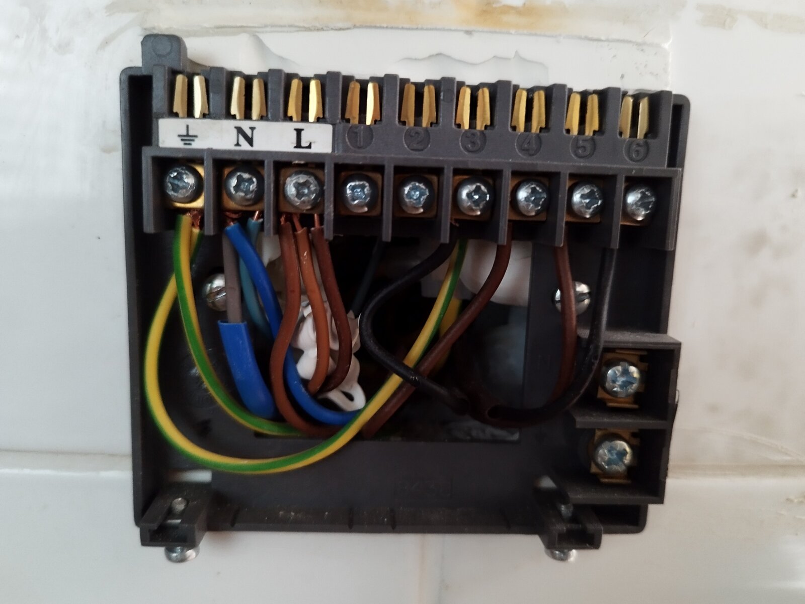

This is a picture of my actual backplate and existing wiring configuration.
Earth, neutral and live is fairly self-explanatory. Am I correct in thinking that the following applies?
3. HW off
4. CH off
5. HW on
6. CH on
If not what would be correct?
