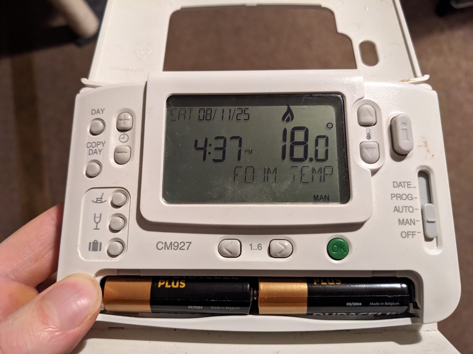

Hi, I have a Honeywell CM927 thermostat that's at least a decade old. Some of the buttons are starting to only work intermittently, so I'm looking to buy a replacement. I can see a few models online that claim to be a replacement for the CM927, but they all seem to come with a receiver.

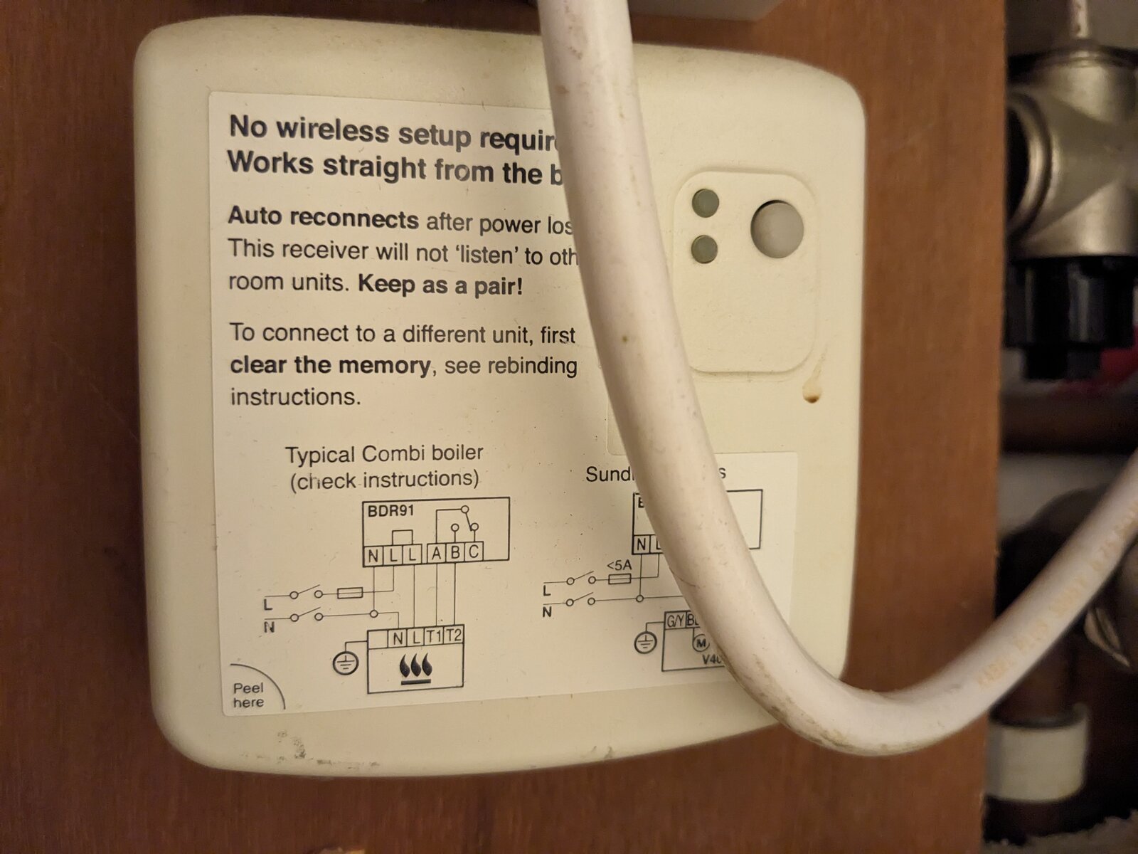

Is it possible to buy a thermostat that comes on its own and is compatible with the old receiver? I'd rather do that than pay extra for a new receiver and then have to pay someone to wire it up to the boiler. I'm not sure what model the old receiver is, but I've attached a picture of it (and one of the thermostat itself). The boiler is a Glowworm Ultracom2 30cxi if that's relevant.

You wouldn’t need someone to wire up the boiler as the wiring is there, so just change over. If you wanted straight swap have a look at Honeywell T2R which comes with the same receiver, but unclip existing and just utilise the backplate
