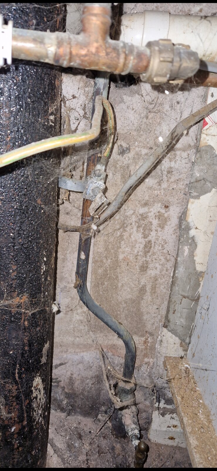

Show us a pic of internal stopcock.
The stopcock is only slightly reducing the water flow coming into the house.

The stopcock is at the back of a cupboard switch has a removable back in it. Looks like it's embedded in concrete.

I did contemplate taking the valve out but knowing my luck it'll disintegrate and I'll not get it back together.
Yes ,or in a more convenient place above it ,and before any branches,if there is such a place.
