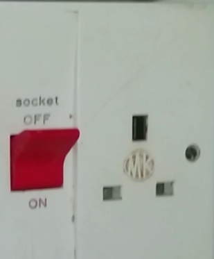

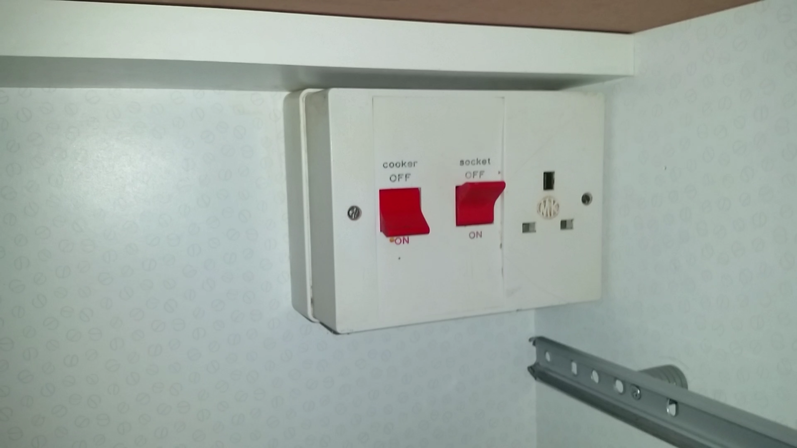

Oh I see what you mean. I don't think so, there's a socket on the switch so it'd just go into there if it had a plug on it; you'd presume! I suppose there could be a socket hidden behind the cupboard but it seems unlikely. The wire comes out of the oven and exits the back of the cupboard right next to the switch in the cupboard next door, so I expect it's wired straight in. Presume that's ok?
Actually, .....
Can't see anything connected to the switch.
Are you planning to use the existing cable, and just connect it to the new oven?
They're there, just behind it

it'd be easier to use the same one, but if I buy a higher wattage/amperage oven than is currently in there, would it need replacing? Presumably the one that's in there now probably came with the oven and so matches it's rating? Maybe!?
The chances are vanishingly small.
To do due diligence, what size is it?
It probably didn't.
You mean the thickness of the cable? I'll have to measure it tonight. I did look at the cable to see if it had information stamped into it but I couldn't find any. I was balancing the oven on my knees at the time though, so I could've missed it!
