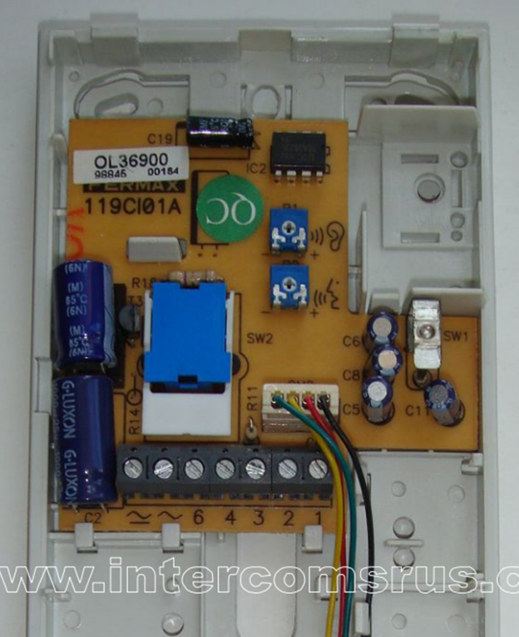

HI,
I have been told to replace my phone with the Fermax 3399 Universal handset
I have found a photo of the internal setup of the new phone.
Looking at my current setup (I included a picture in my initial post) I have 6 wires in connectors numbered 1,2,3,4,5,6
I am assuming I put the wires in the same numbered connector.
I do notice there is no number 5. Where would this brown wire go and is my assumption correct?
Probably, but check the descriptions of each terminal on that intercomsrus page and see if the descriptions agree.
Good question. I note that terminal 5 is not described at all on the intercomsrus page for the old handset. Maybe it's not needed?
Try with it unconnected and see what happens.
*** The picture you've posted is of the 8091, not the 3399.
HI,
Apologies you are correct I did find the wrong picture
The 3399 also only has 1,2,3,4,6.
I guess I will try and hope it works.
Just an update. I replaced my phone with a Fermax 3399 based on the recommendation from the link below based on my original phone model.
http://www.intercomsrus.com/intercom_handset_finder_tool.htm
I matched the wiring numbers on my original phone to the wiring numbers on the new phone.
There were 2 switched and by trying a few combinations I was able to get everything working.
Thanks to everyone who provided advice.

quick question from an old thread. I am in the same situation as you were a few years ago; replacing my Fermax 0208 that doesn't work anymore. I gather that your Fermax 3399 works but can't find out what you did with the No5 cable. You mentioned you had a No5 cable but the 3399 doesn't have space for it. Did you just leave it disconnected? Also, do you know which two cables were switched?
Andy
It doesn’t require it as it’s a 4 plus 1 system .....4 common plus 1 call wire
