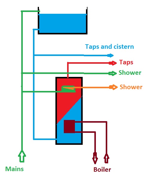

even though the stored Hot water never comes out of a hot water tap,
With a bit of thought it can be arranged for it to supply taps from the "stored" hot water....
