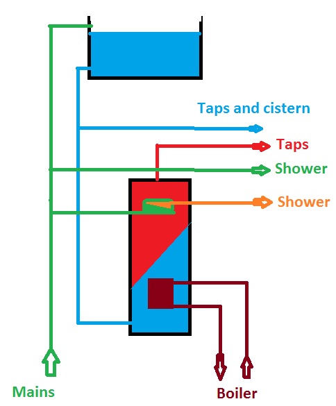

The green / orange "box" in the top of the cylinder is a "coil" with a large surface area.
bernardgreen, apologies, well it does not look like a coil. Neat. Did you have this custom made? I remember seeing these for sale a long time ago. What is the performance of the shower? Can it do two showers? What temperature do you need the cylinder set to?
yes it was custom made, it is actually 4 coils of 10 mm in parallel to get a larger surface area. It probably could do two showers at the same time. ( It was necessary to restrict the flow as full bore was a bit too much for the shower tray ). Temperature hasn't been measured

Bernardgreen, Neat. What temperature do you set the cylinder at? Does it need a thermostat blending valve? on the shower and/or the normal hot water pipe from the cylinder?

It is not a sludge bucket, flow and return do connect to the coil in the bottom of the cylinder to heat the water.

Really BG??? Your details doesn't show it fella, but hey what's new - just a normal consultant, miss half the details from the drawings & leave the installer to guess the design!
If I was putting the design out to an installer than there would be a full set of drawings and not just a rough sketch. That said I woud have expected an expert in heating to have been able to interpret that sketch using his or her experience and knowledge.
