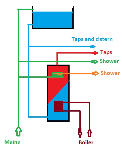

bernardgreen, you gave a picture of an old tank and cylinder setup. That is like going from a proper, safe, economical real car with electronic management to a Morris 1000. I would not like to drive a Morris 1000 around fast roads and motorways all day. Dangerous.
It is actually 5 years old, installed in May 2011 and working well, ( can even have a shower during a power cut ). That said there is room for some improvement in the design of the upper coil to reduce the volume of copper inside the tank ( hence more water storage volume ) and improve the flow of cooled water to the bottom of the cylinder ( possibly an external coil wrapped around the cylinder ),

bernardgreen, you have an old setup that needs one of those awful, noisy, leaky, power shower pumps to avoid running around the shower to get wet. :)
