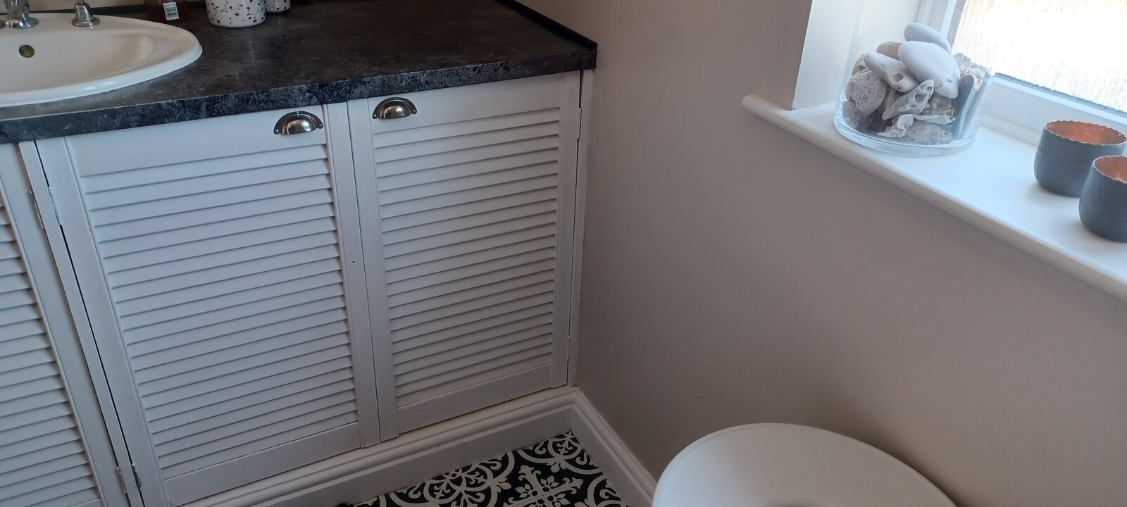

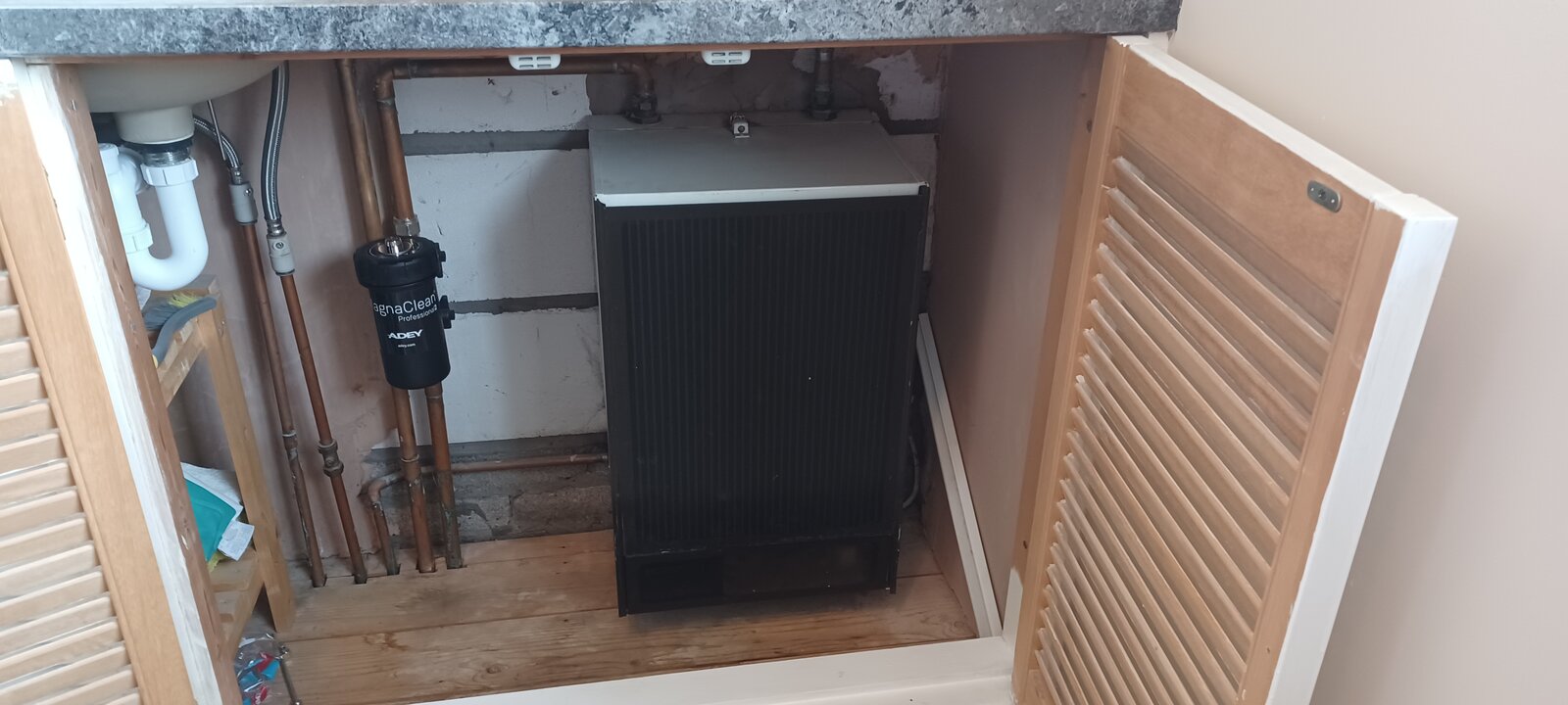

At some point my old Stelrad Ideal Elan is likely to need replacing.
We have been here 21 years and it was here when we moved in. New gas valve about 15 years ago.
Is it worth replacing for better efficiency? It works fine.
In the last year or 2, I have removed and flushed all the rads. Ran some X400 for a few weeks and fitted a magnetic filter.
Temp is either low or high. No adjustment. Run it on low most of the time. Only high when very cold out.
Hot water via a Fortic cylinder in the loft. Hot water flow is OK but not great.
It is located in a cupboard in our en-suite
The guy who replaced the valve had a bit of a moan that he had to lie down :)
Could a replacement go into the same place? Pump and 3 way valve in the main bathroom.

yes no reason why you couldnt get a replacement to fit in thesame place, but if its working and is ok I wouldnt be in any rush, poor baby having to lay on the floor to change thegas valve

You have to think new boiler will more than likely have a magnetic filter. It might be a tight squeeze

If you do go for a combi boiler, that space may not be sufficient if top flued and need for bottom maintenance clearance
It might be prudent to get the boiler serviced as per makers manual
It is not unknown for the heat exchanger to fail where the pipe is attached to the heat exchanger
The heat exchanger matrix often blocks up where the water enters the heat exchanger ( condensation related).
This should be cleared else efficiency will diminish
