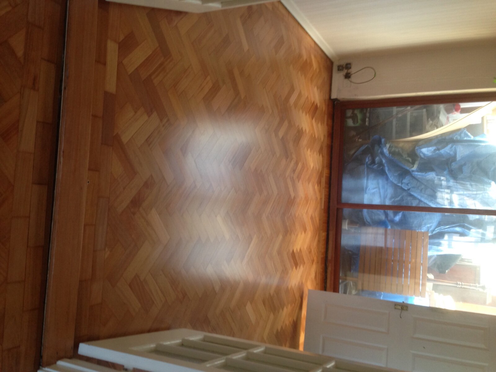

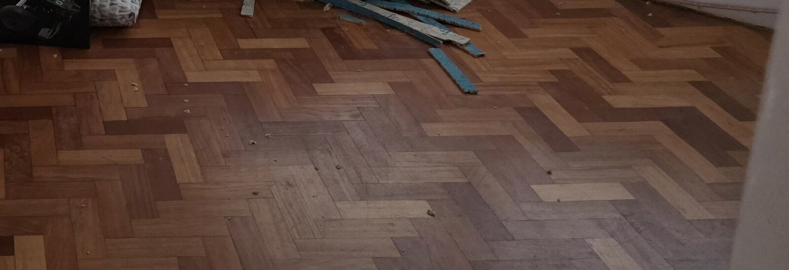

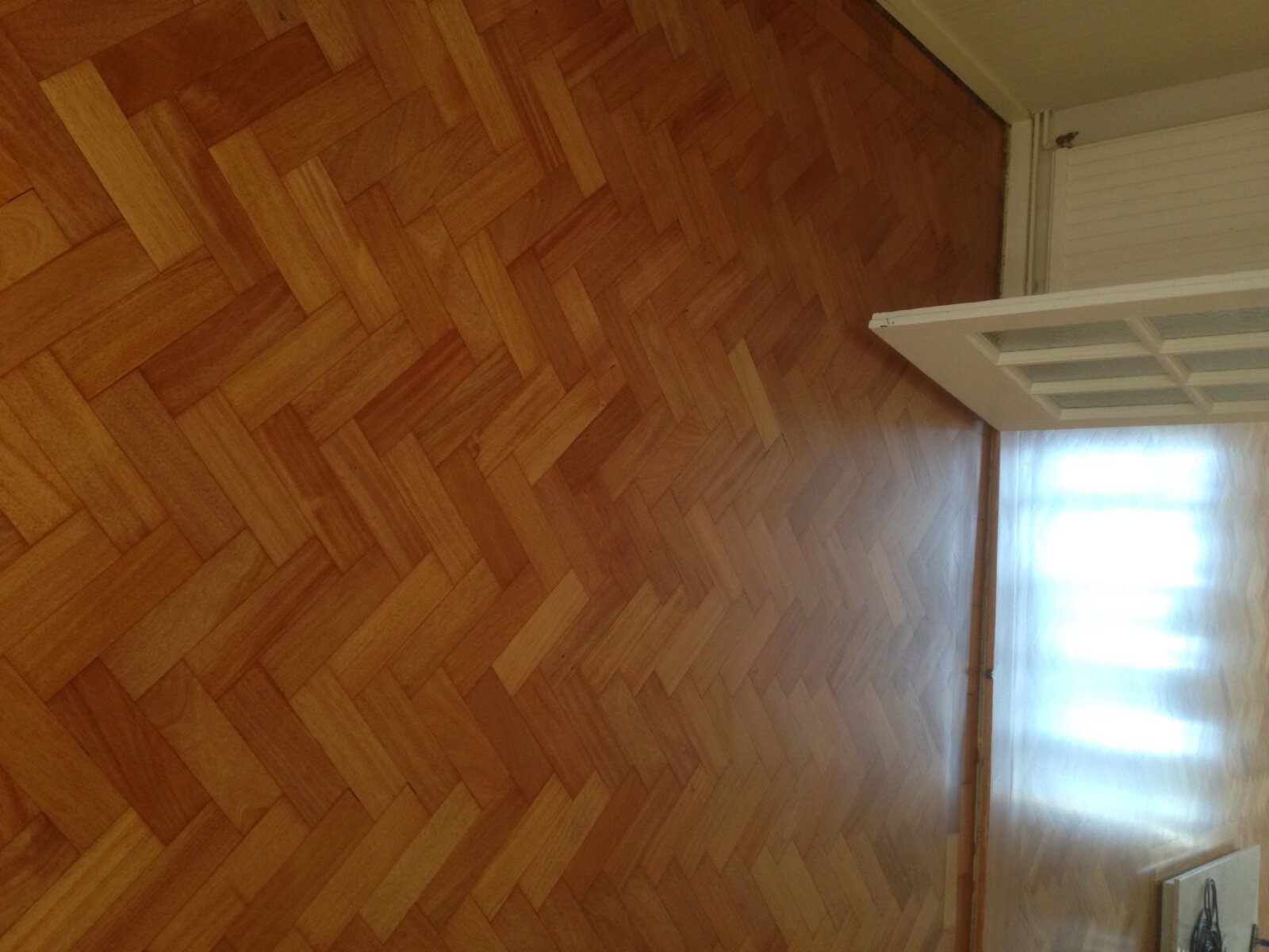

I have parquet in my through lounge and hallway.
OMG you need a new wife not a new floor :LOL: that floor would cost you a fortune to put down and herring bone is a big trend right now. Sand back and re do with a clear hard wax oil and it will all look a lot lighter and cleaner and fresher and last forever.
