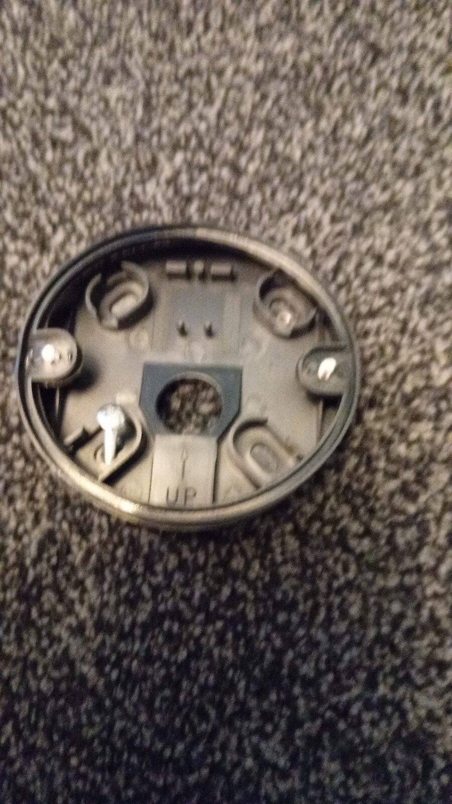

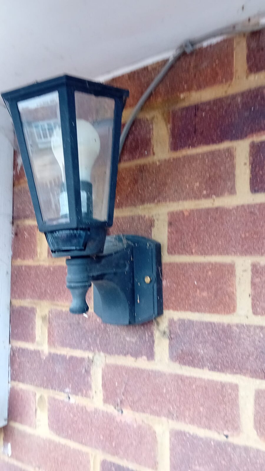

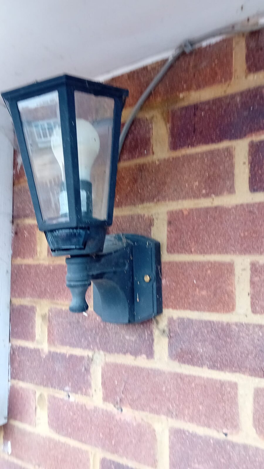

Replacing one of these lights for my brother.
The new light appears to be a similar size and design.
I’m not happy with that T&E cable and wondering what I can do to make it tidier and safer. I am assuming - will check- that it’s the switch cable.
He won’t want me to start cutting holes into walls and ceilings inside to conceal the cable.
Wondering if there is a type of conduit or something else that is suited for this situation?
Thanks in advance.
T&E cable is really not designed for use outdoors due to UV effects, But its there now, maybe some sort of cable conduit is needed.
There are many options to make it better but need to see the light that you are fitting to give you the best guidance.

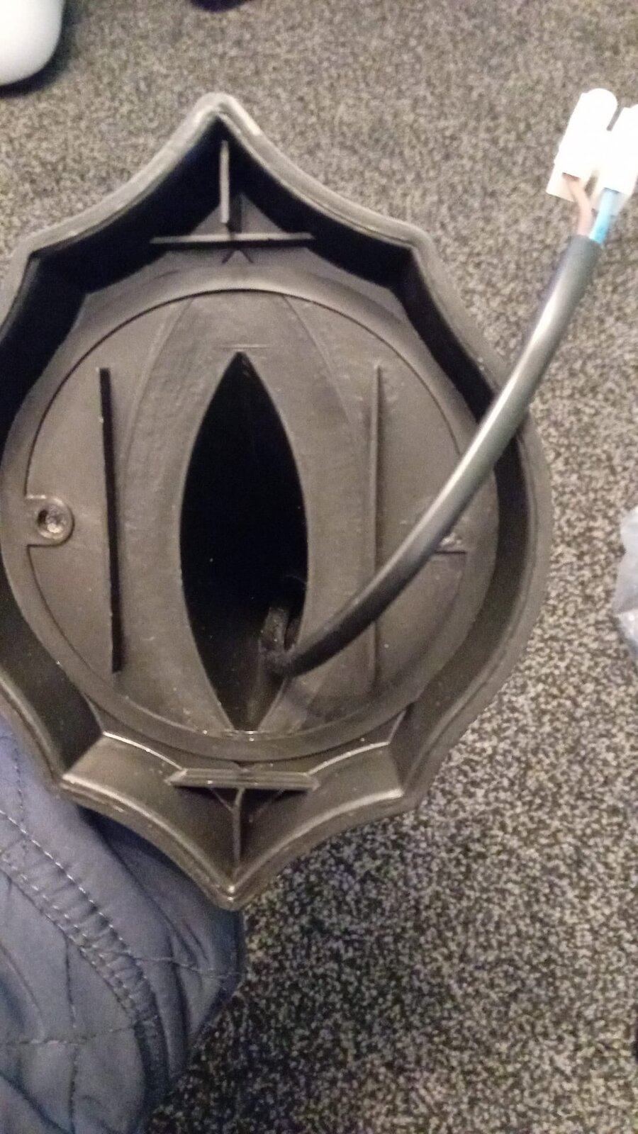

It’s ostensibly the same light; a lantern. I only have these pictures of its base.
I was thinking about using conduit but weren’t sure about the detail where it reaches the light.

make a join in the PVC trunking.
Am I okay to use the push-in connectors for this, given that they will be within this trunking?
Also, would you opt for white or black trunking in this situation?
Thanks for your help
The joint will be accessible so anything that will fit will be fine. Those Ideal in line connectors you can get from ScrewFarce would be OK.

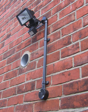

Came across this image and was torn on the black v white:
As you know, the light fitting is black.
Ask your bruv then. He’s going to see if every time he comes home! But you don’t need a chunky bit of 20mm conduit for one bit of lighting cable.
The single cable to this light is likely to be a permanent live. Not a switched live as I initially suspected. There is no switch for this light.
When I installed PIR lights as my own place, I opted for a switch and then had a single switch live going out to the light. This also meant that I could override the PIR operation using the switch.
I will investigate further when on-site and carry out safe isolation before I switch it over but wanted to check if this method of install has any issues that I haven't considered. I might be able to add a switch but it will add to what was suppose to be a simple job (and favour!).
Every job is a voyage of discovery. Its difficult enough to carry out detective work via a keyboard. The only way to be sure is to go to site, with the appropriate test kit, and use your expertise to engineer a solution.

Understood and I plan to investigate further. If I do establish that it only has a permanent live, does that present any issues? Other than the usability that I stated earlier. Is this an allowable solution?
