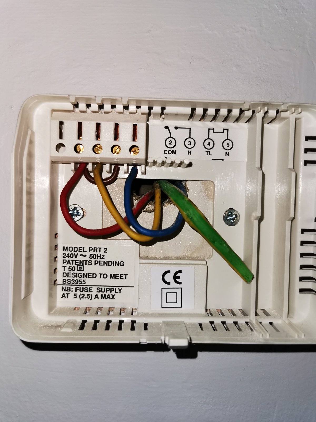

Hi could anybody help I've got a old potterton prt2 room thermostat and want to replace it with a
HONEYWELL T6360B-1036 or a modern new thermostat just wondering which wires go where to the new thermostat this is a pic of my old one any help much appreciated

Red is live
Yellow call for heat.
Blue neutral
a hive would be ok there.

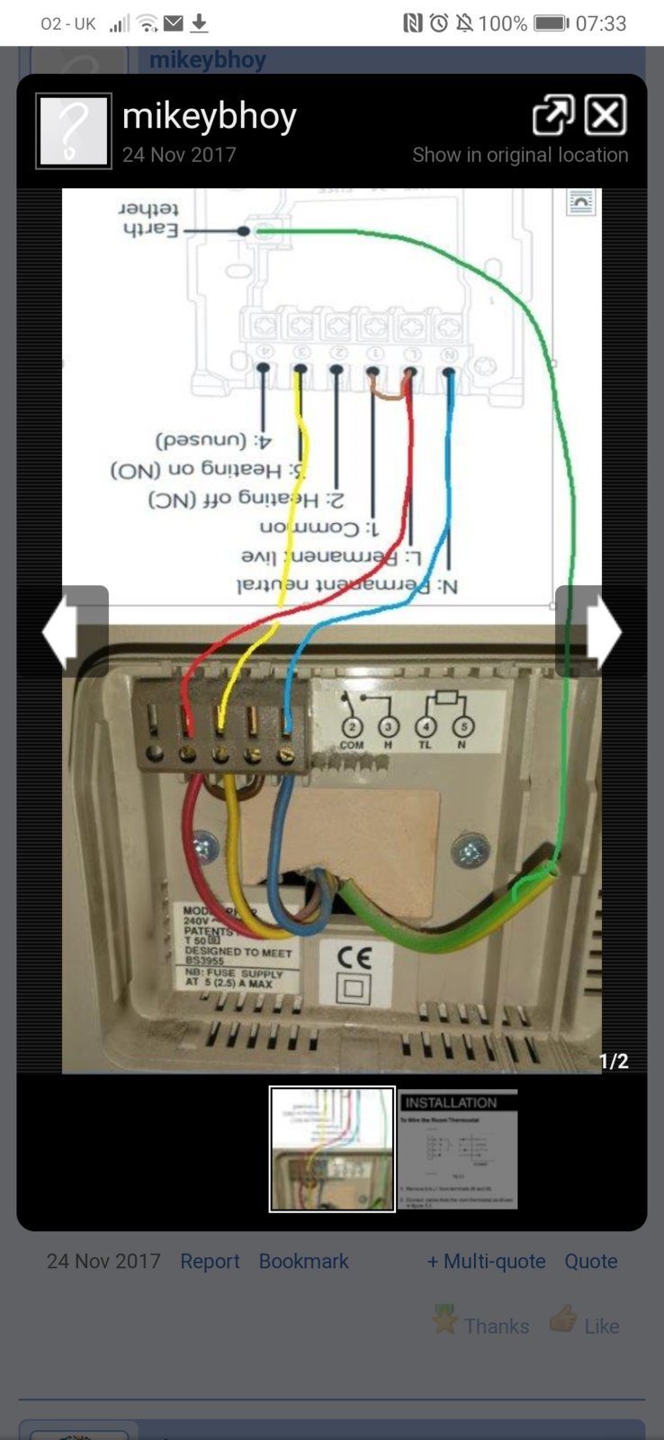

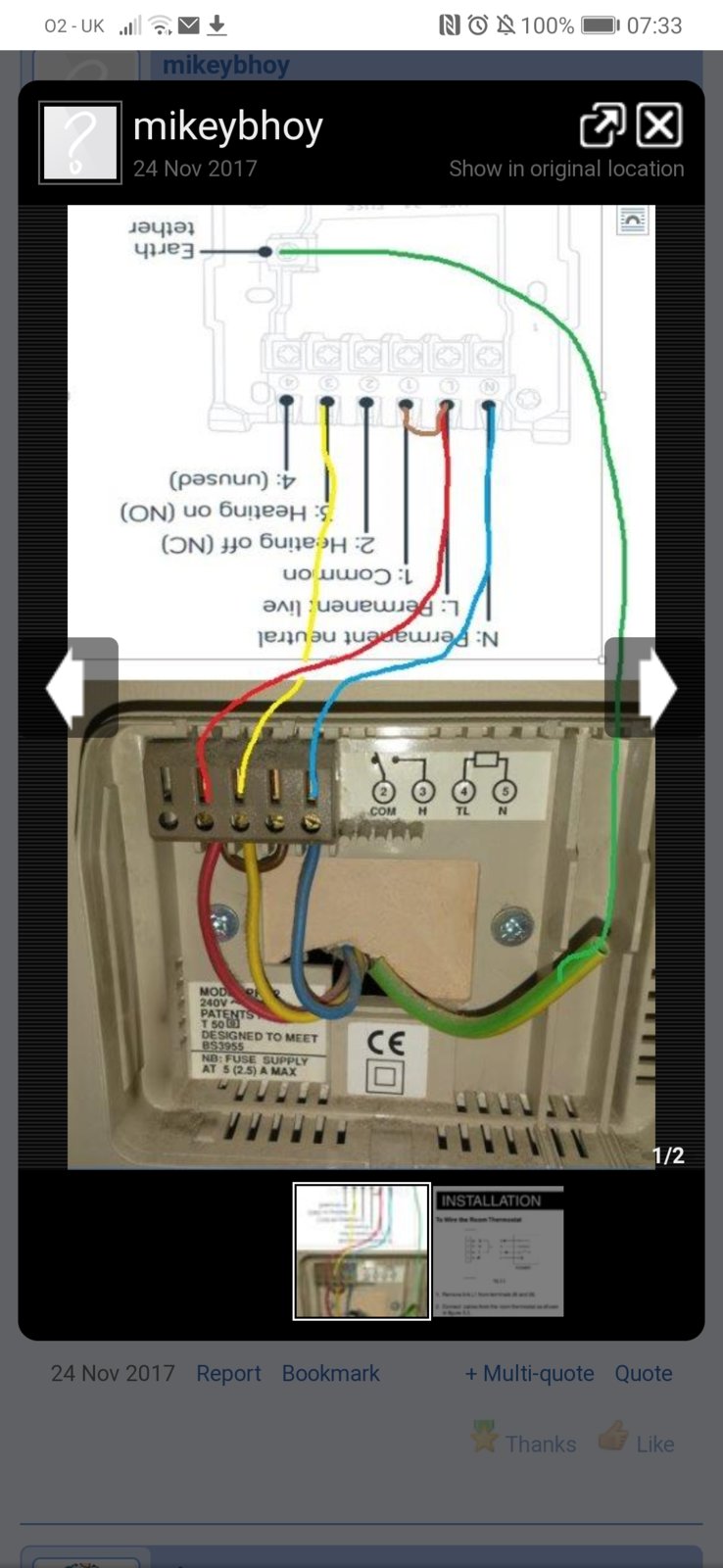

With the hive would I just wire the receiver upto the room thermostat then put the wireless thermostat controller next to it or does it have to get wired up to the program timer would it wire up like this
If the hive has hot water control and you want it to. It needs connecting at the timer (or instead of timer)
Otherwise do at you say
Most of the modern smart thermostats learn, it is unlikely they can learn when being switched off all the time with the timer, so a cheap thermostat will likely work just as well, the Flomasta 22199SX will likely do the job for you with added bonus it is programmable so switches heat up/down rather than on/off. You would only use red and yellow wires, the blue just fold over and tape up.
The Hive / Nest / Other replaces the existing programmer, and the wiring to the thermostat is linked out or ideally disconnected at the wiring box and a link installed instead.
It's not just replacing the thermostat.
