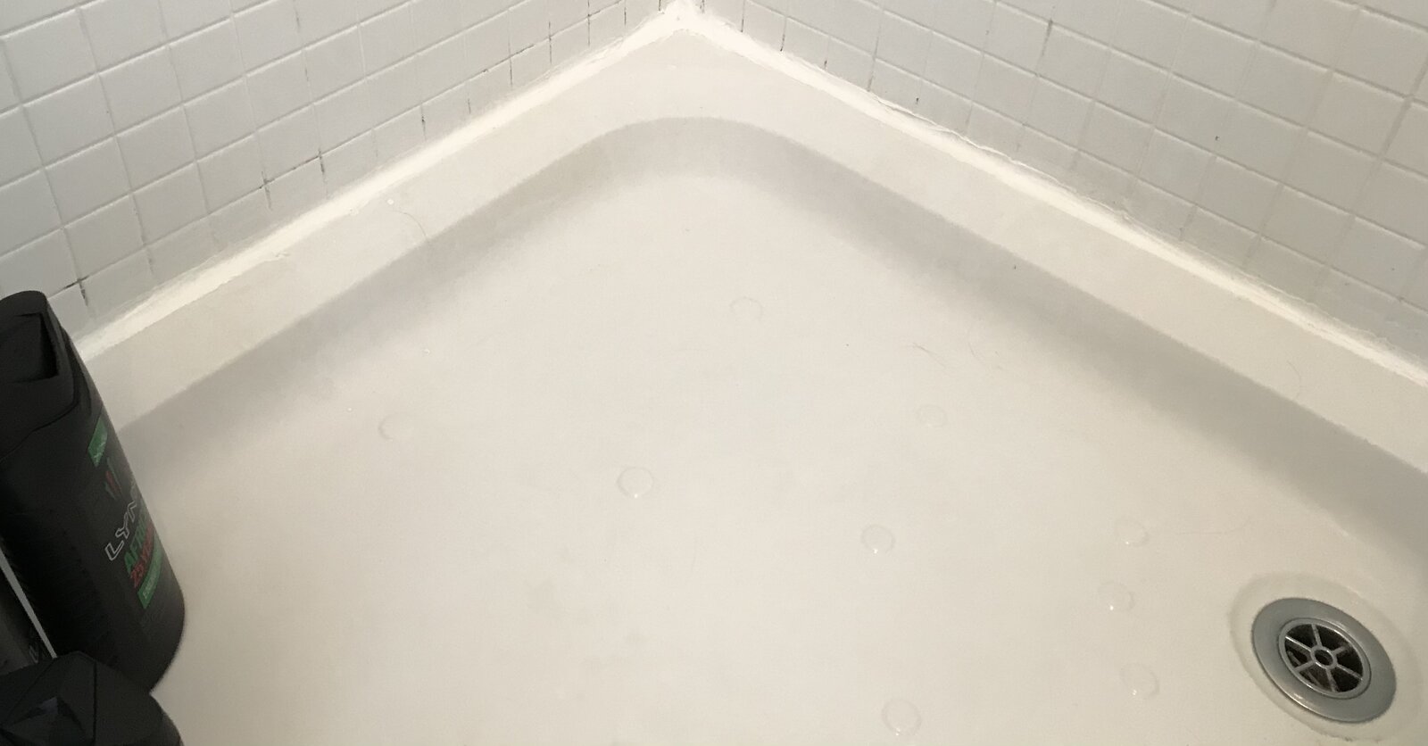

Hi I’ve had a tradesman come round to replace the silicone sealant around the base of the shower which is about 120cm. He says it will take quite a long time to do (1-2hrs) because it’s always hard to remove the old seal. Is that correct? I thought it would have come off quite easily so just wanted to make sure that’s correct before he comes. Thank you
Could you post a picture Hayley please
This is the strip that needs replacing
Depends on a few things, how degraded the old silicone is, how thick the line of it is and the surfaces that its attached to, it can be either a really quick easy job or an absolute nightmare.
A couple of hours is a long time but if it comes off in 5mm sections instead of getting a wedge of it out & pulling huge chunks off at once it could take that long, if both edges are smooth/sealed surfaces it should just come out with a bit of scoring from a knife & be out in 5 mins.

done several bathrooms / showers over the years. Quickest I've done it is around 2 hours - mainly cause the silicon has been left to fester for years.
I'd reckon 2-4 hours to remove and treat with 'silicon eater' and clean up. Needs to be allowed to dry before new is applied.
Need anything from 30 mins to an hour to renew, tool/finish and clean up. Then a couple of hours (or better still, ovenight) to cure.
I'd say he's right. Can take over an hour to remove old stuff.
Yes you're right sometimes it can be a real pain getting it all off, even when using silicone removing fluid.
