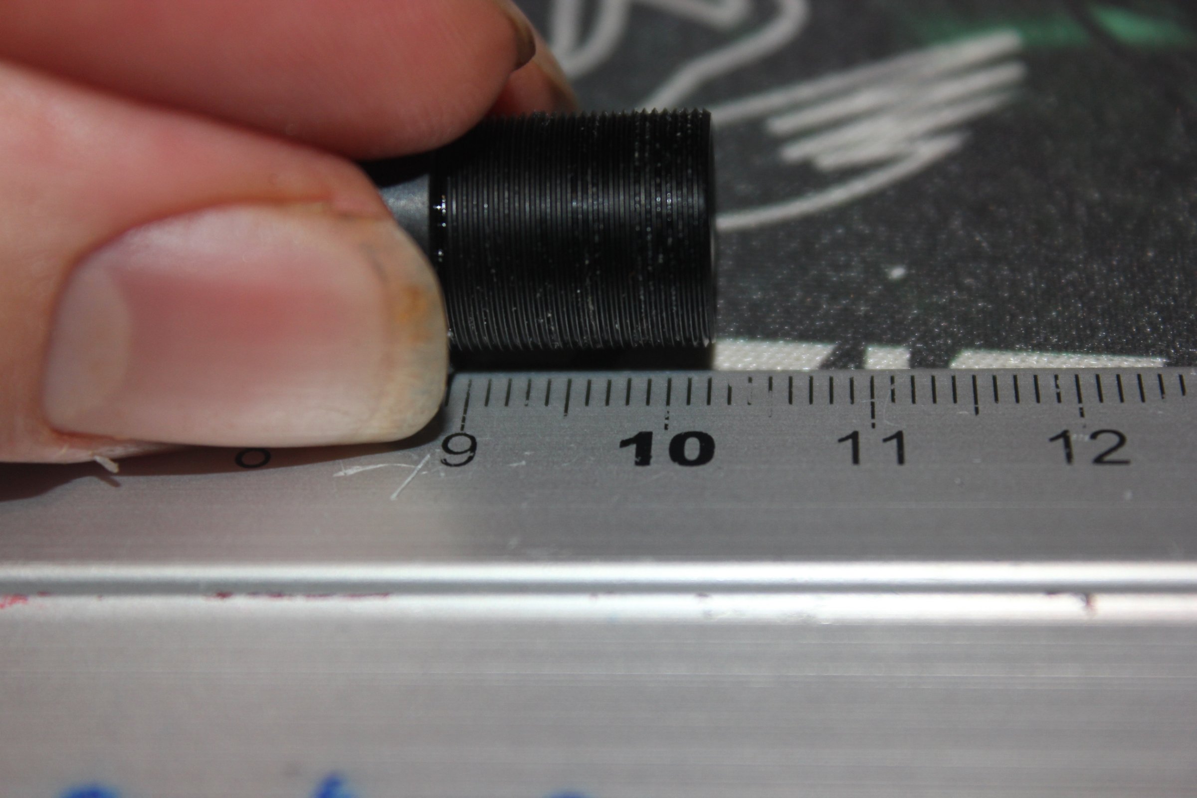

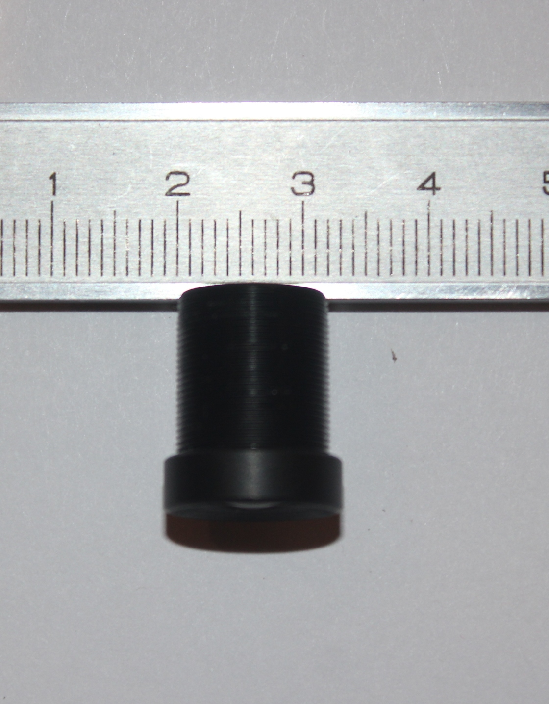

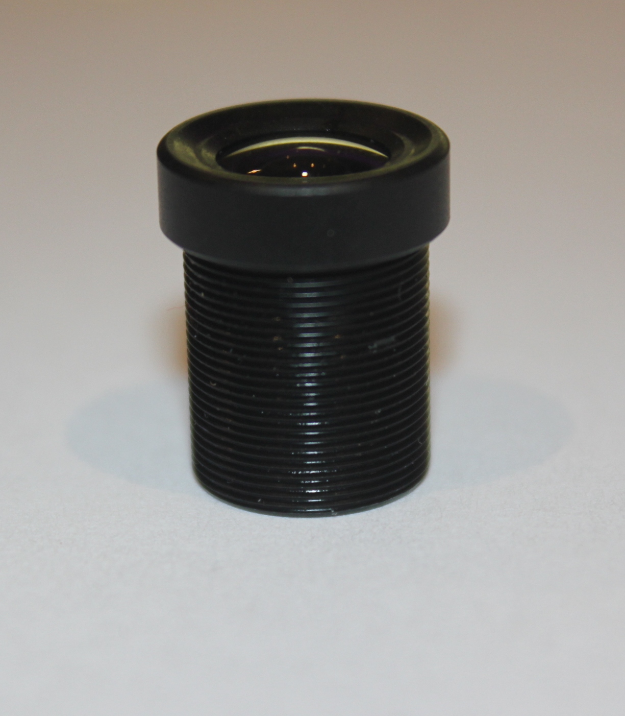

Will post side by side comparison shots when the new lens comes, For now some pictures of the existing lens:

Big question ....is the lens
A ... A megapixel lens
B ... Ir corrected
C ... The correct format
Best of luck
A: Not sure, but the FI9853EP is a 720P cam.
The cam has a 1/4" CMOS sensor according to the link below, and the lens I have bought is designed for a 1/3" sensor according to DX.com
https://www.pollin.de/shop/downloads/D723694D.PDF
B: Dont think so, hope not anyway as the IR cut filter is between the sensor and the removable lens.
C: Size wise, I think so. Focal length of both lenses is the same as mentioned. Otherwise, will just have to check when new lens arrives.

Well I went for a 170° lens, but it had a focal distance of 1mm instead of 2mm. Thought no problem, can just screw it in further. Well I screwed it in to much and broke the IR cut lenses so had to replace the IR cut assembly as well.

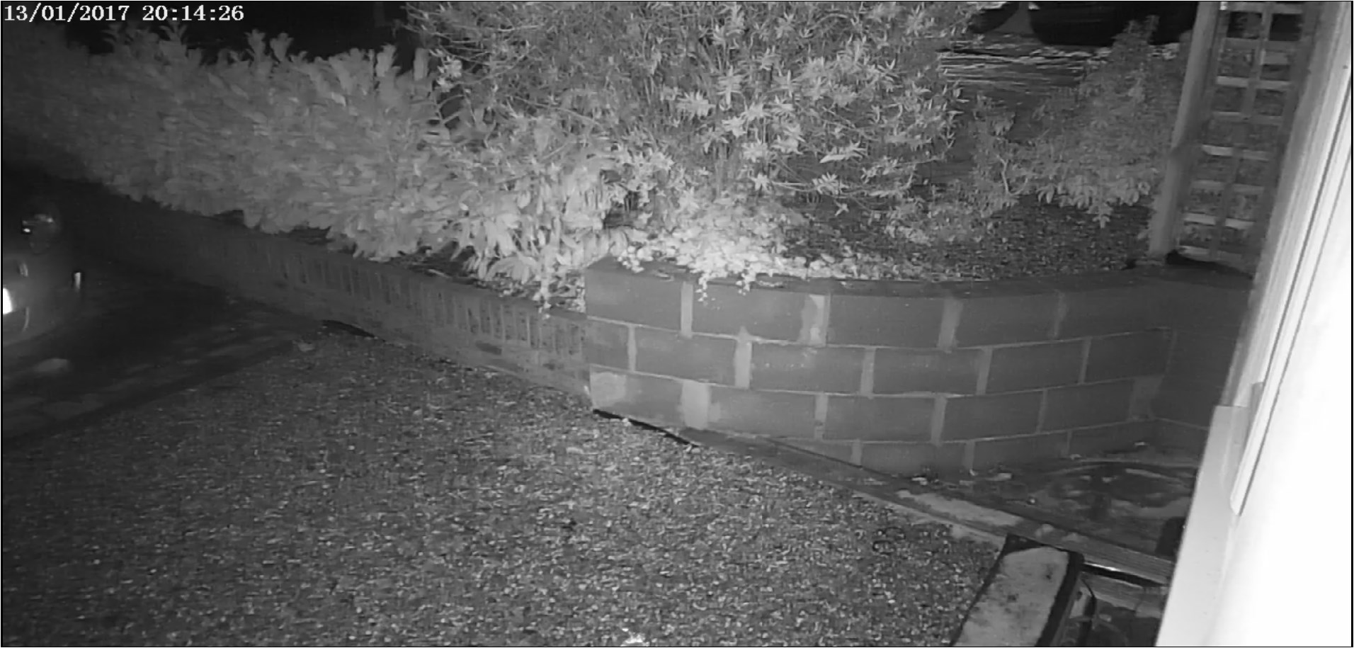

Using the above linked 115° lens now what gives a field of view of 86.25° due to the Foscam having a 1/4" sensor. (The lens is designed for a 1/3" sensor what is 1.33 x larger.) So far all good, although can't say the increased field of view is that noticeable.
This is the night time view:
