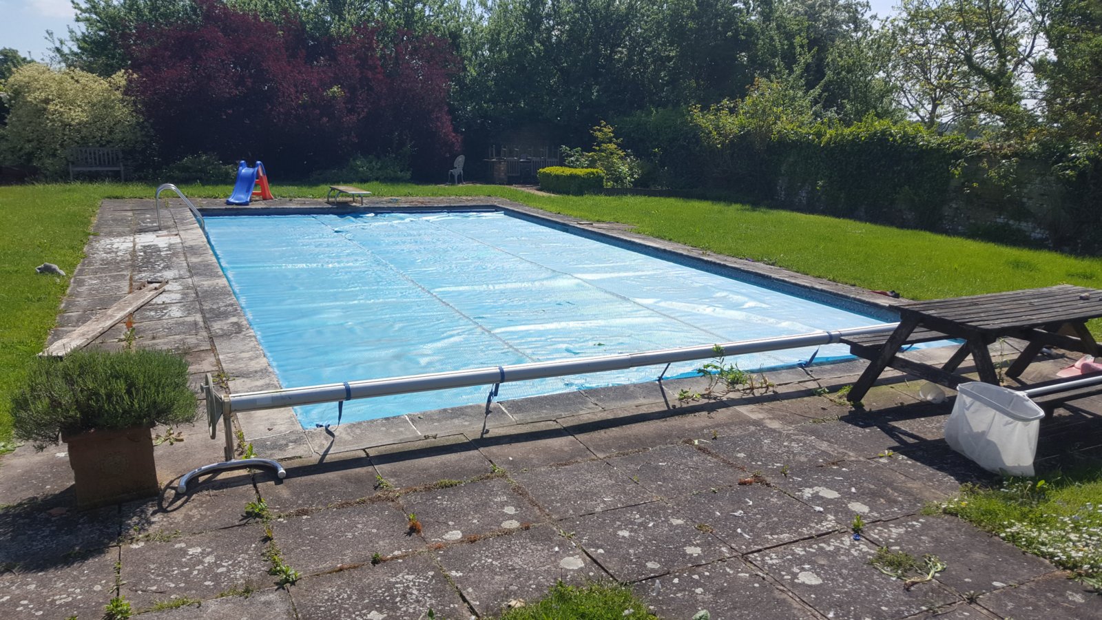

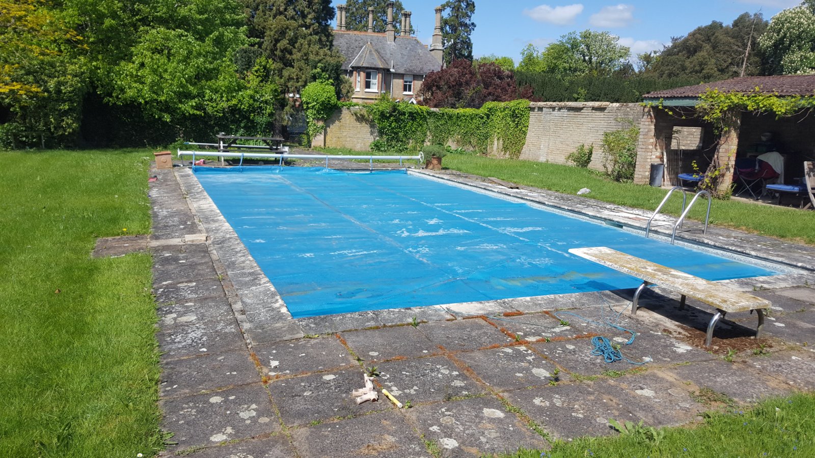

Hi all,
I need to replace all the swimming pool edge copings on an external swimming pool approx. 15m x 8m and also replace the paving around the poolside. A few questions
  • Will the pool need to be drained
  • Do I need to use any special product to bed the copings (water level is approx 100mm below bottom of copings)
  • Do I need to use any specific type of paving around pool
  • Is there anything else I need to think about which I have missed
Thanks in advance for any help or advice received :)
Post pics please?
What materials - tile, stone etc - have been used?
Is any electro-mechanical apparatus involved?
This might be a Tile forum issue?
Many thanks for the reply
I haven't got any close ups but hopefully these will do. They are pre cast concrete copings and the paving will be changed to some kind of light coloured natural stone or something similar. Preferably non slip
The only apparatus involved (apart from pool steps and diving board) are the 2 sunken filter type things which look like they will stay in situ and can be worked around

Sorry, should have mentioned I am a builder. I've been asked to do this as part of a larger job on the house and grounds etc so I'd like to do it if possible but I am well aware that these things can be specialised. In terms of the actual work...i.e. paving and laying copings I'm fine with that but obviously having the pool there may add complications I'm not aware of.
I would happily hand this over to specialists if necessary but given the current climate I would like to do as much work myself as possible :)
Sorry, but thats not a DIY job
Of course it's a DIY job, it's a slabbing! If the OP is builder, more the better.
You can use ordinary mortar mix for bedding. You just need extra care to ensure the slabs are not knocked until properly set.
It could potentially be done without draining the pool, but dropping debris into the water, plus being able to get to the bed joint to point it up may be problematic.
As for the materials, as long as the slabs are rough surfaced or ribbed and not smooth surface ceramic or quartz you'll be ok.
And ensure the edge slabs are fully bonded onto a firm base.
