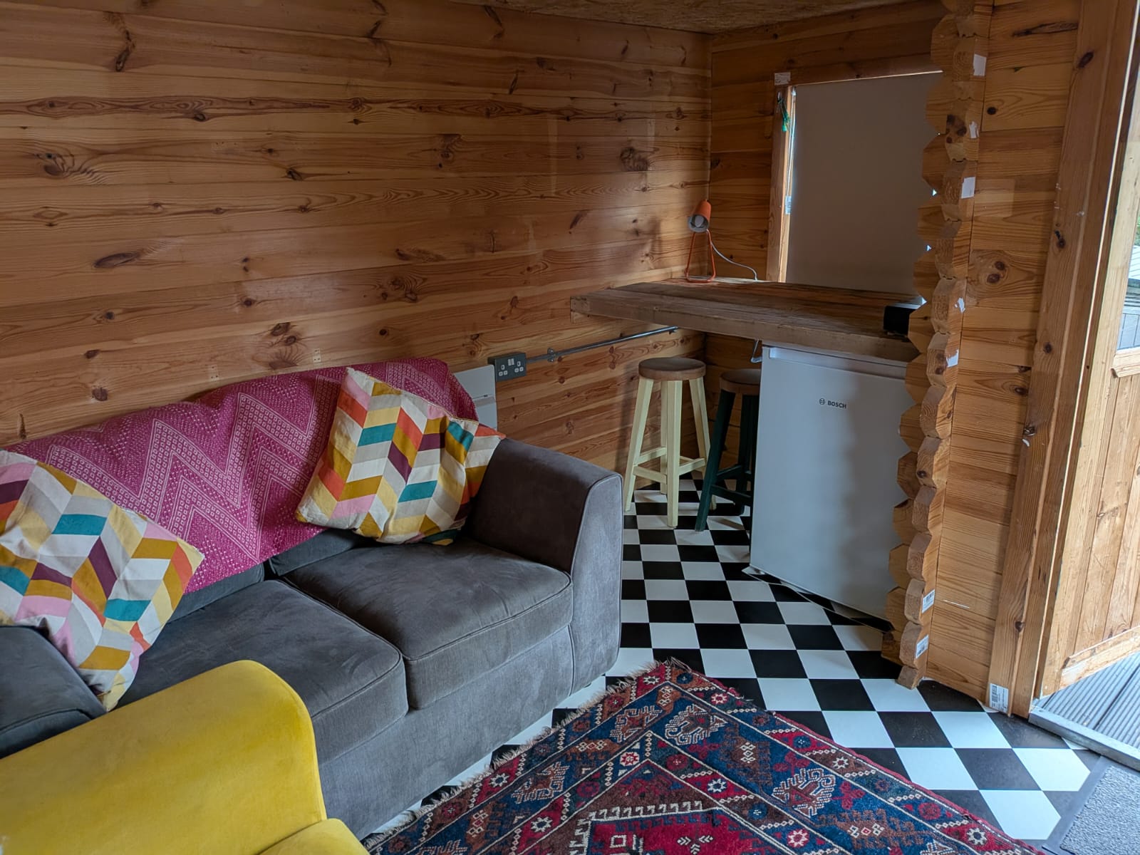

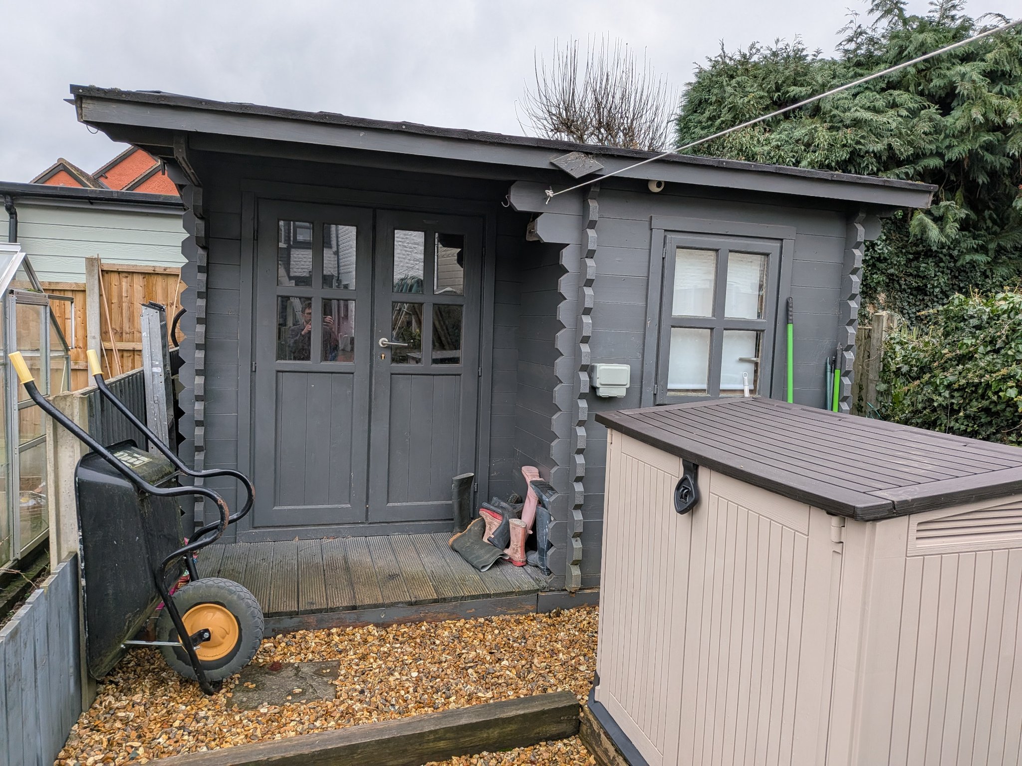

It may be better to post a photo of the frame, to show what going on there.
Herea a shot of the outside and inside to give you a better idea. It's just overlapping timber, no cavity or existing insulation

Oh, it's what my local supplier calls a "log cabin"
Each of the wide planks has a large notch near the end, so the transverse and longitudinal planks are laid alternately, and interlock at the notches.
In US, the timbers sometimes also have a tongue and groove, so each locks into the one above and below. This also prevents draughts.
I think external cladding would spoil the intended appearance.

To be fair log cabin would have probably been a better description.
The main reason to insulate is to help retain the heat but there also a couple of joins starting to fail so I wanted to add a second layer of protection.

Since it’s a 44mm interlocking log cabin, I’d be careful about fixing a normal batten system rigidly across the walls. Those logs need to expand and contract vertically with changes in moisture, so battens fixed through several courses can potentially restrict that movement and cause more gaps. Any external frame/cladding detail really needs to allow the logs to move, usually with slotted or sliding fixings.

Looking at the gaps/ingress. It looks like after stacking equipment, tools etc against the outside walls it has allowed water to track across the joins and naturally find its way inside.
The timber is still sound and showing no signs of rot. I have since freed up the walls allowing them to breath and with the overhang of the roof stopping any substantial rain from hitting them.
I have been leaning more recently to the external rockwool slabs (dual density), allowing it breath more so than the solid PIR boards.
My plan was to fix the slabs directly to the timber frame using screws and plastic discs to hold them in place (no stud wall, to stop cold spots).
Breathable membrane, 25mm battens for ventilation and cladding to finish.
