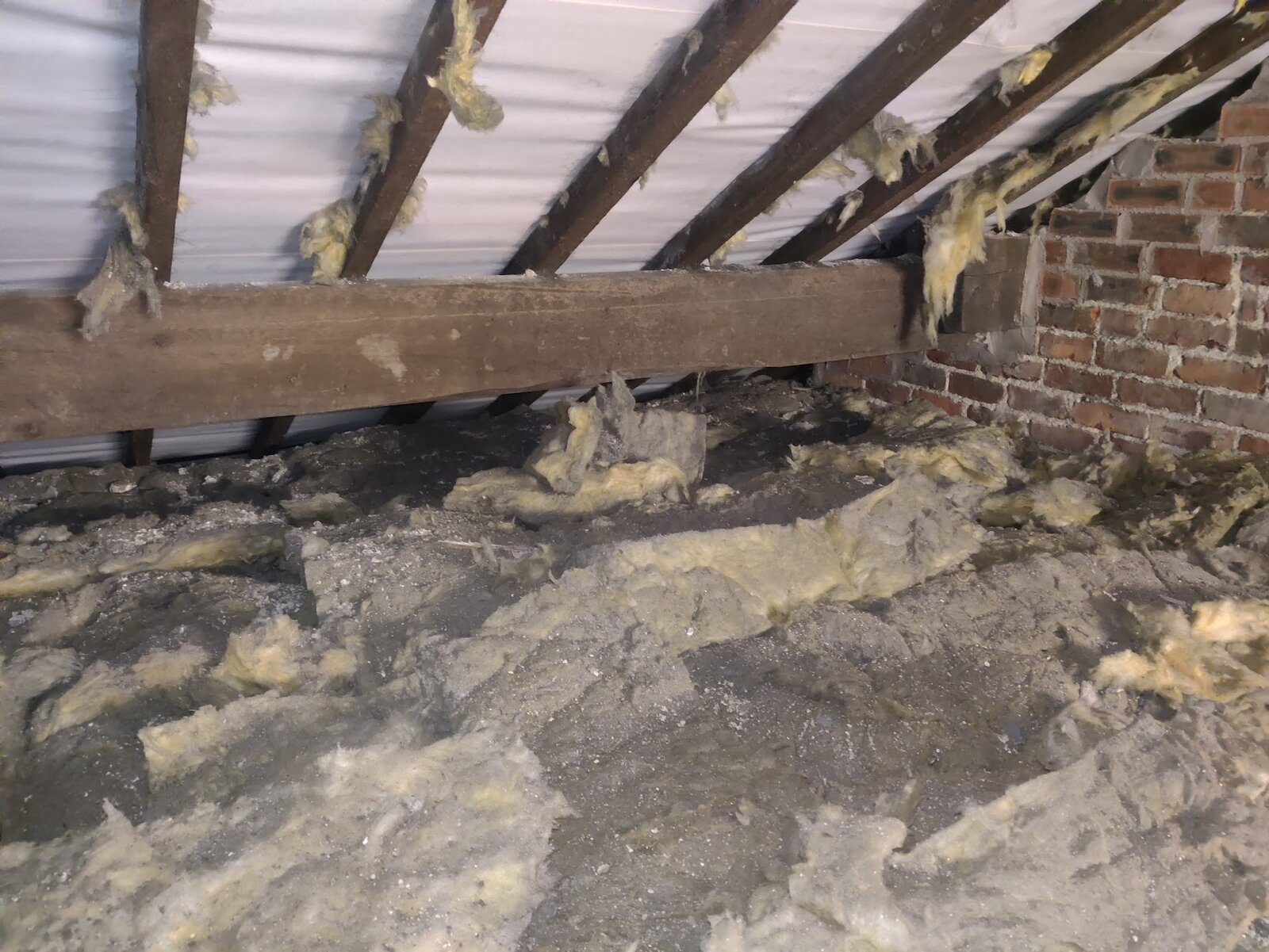

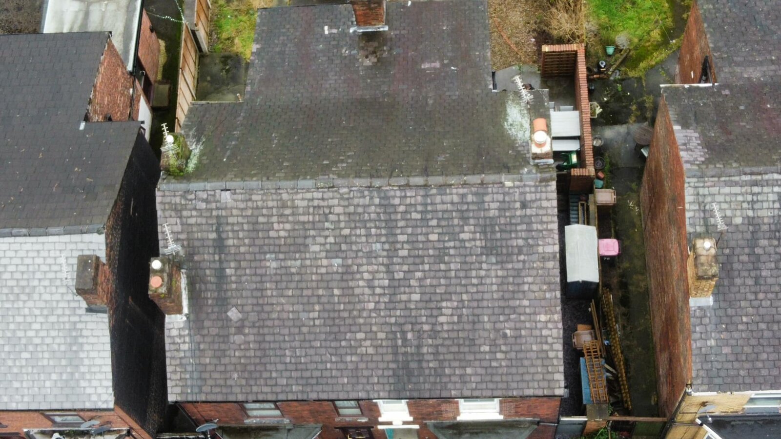

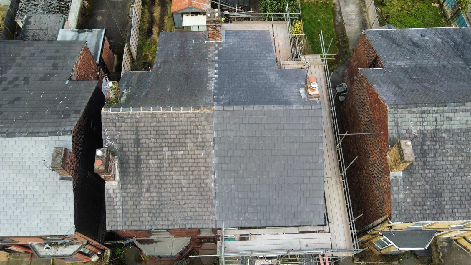

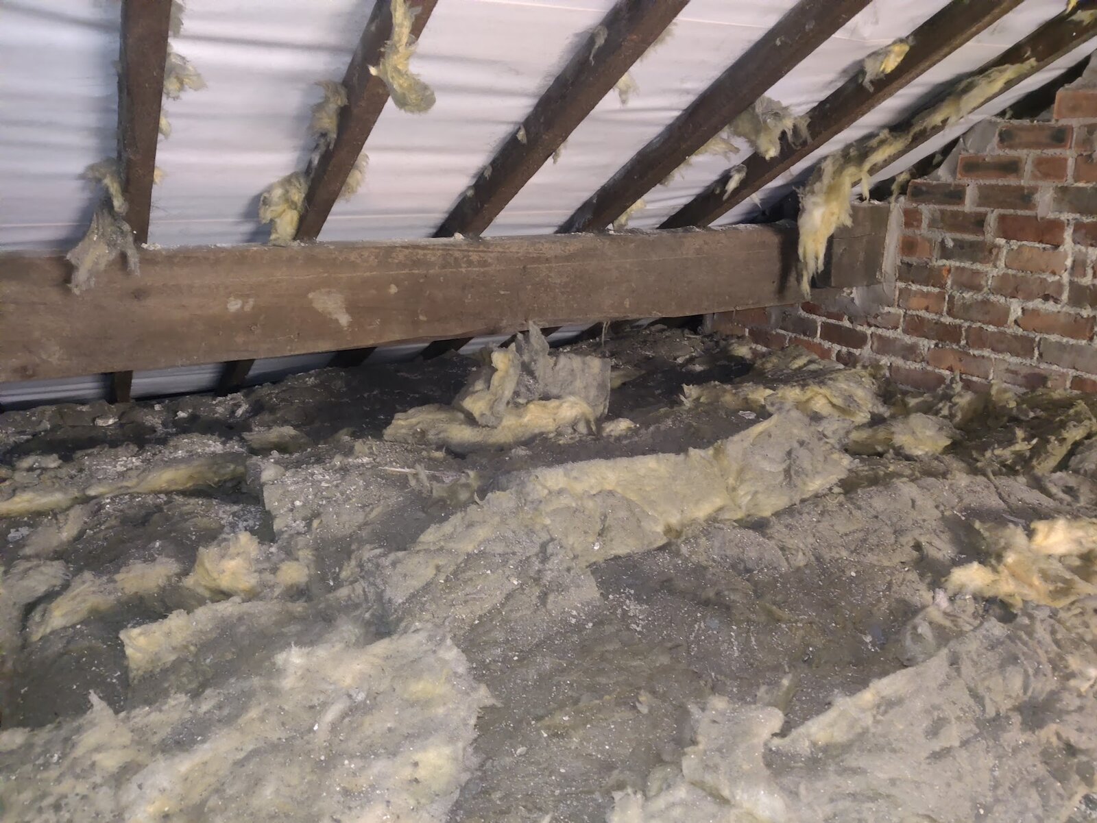

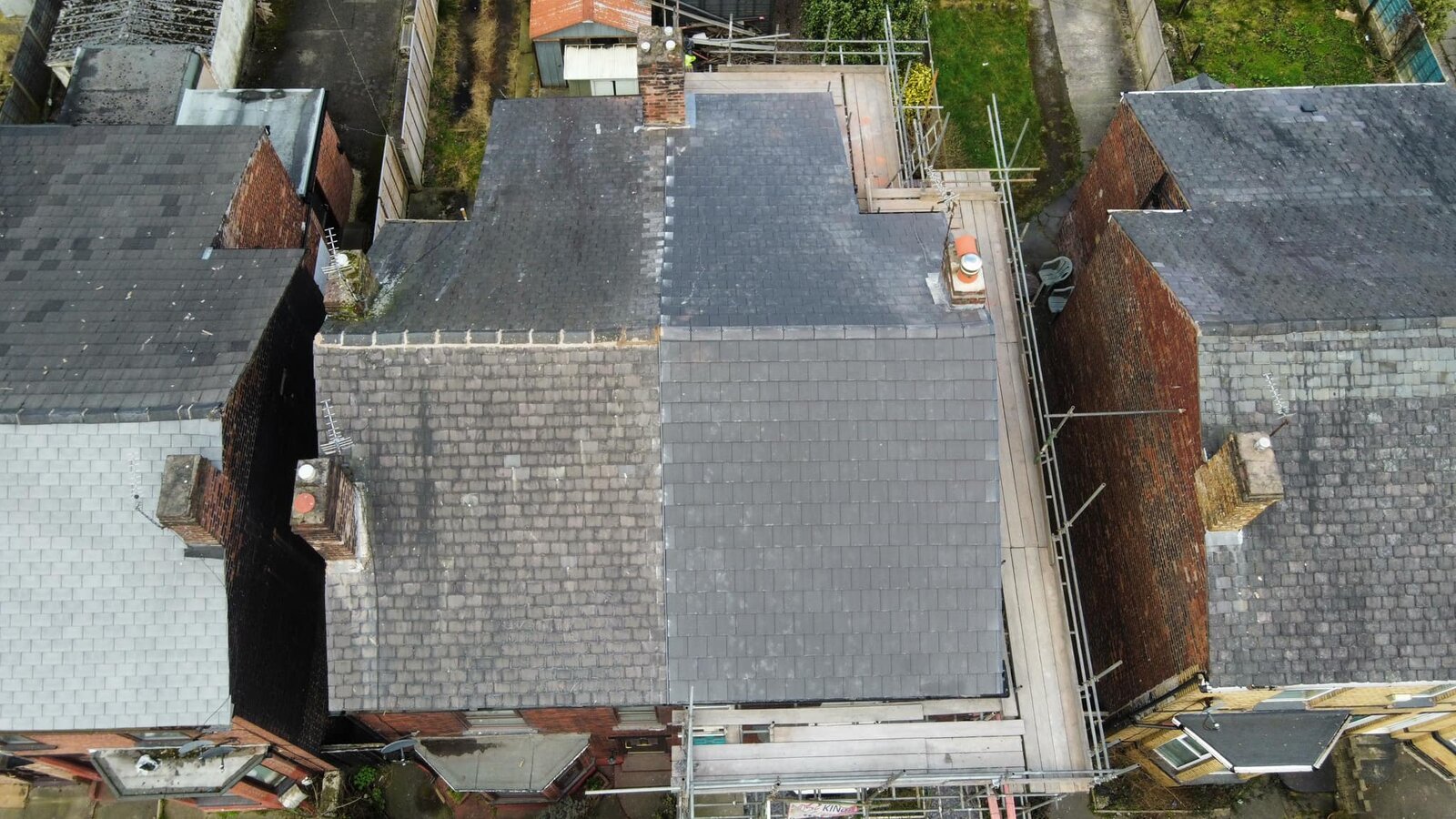

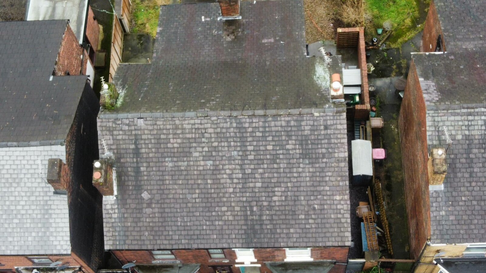

Post some pics of the inside of the roof space showing the purlins and struts, and before and after of the tiles.
I don't have any better pics of the loft space at the moment but I hope this suffices.
Top insulation is full of dust and lime torching. Insulation was blocking air flow from eves so that has been padded down.

The rafters that held a slate roof with hold a tiled roof.
Thanks Woody, that's very reassuring. Seems like i have been over worrying, but feeling very stressed out about losing lots of money on the house and then moving my family abroad!
