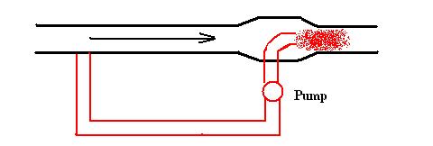

I can envisage a pump on a bypass with swept tees which would leave the 28 mm unobstructed for gravity flow but with the pump activated would produce a positive pumping action as a result of the orientation of the swept parts of the tee. Those with drawing experiene could produce a drawing.

Or make up an oversized injector tee where the pump joins back in, that also would save having the zone valve
I think I understand this (sorry for my ignorance, I'm an engineer not a plumber). Is a swept tee a larger diameter pipe in which a smaller internal diameter nozzle points in the wanted flow direction? It sounds ideal: no impediment to gravity flow, and a boost from the pump when required.
I think this is essentially the same idea.
Can either of you point me to anywhere where I can find out more about injector tees? It sounds like the right answer, so thanks guys.

Thanks, that's more or less what I thought it would be. I think I can design and make something which will do that - probably open the 28mm flow out to 35mm around the Tee to preserve area, and inject with 15mm or so from the pump, taking the pump inlet from further back along the pipe.
The forwards velocity from the injection nozzle should stop the flow just circulating around the loop ... I hope. In fact I think I feel some experimentation with a plastic bottle, transparent pipe and inky water coming on before I cut any copper!
Sorry, rubbish image, but this is what I have in mind. Black is existing 28mm gravity circuit, red is new probably 15mm to increase speed.
