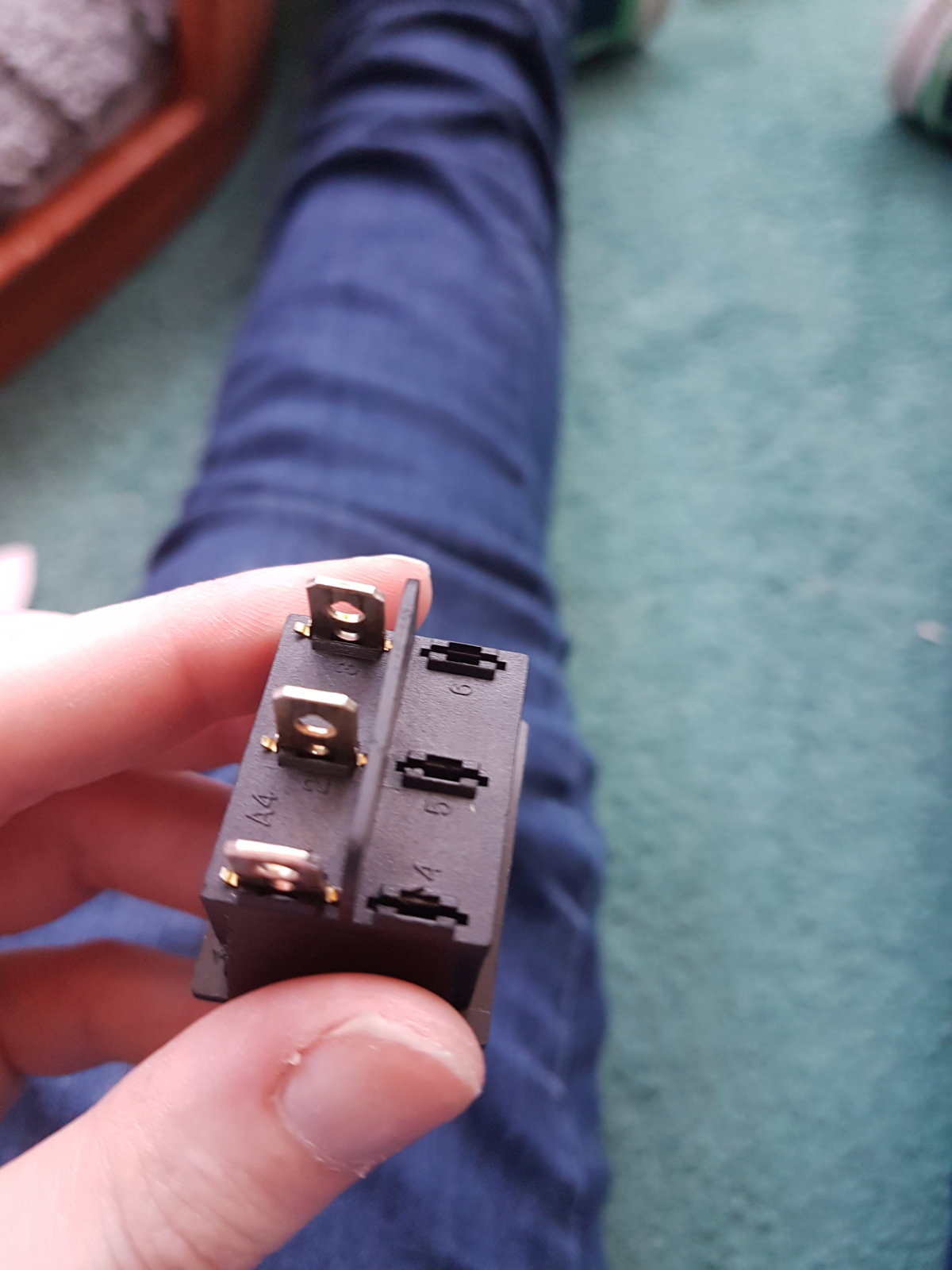

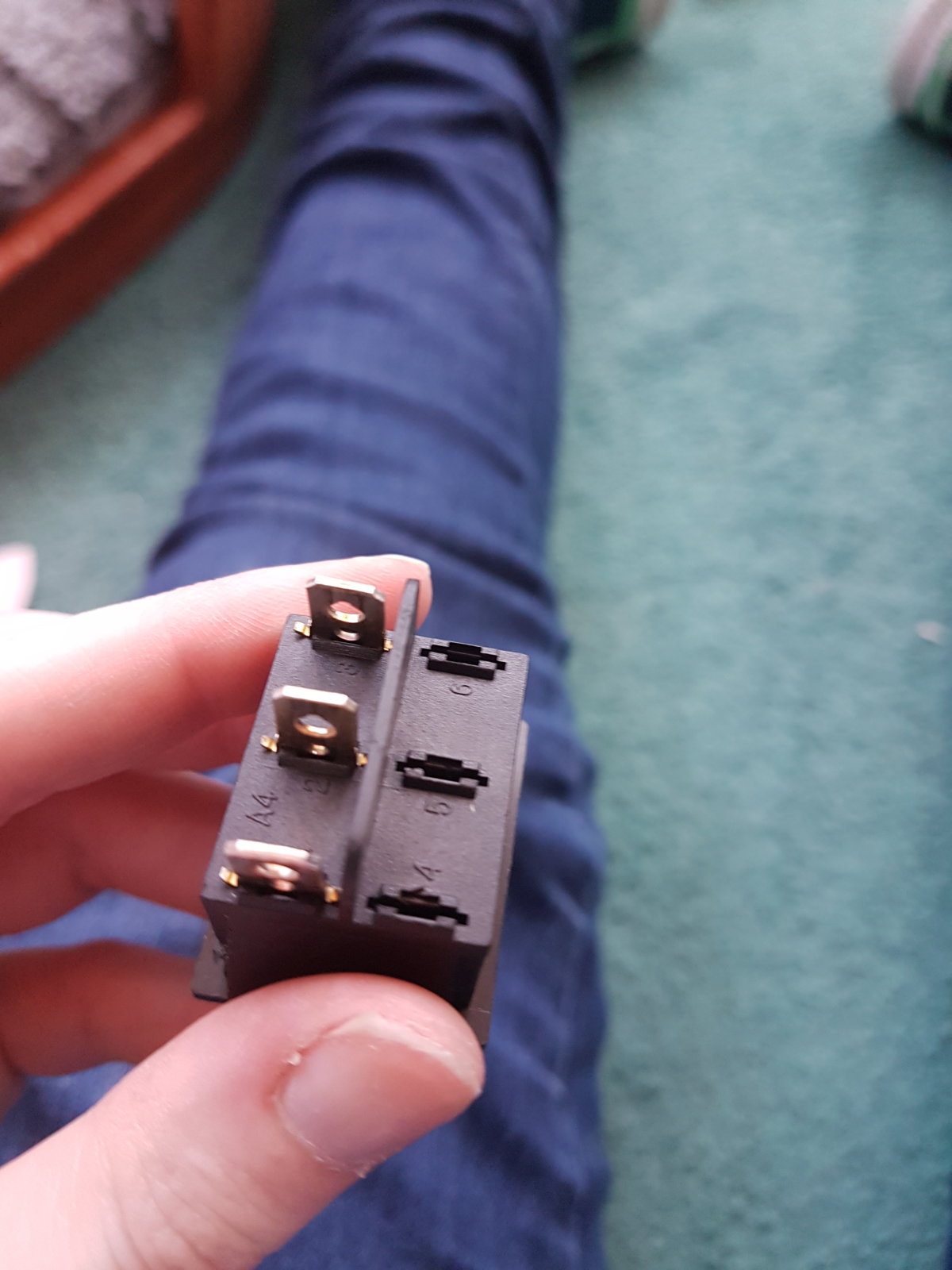

Thankfully alot of stress later it's off. However I ended up taking the worst route to get it lol unscrewed the 4 screws holding in the part that moves the switch. I actually tried swapping wires around on it should have made it go forward right but no still only backwards.

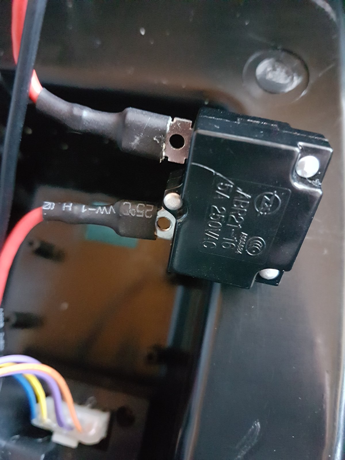

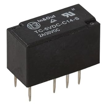

Can you see a relay in there somewhere? Should look like this...
The switch in your picture is only single pole, so that cannot reverse a DC motor on it's own. There must be more components.

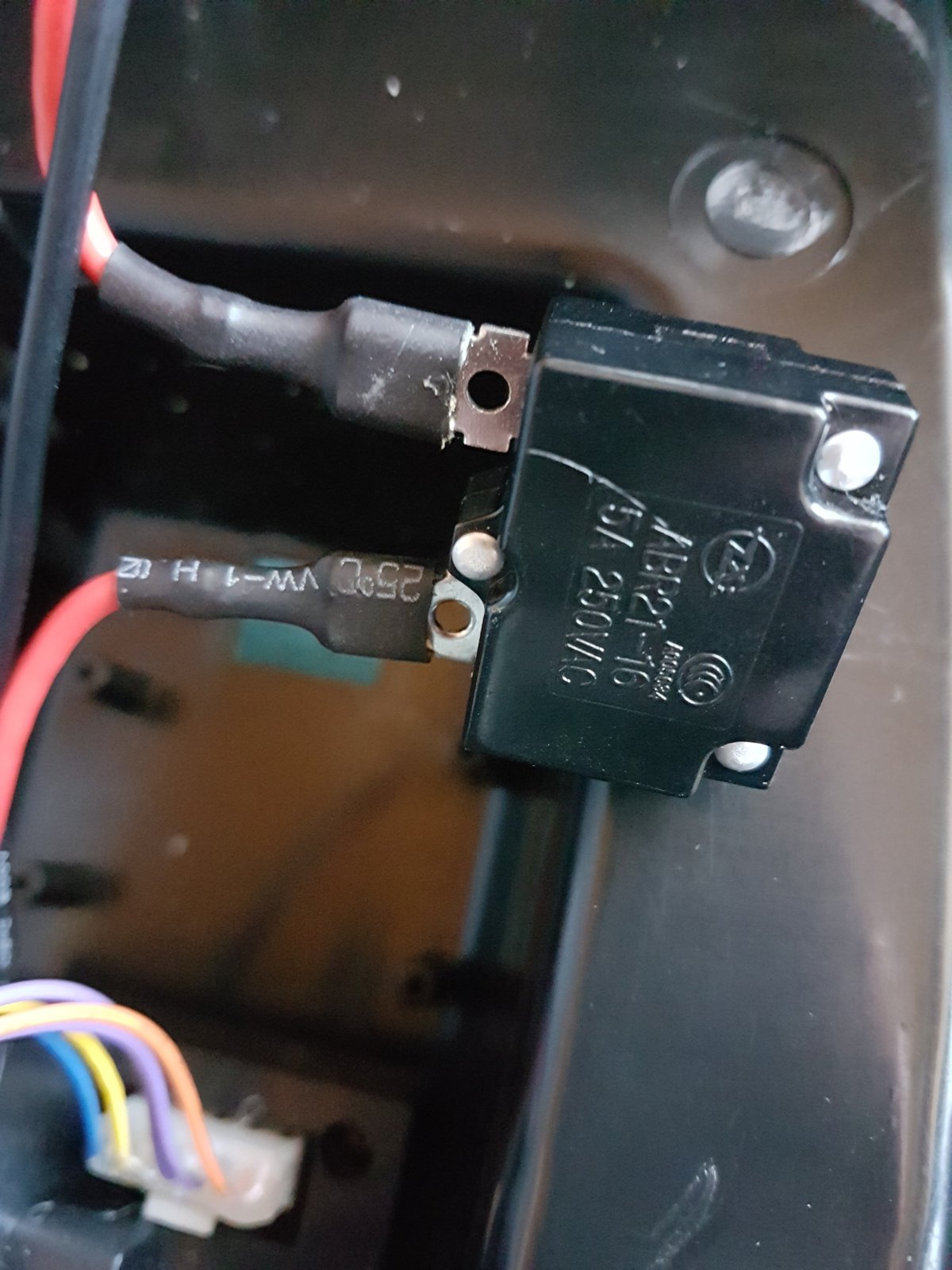

There's something big at the back but doesn't look like that and has something small coming off it. I will attach pictures. There is nothing else located with the switch. Just to add to the diagnosis here is what iv experimented with:
Orange appears to b live because nothing happens without it.
Orange and blue and it still reverses.
Orange and yellow : nothing happens

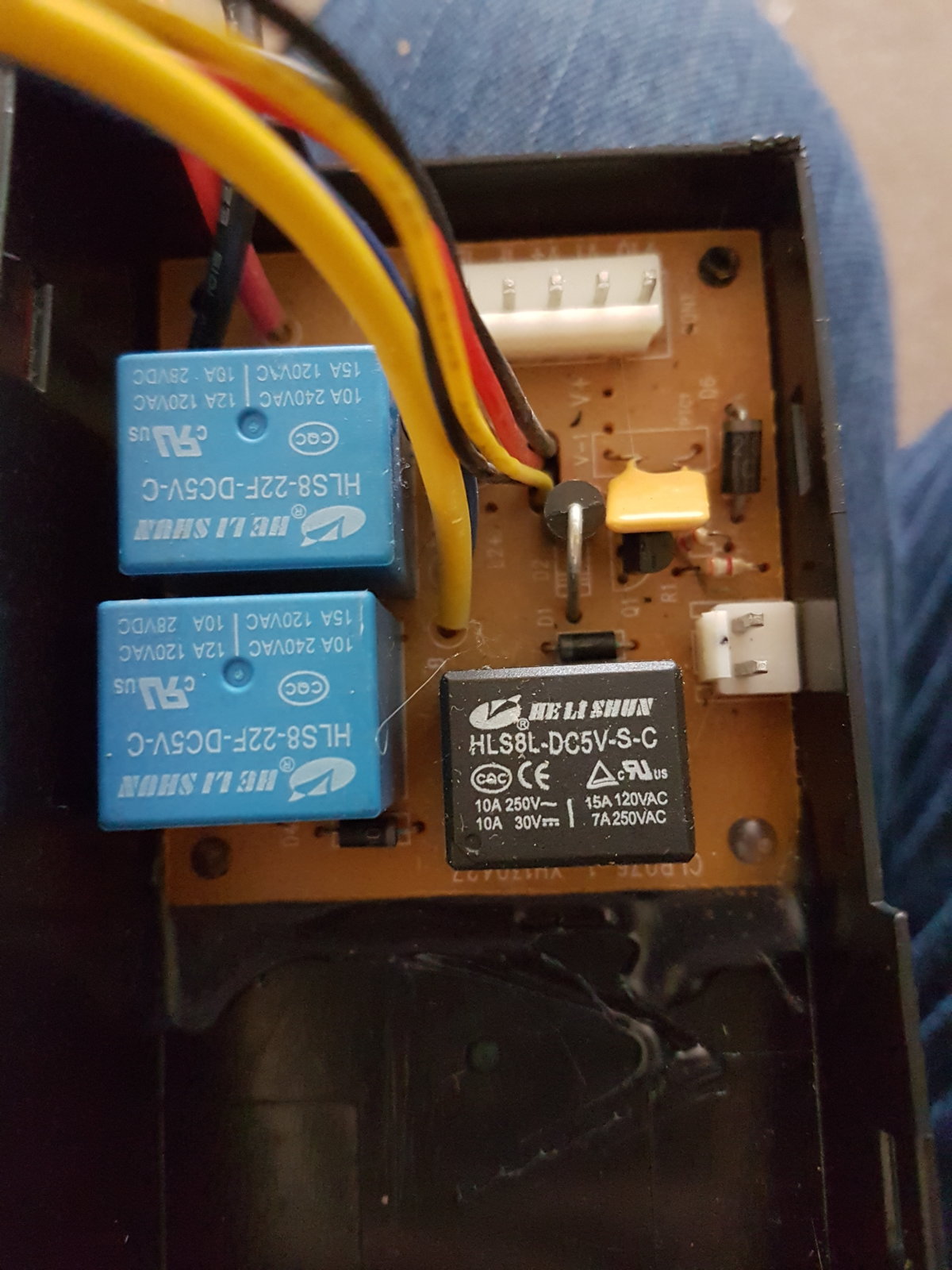

That's a thermal overload 'fuse'. If that had blown, the car wouldn't move at all.
You're going to have to delve deeper and take more pictures. There is likely a PCB under that cover. So unless you have soldering skills/equipment you might have one hell of a task repairing this.

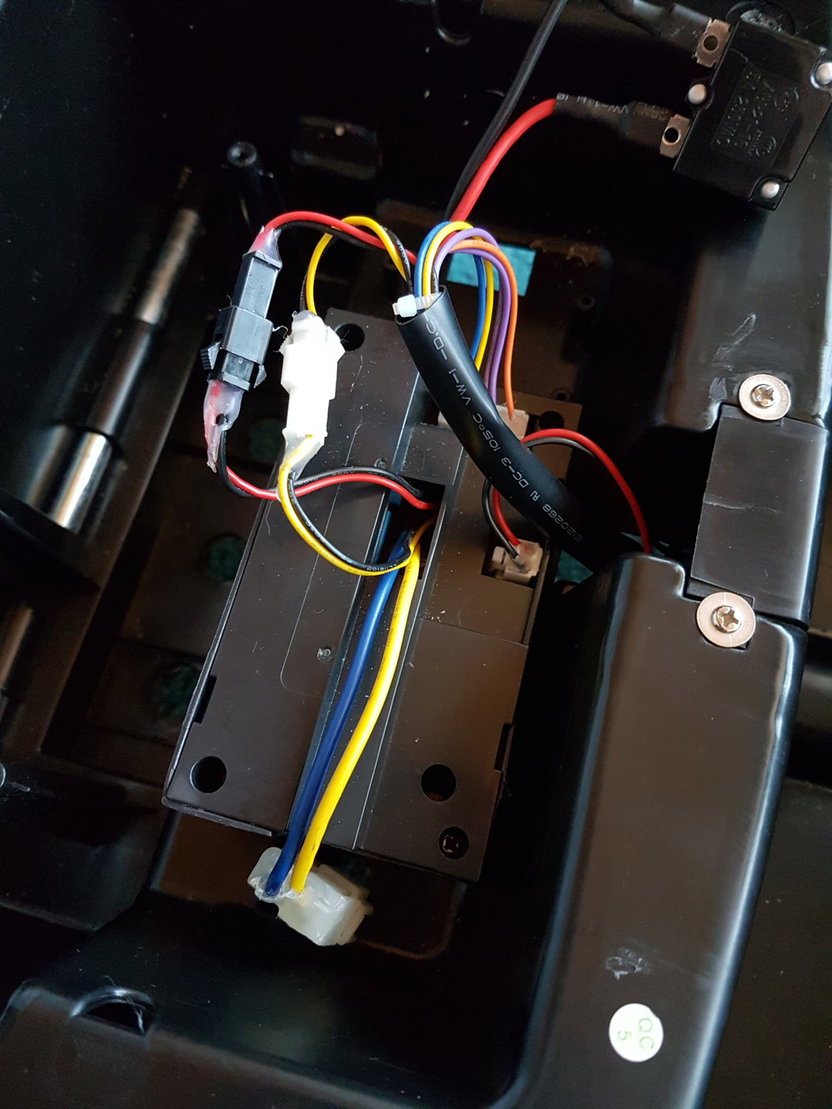

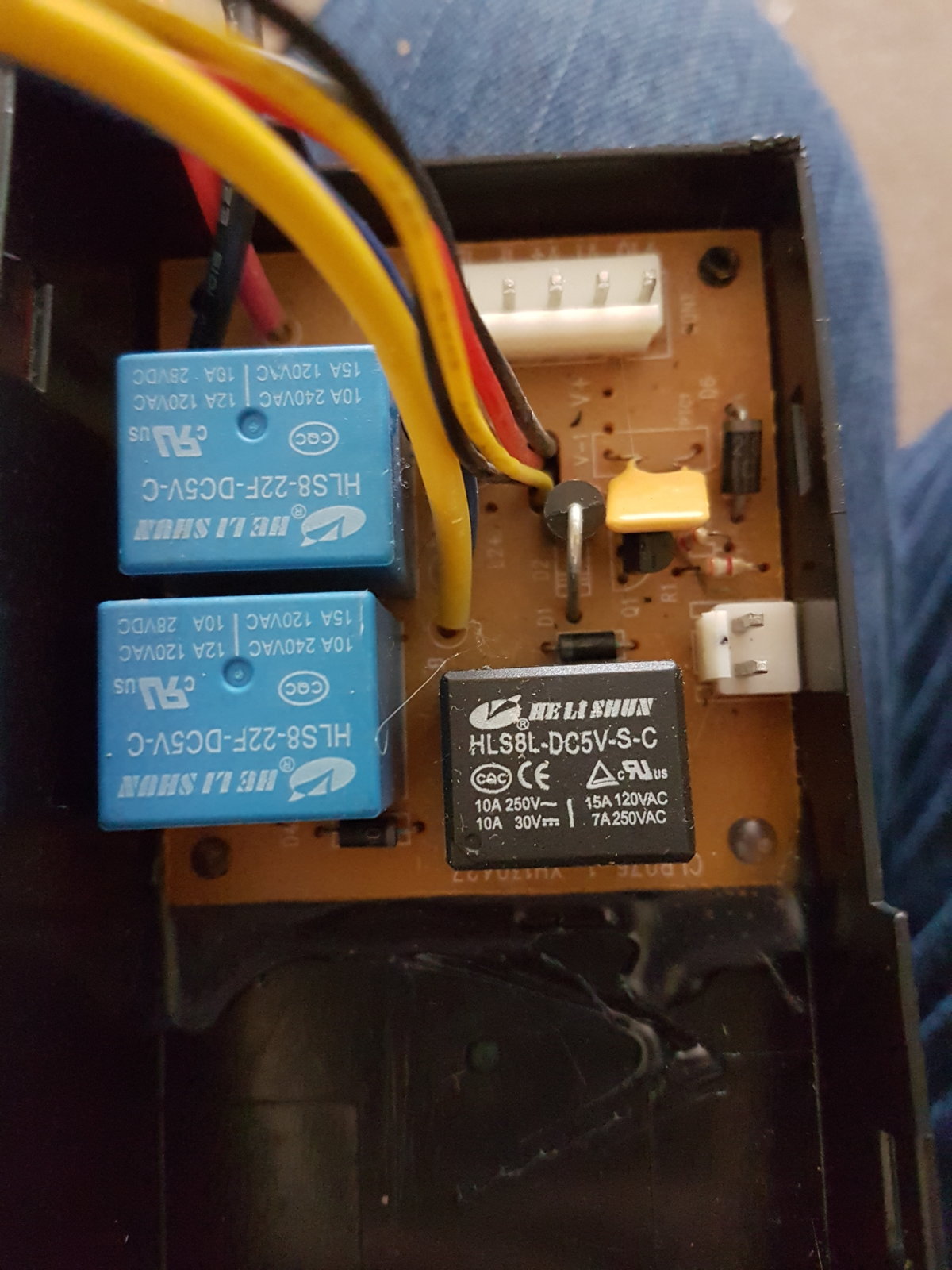

That's what I got under that cover :p I detached the whole thing
