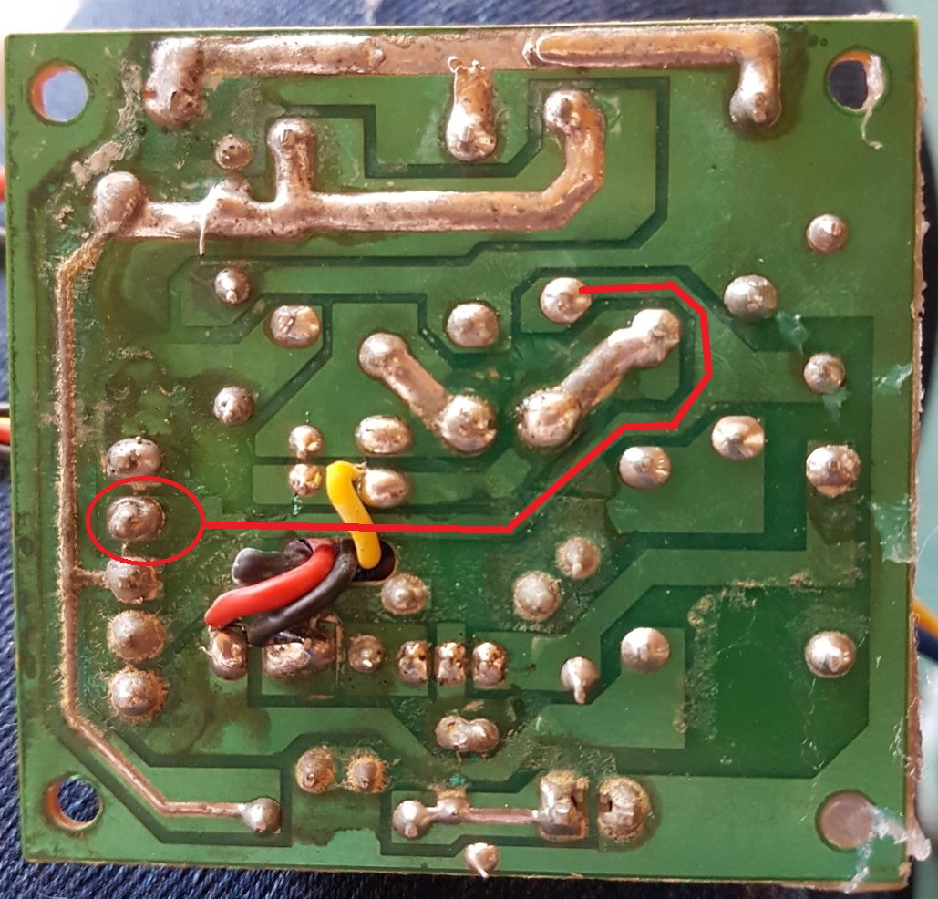

20 volts DC, the top left on the dial.
Backwards definitely has a reading but tricky on my own to keep prongs there for figuring how much. Forwards is no reading at all
There are more complicated tests that can determine which relay is at fault, but the simplest next step is to de-solder both of the blue relays and take them out. Then you can measure resistance across each coil independently, which can't be done in situ.
A working coil will give a reading of about 70Ω.

Yeah, it looks right, hard to be 100% sure without the datasheet for it though, the link given on that page doesn't work.

Car still wouldn't go forward so I'm unsure what else could be causing the fault now :( I have for now reversed the wires at the motor which made it go forward instead of backwards lol my only guess now is 1 of two things either it is the black relay or something with the circuit board itself just as it's not very clean on the underside.
In the bit circled, that could be a dry solder joint. Does it feel like you can wiggle that pin just a little, compared to the other four?
As you can see from the line I added, it controls the switching of one of the relays.
