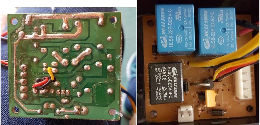

It looks like the two blue relays are supposed to be doing the forward/reverse switching and the black one is probably supplying the current (i.e. it is being switched by the foot pedal)
So, one or both of the blue relays is the likely culprit. It's possible to work out which one using the multimeter.
It's a bit worrying that they are all rated at 5vDC, yet the battery is 6v, that will have led to this premature failure. So replace all 3 relays if can source them, because the other ones will be on their way out too.

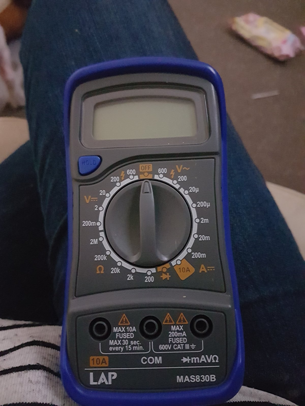

How would I test them with the meter?

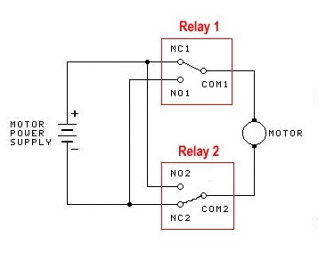

This is how two relays working together can change the direction of a motor... (coils not shown)
The angled lines flip between NC and NO when the relays activate, so the motor gets 6v (as the picture currently shows) or minus 6v.
This is pinout of your existing relays.
So, the pin 'on its own' is the COM from the above diagram.
The simplest test is to put your voltmeter probes onto both COMs and change the forward/reverse switch. You should get 6v and -6v as you swap (foot on the pedal too of course).
There are a lot more ways of testing, which can definitely pinpoint exactly which relay is at fault. Measuring the coil resistance of each relay would be handy, but you have to de-solder them first, or all you get is spurious readings from the other relay's coil during the test.

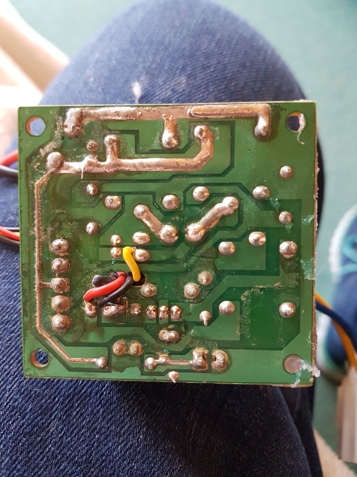

My dad Is sayin for me to use the test meter cable to create a connection with orange and yellow wires and press the pedal I presume this is testing the switch since it would bypass it. I guess that would confirm if it's the relays.
Not sure I can? (Attached a pic of the tester)
I did try his wiring but i used tinfoil to connect the two wires. so with blue and orange sure enough it reversed. With the yellow and orange nothing more than the lights came on.

It definitely looks to be relays I have tested the switch this morning with the meter and all seems to be fine.
One thing I noticed when in reverse the click of the relay is heard, in forward nothing. I got the pcb out to try test them but couldn't figure which r the com ones. I also tried to Google the relays to get the info on them with no such luck.
One thing I don't get is my dad said we could bypass the relay to test it. He had me use a wire to connect the orange to the motor wire block.
