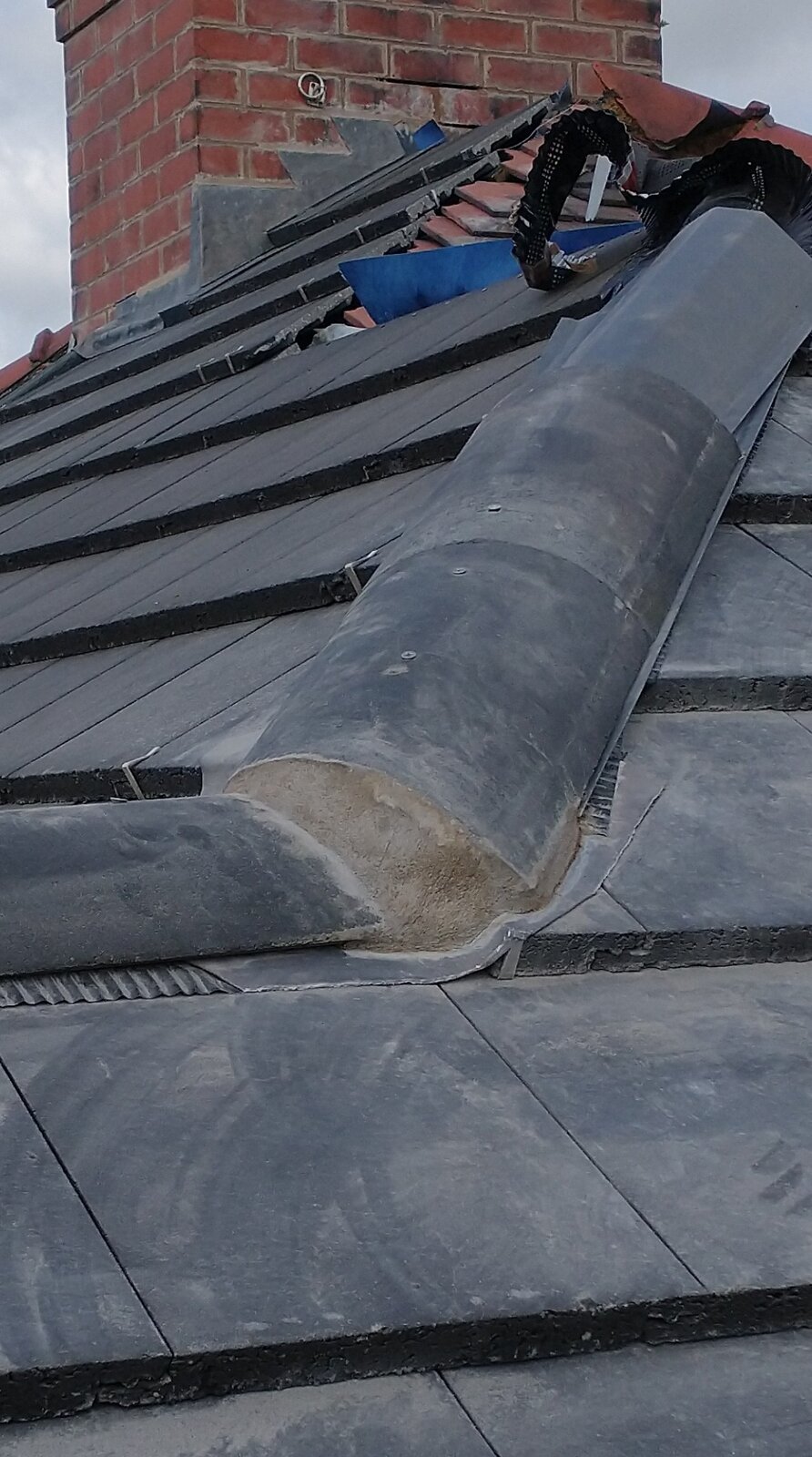

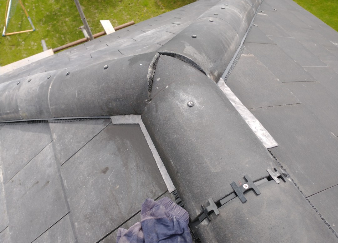

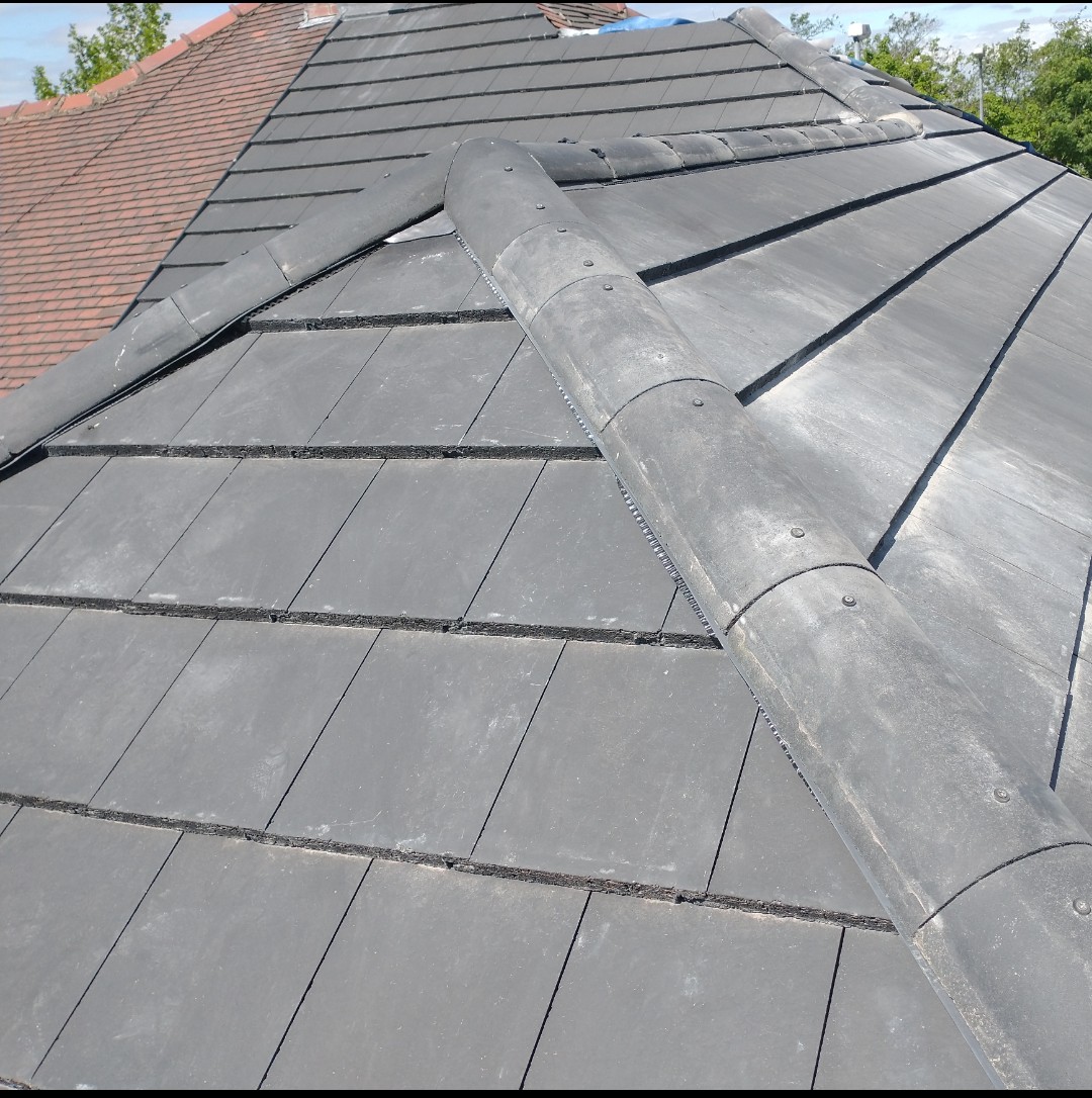

Ridge tile meeting hip

As an expert DIY roofer (having done 2 reroofs in my life), I would say there's a fair bit of jiggery-pokery goes on up there to make things look right. When I did my junction I watched a YouTube video where the (Redland?) bloke had his perfectly mocked up roof and special saddle - 2 minutes with a pencil and grinder and it all fitted together like a jigsaw.
Mine didn't quite work the same, and I wasn't paying thirty quid plus delivery for that plastic thing so I put a lead saddle on and trimmed the 3 tiles till they looked ok.
There's a fairly short cut on the hips but I was able to get two screws in so was happy with them.
At the other end I finished with sand/cement as it looked a bit open - only passing birds can see that so dye not necessary.
All looks ok from the ground.
