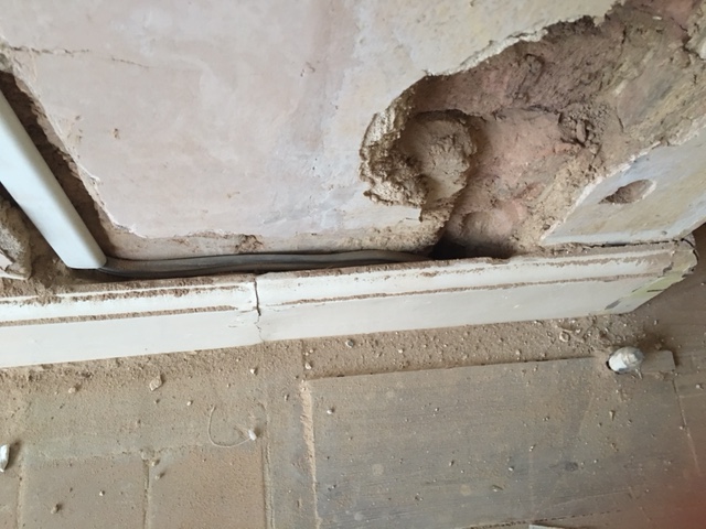

Right angle in cable run - is this OK?

This is how they have fixed it.
That's still wrong, isn't it?

Yes, 'fraid so.
Tell them to remove the skirting board and install the horizontal run beneath the floor level.

Just so I can explain my challenge: why is this wrong? Skirting board not a safe zone? No conduit? Both?
No, skirting board especially hazardous being attached by big nails.
There is conduit which looks like the top of skirting board but you don't want that for about a foot.
I am supposing the floor is concrete; is that the case?
I am supposing the floor ic concrete; is that the case?

This is a pain. The electrician only lives a few doors away so I can hardly afford to fall out with him, but if the remedial work on an identified error is not compliant.... then what else is there that I am not seeing?!
It's better in that you are less likely to drill where the skirting board is - but non-compliant is non-compliant.
Had he used some earthed metal conduit over the bits that aren't in zones, it would have been ok.
If you were willing to have a low level socket in line with where the cables emerge from the floor, the problem could be solved fairly easily.

The rules don't actually say 'don't run cables horizontally behind skirting boards', but this is clearly wrong.
The only way round it is to pretend the skirting board is a boxing for cables...!
I would say the best thing would be to put a fused spur / isolator where you were talking about putting a socket. That way you can easily switch off power to the TV if something goes wrong etc.

Update: he has taken off the skirting board and rerun the cable properly. Phew.

I just said that the rectification is still wrong, and that skirting boards are not a safe zone.
They took off the boards, and pulled the cables up through the floor directly below where the socket is. In the other room the cable does run along just under floor level for a few cm, but that runs through a solid hearth for a fire so I'll be putting down something like concrete on top of it anyway.
