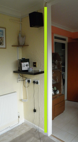

Thanks all. Having read all of that, I think the position is that what he has done is not compliant unless:
1. The chimney Breast is treated as a wall and so its corners treated like external corners; and
2 the vertical cable is no more than 150mm from the edge of the chimney.
I'll measure it tonight.
I don't mean to sound disingenuous but are you sure that's correct?
The way the reg is worded, external corners would comply, but...
Is it shown anywhere other than a NICEIC publication?
I don't believe that it's been seen anywhere except in that publication, so as the reg is all about managing expectations of where cables might be, for reasons of safety, for one isolated source to introduce an arrangement which nobody else uses doesn't seem safe to me.

Whilst it would seem that what is written is open to this interpretation and 270° is indeed an angle, why does the regulation not just say within 150mm. from the edge of a wall - as it does just say within 150mm. from the top of a wall?
Logically, because it doesn't say the edge of a wall, this would not be allowed but what is the difference?
Non-compliance with regulations doesn't necessarily constitute a "danger" :unsure:
Possibly not. But running cables in places where people don't expect them does seem a trifle dangerous, wouldn't you agree?

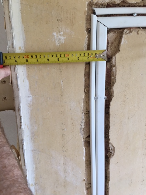

Possibly. He was very certain that the best place for the socket was in the centre of the chimney - you can probably see the mark on the wall where I had asked for it to be put originally.
In any case - even if that was his intention and it is a good one, it is still not compliant is it? The cables are more than 200mm from the edge of the chimney breast too (see image). (this is the other bedroom)

The lesser of the evils?
I would get the electrician to fit a single socket on the vertical run.
Some will say this (if the cable is a spur) is still not compliant but with just a TV (and similar) in the double socket, it will not overload the cable.
Why are there two conduits in the recent picture?
Thanks - good question. I will investigate.
