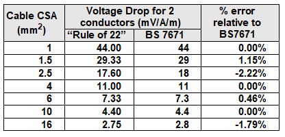

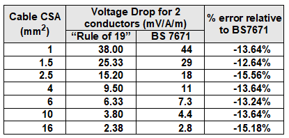

Thanks. However, I don't think his/her "rule of 16" is either anything different from what we've been doing, or anything like the optimum "rule of thumb". He/she wrote:
There is another way to check, the rule of 16, which is even more approximate. Namely that a single core 1mm cross -section and is 16 milliohms per metre at room temp (more like 19 when running hot)
For a start, for comparison with BS 7671 VD figures, it really becomes a "rule of 19" (since BS 7671 figures relate to 70°C, which I presume corresponds with 'running hot'). Also, for comparison with BS7671, the figures need to be doubled (because the BS 7671 fig relate to VD in two conductors) - so it becomes a "rule of 38".
If one works pro-rata from that for other CSA's we get the following, which shows that a "rule of 38" results in figures which are all about 13% - 16% lower than the BS7671 figures.
On the other hand, one could do as EFLI did, and use the BS 7671 figure for 1mm² cable as the starting point - so effectively a "rule of 44". That then produces pro-rata results for other CSAs which are all within about 2% of the BS 7671 figures, with three of them (1mm², 4mm² and 10mm²) being identical to the BS7671 figures.
I therefore know which one I would prefer as my "rule of thumb" (which is just a way of describing extrapolation from BS7671's figure for 1mm² cable)!

In terms of the one context we were discussing, not only does he say himself that The "Rule of 16" should really be "a Rule of 19" (since we, and certainly BS 7671,usually consider the worst-case {VD-wise} of 'running hot') but, as I wrote a "Rule of 22" would produce figures very much closer to the BS 7671 (and everyone else's) figures - and 22 is quite a long way from 16, even for a "rule of thumb"
