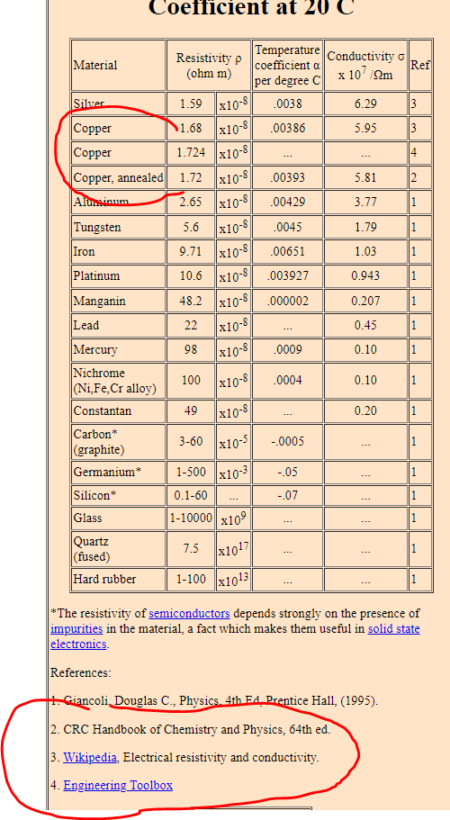

I came across this:

I came across this: ...
Thanks.
I wonder if we're not being unrealistic (naïve?) is expecting all sources to quote identical figures?
In terms of virtually any 'properties of materials' (resistivity, temp coefficients of resistance/expansion,, density, , thermal conductivity etc.. etc.), one will almost always find small variations between 'sources' - and it's rare that there is one figure which one can regard as the "Gold Standard" (maybe a source such as the Ntional Physical Laboratory would be the closet to that?)/
It is also apparent that some (probably very small) variations are going to exist in relation to different versions of "copper" (e.g. annealed vs .not annealed).
However, as I've just written, we're talking about something a little different from that - namely the fact that several sources are quoting resistances (per length) of conductors of different CSAs which are not inversely proportional to the CSAs - despite the fact that they all should be based on the same resistivity.
Kind Regards, John
