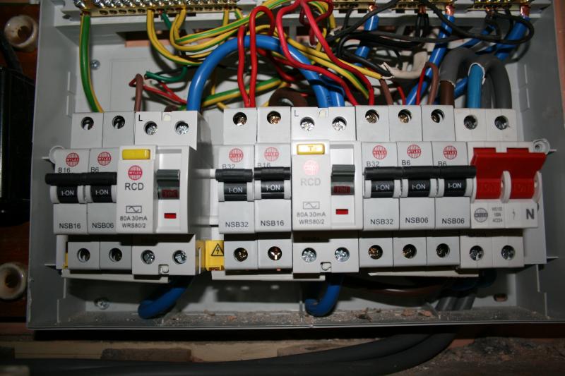

Those wires are an essential safety feature and the consumer unit should not be installed without them.I was made aware that there is a need for earth wires to be fitted to gas and water pipes.
flameport";p="1487310 said:The picture:
As for the CU - what are the 3 circuits to the right, which have no RCD protection?
The electrician stated that he put the lighting circuits on the unprotected side to ensure there is always light available in the event of a trip and that it is down to the electrician's discretion, whether or not this is done. Is this acceptable practice?

This is why he should put them on different RCD's. But on your TT installation they must be RCD protected.The electrician stated that he put the lighting circuits on the unprotected side to ensure there is always light available in the event of a trip
It's not down to the electrician discretion. All circuits on a TT system must be protected by an RCD.that it is down to the electrician's discretion, whether or not this is done. Is this acceptable practice?
It is not a separate job. It must be checked and upgraded while completing the CU change. You must make sure that the protective earth bonds are in place and adequately sized.Does the electrician have to install earth wires to water and gas pipes as part of fitting the CU unit, as he says this would be a seperate job.
