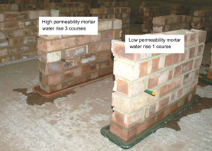

When I've more free time I'll do my own experiment with old bricks on whether water can actually seep up beyond a discontinuity such as a mortar joint.
The brick in the photo was in about an inch of water and rose up a few inches in a couple of hours. Went up a thermalite even quicker.
The mortar was lime. However in an old piece of brickwork it wouldn't get past the first bed joint, so your theory might be right George.
mortar and bricks have different pore sizes
the water rises by capillarity
the smaller the pore size, the more it attracts the water
water will easily travel from large pores to small,but resists going from small to large.
so each course provides an obstacle
very often the water can only get one or two courses up from the source
unless there is rubble in the cavity, or plaster or render on the bricks
in my house, it will only go up one course from the paving; it doesn't even reach the damp course
(0the bricks in the bottom course look full of hard water limescale, they even have a visible crust of it
this has presumably reduced the pore size in the bottom course, making it harder for the water to get into the larger pores above)
when the structure of the wall enables it to go higher, it will stop at the point where evaporation from the surface equals or exceeds water rising from the source. so hacking off plaster or render, exposing clean bare brick, and maximising ventilation (e.g. under floors or in disused chimneys) can dry out damp. Some people mistakenly apply cement render, or bituminous paint, to the bottom of walls thinking it will reduce damp, but it has the opposite effect
I don't know the pore size in lime mortar, so it may behave differently, I have only observed post-Victorian clay bricks and cement mortar.
there are some excellent photos of clean brickwork built in test labs, with the plinths standing in basins of water, and the water refuses to rise more than a couple of courses.
