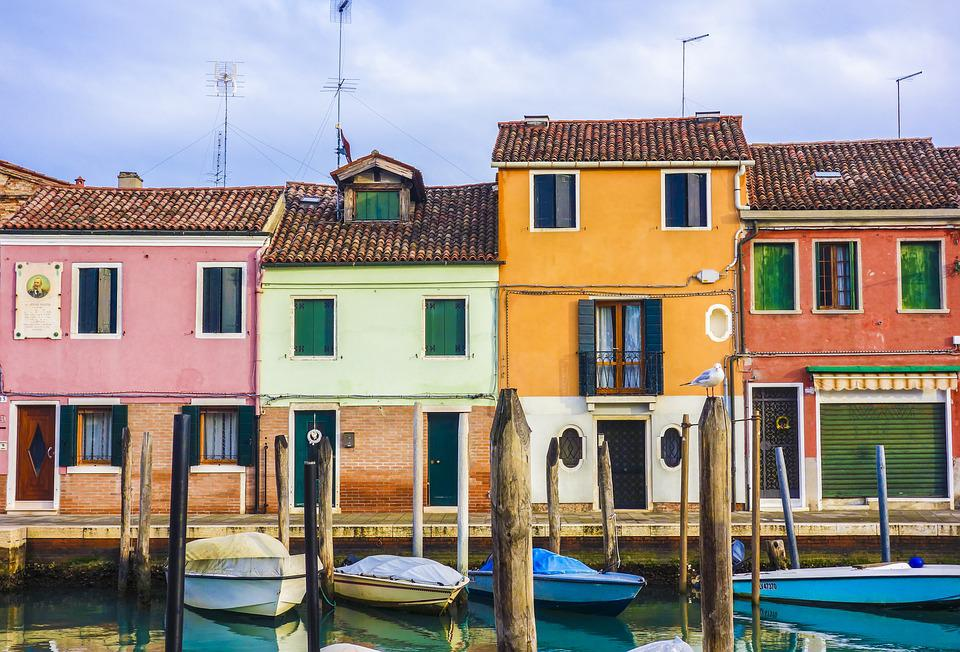

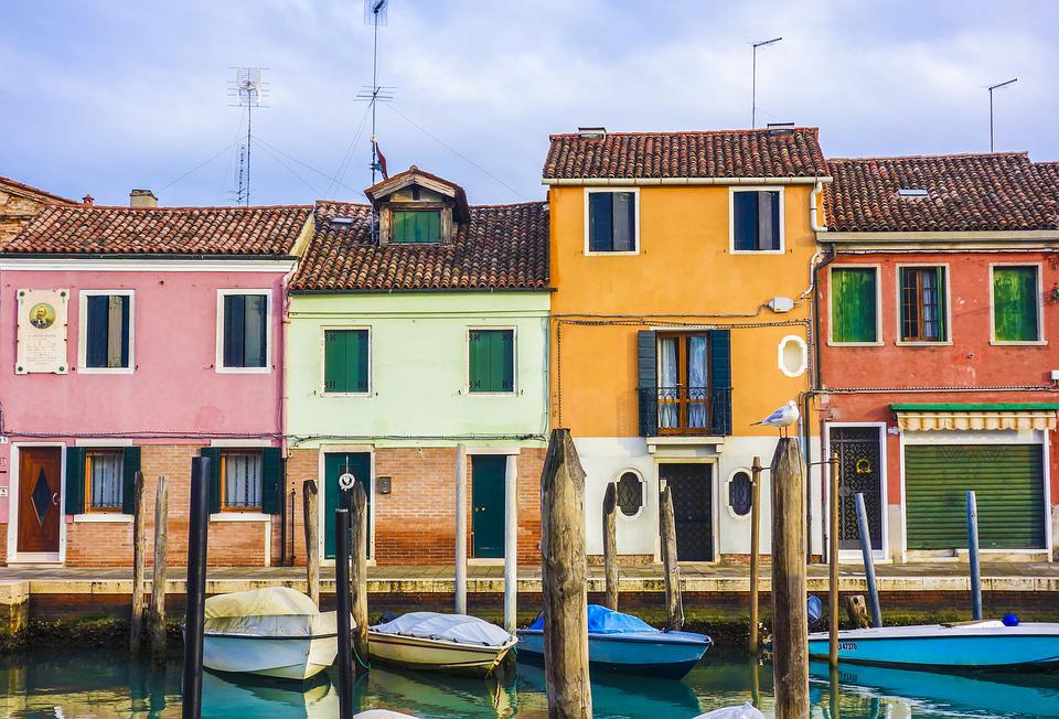

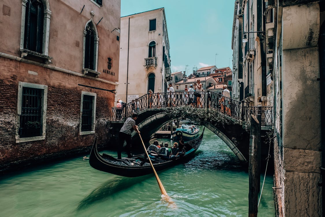

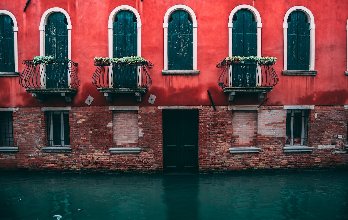

if I were in Venice
... you wouldnt see those buildings, as they are in Bruges.

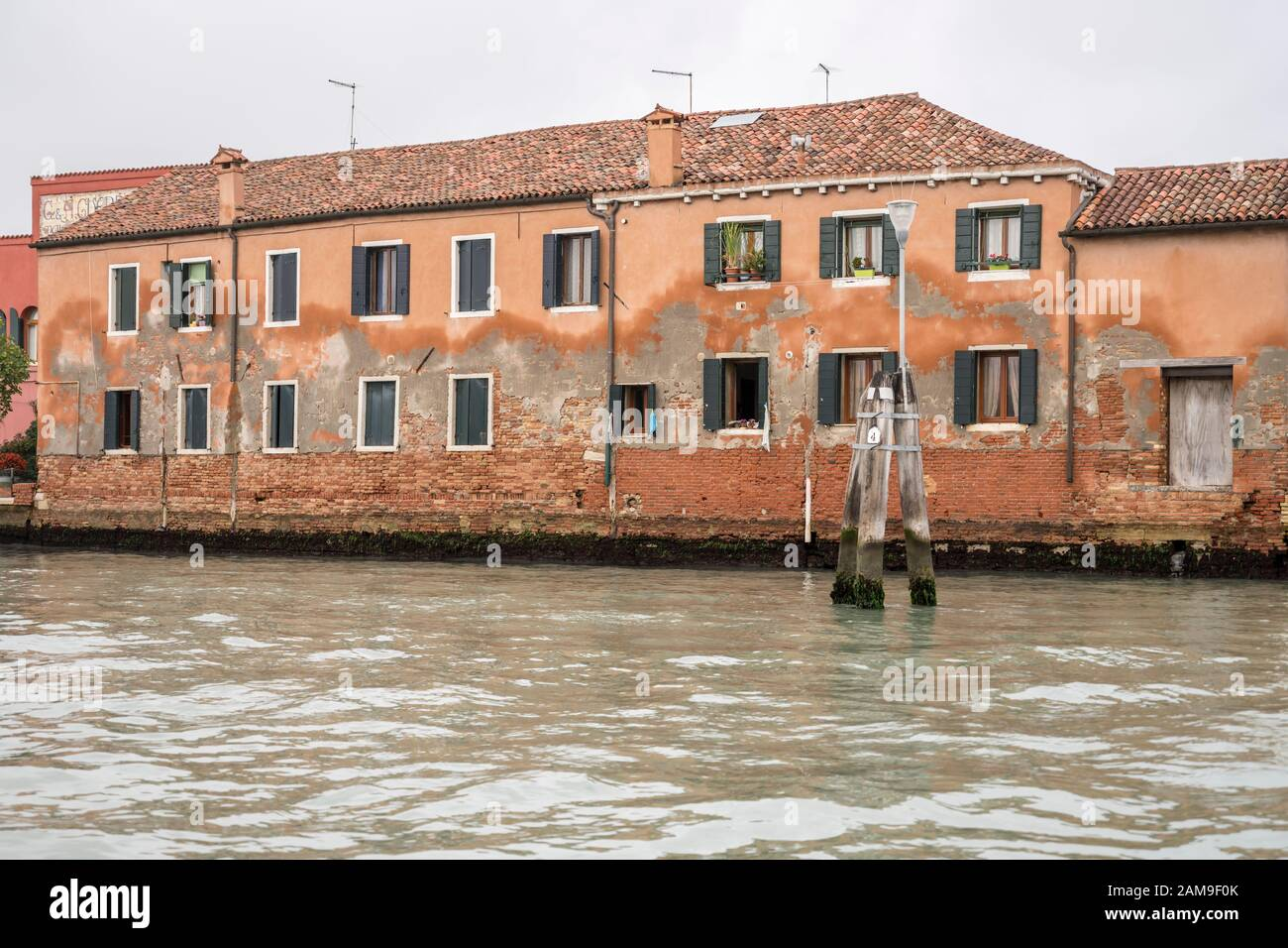

Here's some houses in Venice. They must have had a very high tide that morning for the penetrating damp to get that high!

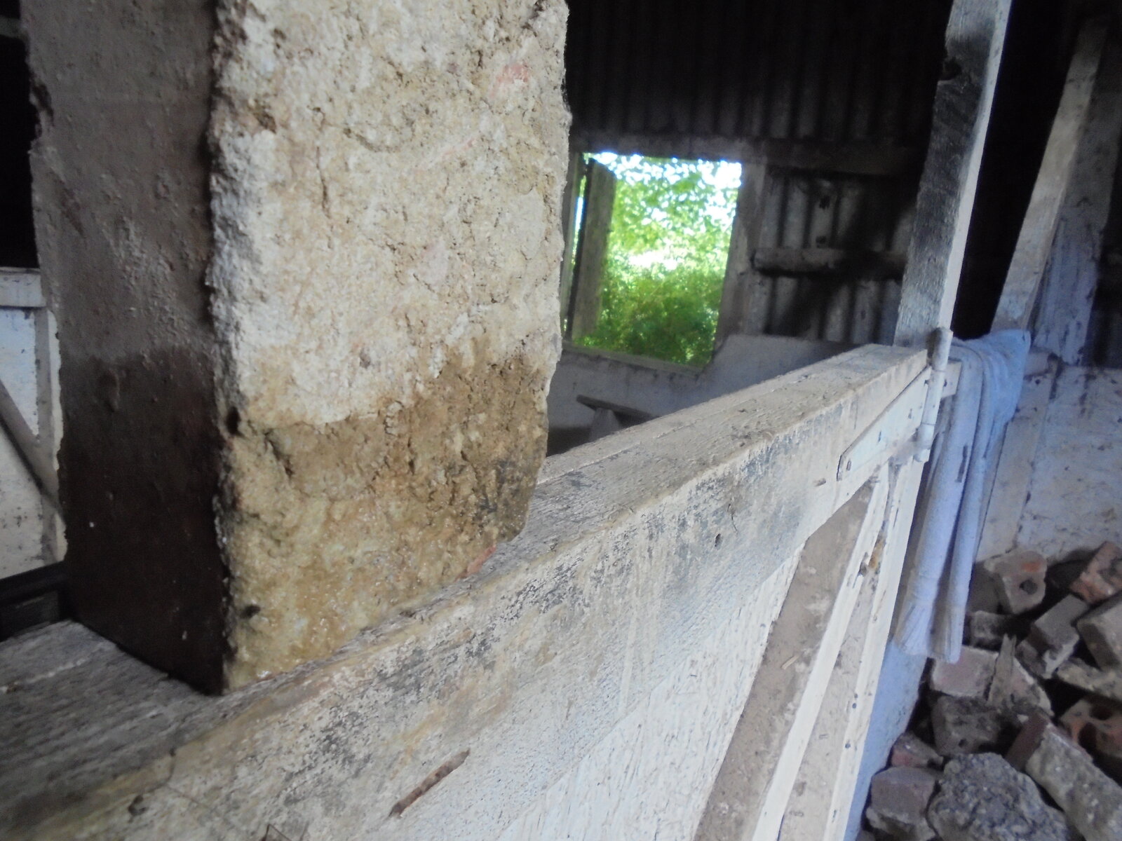

When I've more free time I'll do my own experiment with old bricks on whether water can actually seep up beyond a discontinuity such as a mortar joint.
The brick in the photo was in about an inch of water and rose up a few inches in a couple of hours. Went up a thermalite even quicker.
The mortar was lime. However in an old piece of brickwork it wouldn't get past the first bed joint, so your theory might be right George.
