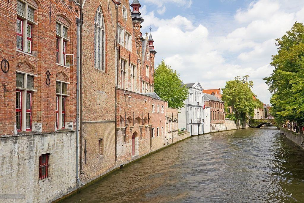

The point is .... in that image, where is the rising damp?
Without going into the properties it is not possible to tell. Take some photos and moisture readings from the inside.
Are any of those rooms at water level used for anything other than ventilation?
You don't need to go in. Look at the brick walls!
No stain, no lichen, no salt stain, no tide mark. No damp by the look of it. Why not? Surely a brick wall right next to a water source should have damp rising up it?
