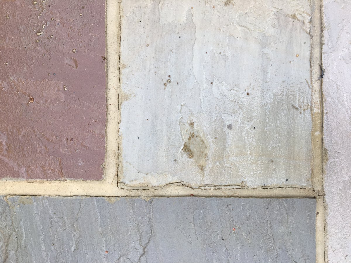

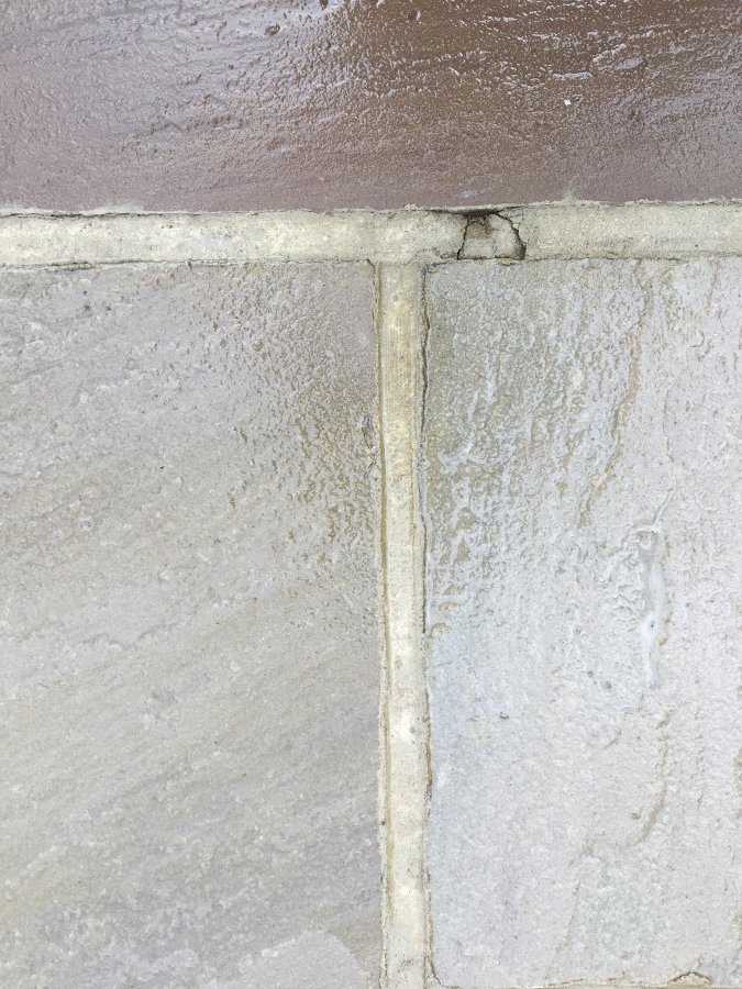

Hi All. We've just had a new patio laid - 90m sq in total, so a bit of a beast. In general I'm happy but before I pay my builder I wanted to get some advise on a couple of niggles that are bothering me. I'm unsure whether to accept as being normal or ask him to re do.In a handful of areas, there are hairline cracks, between pointing and slab. Are these likely to be a problem in the future - weeds, widening due to ice expansion etc? Also some of the slabs don't appear to have bedded down properly and you can hear them moving when you walk on them or the kids ride their bikes over them. It is slight, as it is not necessary visible. Again, is likely to get worse over time? The slabs were laid on a flat mortar base. I've posted a handful of photos of the cracks below. Thanks in advance!

Be very wary here. The minute cracks are most likely caused by movement in the flags. If the flags are moving in any way they need to be re-laid. It will not 'settle' or bed in or be cured by repointing or any other reason the builder may come up with.
I would lift one of the rocking ones and check the bedding. It should be a full mortar bed with no voids, not dots or dabs here and there.
The only other cause of the minute cracking would be shrinkage if it was pointed on a very hot dry day. In which case it would need redone in affected areas. However I would strongly suspect movement.
Thanks r896neo! The below picture shows the base - is that a mortar base? If so, any idea as to what may be causing the movement? From memory the guy who laid it (who seemed quite meticulous) applied what looked like PVA to the underside of the slab and then put it in place but I must admit, prior to pointing there was quite a lot of rocking of the slabs. The application of the pointing does seem to have minimised that - rather than feel them moving, you can hear movement when you walk on them but from what you're saying, that may only be a superficial 'fix'?!
I'm surprised as the mention of him priming the slabs with pva (was probably sbr a waterproof equivalent) implies he is not just a cowboy however leaving numerous slabs rocking means he has either a terrible bedding technique or very dry bedding both of which imply he is not skilled or experienced?? Perhaps there was a labourer doing some of it here and there and laying poorly.
As I said there is no cure to rocking slabs they must be lifted and re-laid. The pointing will slightly mask the problem but it is already deteriorating because of the underlying problem.
Its concerning that someone carried on with pointing despite rocking flags as this shows either ignorance or an attempt to hide the problem.
If this is widespread throughout then a total relay is the only solution. If its only a few here and there then relay the affected.
As I said before its worth lifting one or two to check the bedding.
