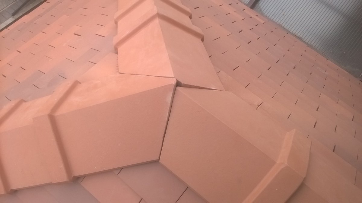

Roll top ridge hip mitre

Looking at the photo's it looks like he could have got another row of tiles on the ridge which would bring it in line more with the hip.
Here is one I did last week, as already mentioned you need the correct
ridge/hip angles 105 and 115 degree's on this roof.
obviously not finished!

Well he wasn't suggesting a mechanical fix, just sitting them on there.
:LOL::LOL: I don't think he explained the dry system to you in a way that you could understand.
I understood it alright.........'because they're heavy they'll be OK sat there, with pointing"......if mechanical fixing had been suggested in addition to pointing I wouldn't of had a problem.

Yes that looks more like what I was expecting, and for sure the 115 on the hip would have made life easier, but this was a special order from Marley so was told 105 would be fine. Obviously it isn't but as noseall said, this effect could have been minimized by adjusting the bed and some more skill / thought on the mitres. The question now is whether I can find someone local who can put it right and what the cost will be.....or I just live with it.
