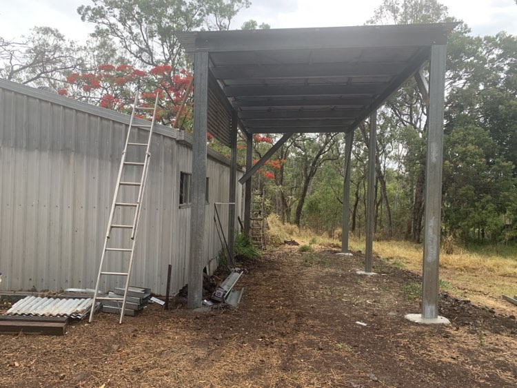

Can anyone else see what I see?
Have been unavailable to help a friend build this, sent me this pic today and can't understand why I said the handyman you found is a moron!
Why didn't he sloped it the other way?
Yeah, wrong direction to pitch a roof, it's in the far north Queensland wet topics, gunna take a mighty decent gutter to save the roof and structure of the existing building during the heavy to crazy heavy to insanely heavy down pours!!
Well braced too :rolleyes:
Easy enough to flip the slope the other way though
