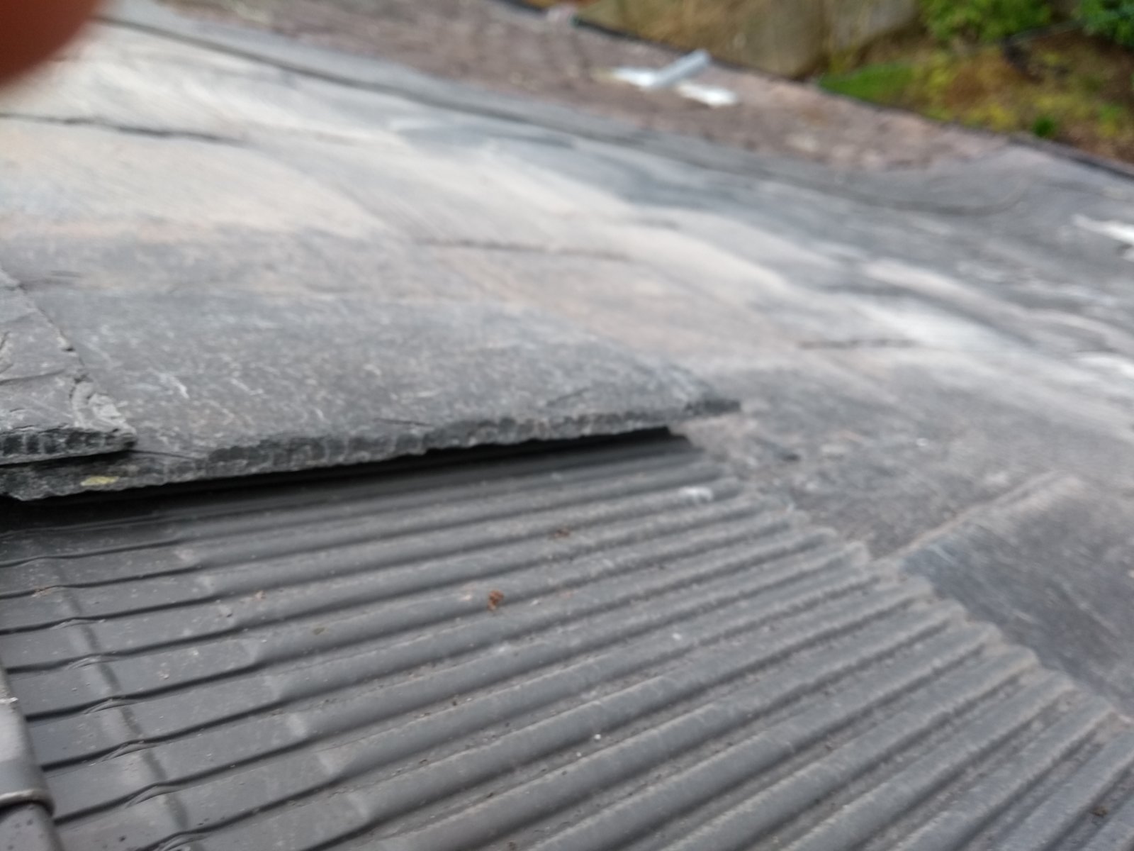

I have just had a new slate roof put on but just a bit concerned about the slating around the velux window. Slates sit at quite an angle. Is there any reason they should do that? Tia
Difficult to get a pic but maybe it helps?
Don't know if you can zoom in enough to see?

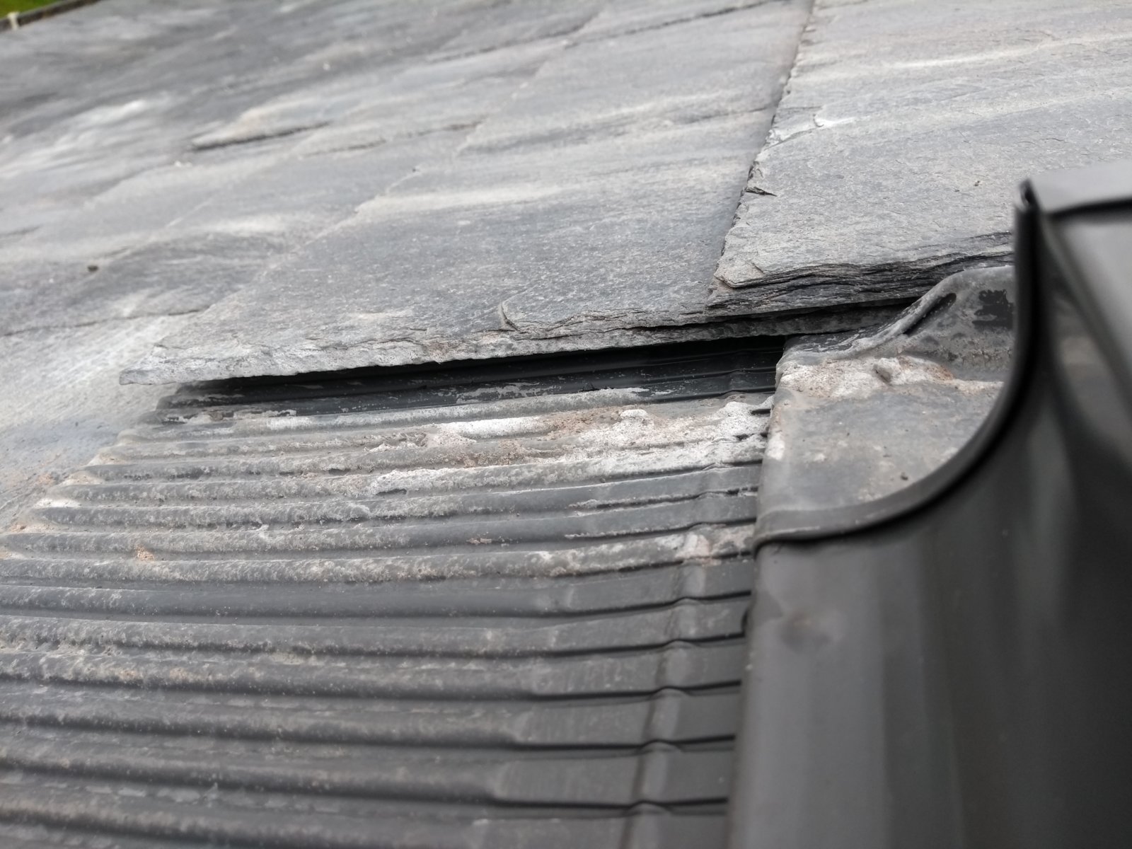

Can you post a picture of the side of the window to show exactly which kind of flashing kit was used. You should be able to do it from opening the window.
Does that help at all?
Why is flashing not the right type? Will it cause problems?

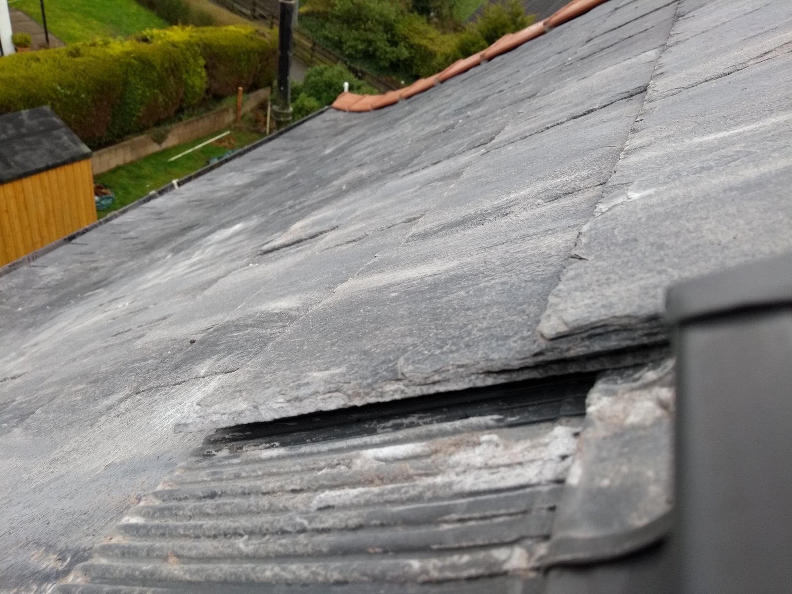

Other side. Not sure if it shows the flashing?
The slate is being lifted by the 7-10mm of flashing beneath it. Impossible to get completely flat, but there are ways to mitigate the lift created by the thickness of flashing.
^^^ Thanks. Would I be right in thinking that while it doesn't look particularly neat it should keep the elements out?
it is the wrong flashing for slate. It should be an EDL this is EDW.
with the correct flashing kit there is no reason at all for the slates to cock up
Why is it wrong? Because the wrong one has been used.
Ask Velux Tech support which flashing should be used for natural slate or even cement fibre and they will say use EDL flashing.
As it is it will more likely suffer from wind uplift and fixing positions must be compromised.

Is that because it's a one-type-fits-all type of flashing rather than specifically designed for slate?
I spoke to a window supplier and they said basically the flashing, that came ready attached to the window, hadn't been worked enough, which I guess means flattening out the corrugated pattern so as to allow it to lay flat.
Sounds like it's case of I'll know for next time.
