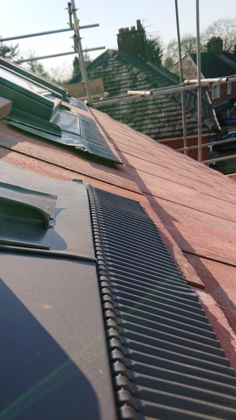

I'm after some advice...
The roofers have just finished and have installed 3 roof windows along with a completely new roof as part of what has turned into a nightmare of a loft conversion, but that's another story.
I am under the impression that the tiles running down either side of the window should project below the main side flashings, ending at roughly the bottom of the skirt. Also rather than space the tiles from the eaves to have a course ending at the bottom of the window they've cut the tiles below the window opening which I think has cocked up their tile positions around it.
The upshot is that a large area of flashing that I think should be under the next course of side tiles is exposed and has had to be stuck down rather than the weight of the tiles holding it there. When I challenged them over it they have assured me this is fine and they've always done it like this however I cannot find evidence of another installation like this anywhere.
Yes, it's wrong. A roof tile should cover that corner bit in your second photo that looks unstuck, or at worst, a max of 2" of the ribbed part not covered.
Yes again from me its wrong. Too dam lazy to cut the tiles and i'd say they used the wrong flashing kit as is not the one for plain tiles by the looks of it. They need to be stripped out totally and refitted by someone who knows what they are doing. Also not sure if it just the picture or angle but the tiles between the windows look like they are sagging or not fastened down correctly on the window edging.
As the others have said its not correct, Its the correct flashing kit but the window needed to be lower down the roof maybe 100mm ish just gauging from the picture or each of the 10 rows of tiles needed 10mm adding to the gauge, either way it's their problem and it's wrong.
Thanks for your comments guys, now to confront the roofer and judging by his response when I 1st questioned this and other issues it's not going to be easy. Hopefully building control will be able to back me up as well.

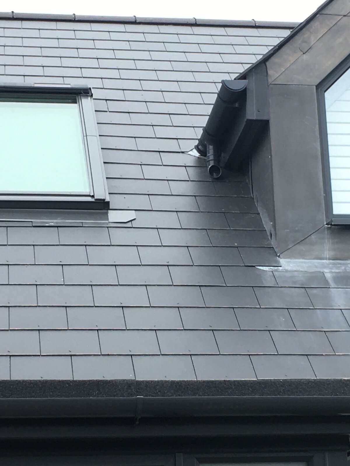

Picked up this thread as I think I have a similar issue. See photo attached.
The exposed flashing at the bottom of the Velux on the left chatters in the wind.
What do you chaps think is the cause?
This a slightly different situation and flashing . cement fibre slate gauge is set. if the velux was already there, then either you move it or live with what you have.
simple solution is a CDR on the corners which will hold the flashing down.
there are a few cdrs missing fwiw
Thank you datarebal.
The whole roof/dormers/velux are new. Velux have said the warranty is void because in their view the window has not been installed as per their instructions.
What is CDR?
