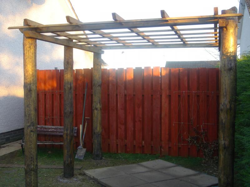

I've been chainsawing trees again today but managed to fab and fit the roof beams and trellis over the weekend, well chuffed with the look, just waiting on the drawknife and coachbolts to final fix horizontal beams. I'll get the camera out tomorrow and post a couple of shots.

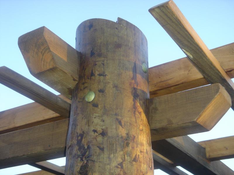

A couple of shots of the frame progress. I am still waiting on the coachbolts and drawknife, hopefully tomorrow.

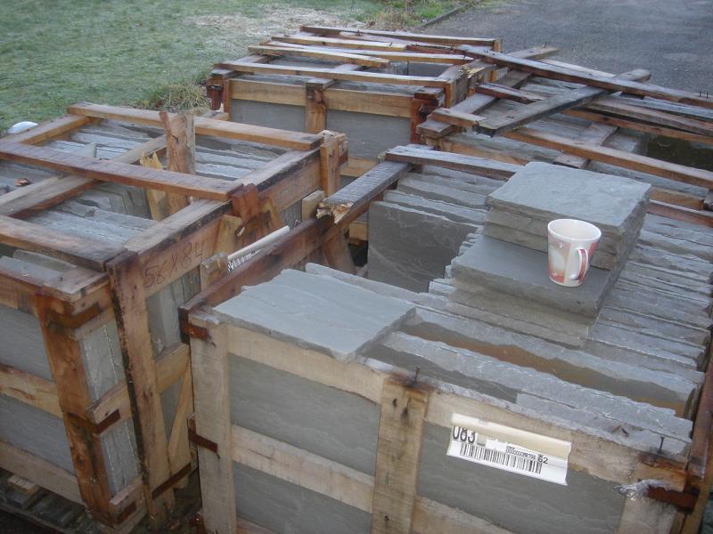

I ordered my slabs yesterday from a company called MR International. Ordered 50Sqm which will do nicely and get half the area done. The other half will be decked. There is a link below if anyone is thinking about slabbing this year. Really pleasant Fella i was dealing with. Slabs should arrive tomorrow.

Made a bit of progress on the pergola. My drawknife and coachbolts arrived, this allowed me to finish the frame as far as i can at this time. Hope you can see the difference.

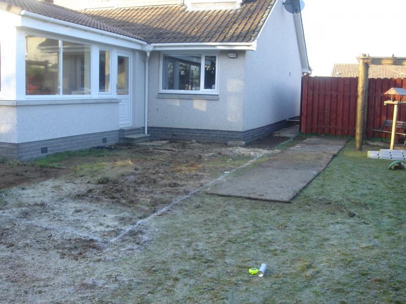

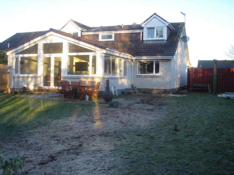

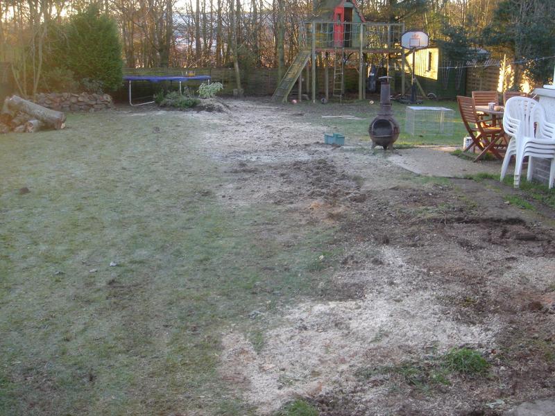

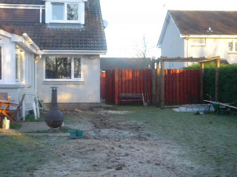

I finished my chainsawing of trees(only taken me 5 months). I hired a great bit of kit called a stump grinder. I had not used one before, it took 12 of 20 year growth tree stumps down to 100mm below surface in 3 1/2 hours! That is a top bit of kit. Price was £45 per day from Travis perkins.The shot below shows the old boundary line between my original garden(right) and the newly purchased one(left).
The slabs were delivered at the end of last week and i am happy with the quality. I had a quote to dig out, lay and compact base, full mortar bed for the slabs and point in between. The price is £1,750 plus £890 for the slabs is £2,640 for 50sqm. I am displaying the prices as it might help someone else further down the line as a quote reference.

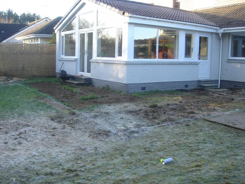

I also cleared the area and marked out where the patio will be laid. The before shots below, i hope the afters look way different! Machinery arrives Saturday morning and on we go!
