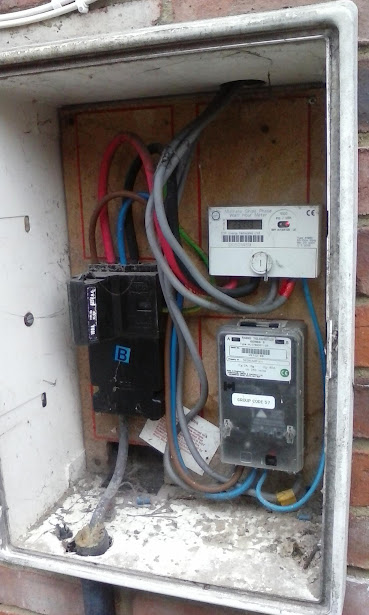

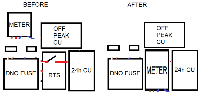

as no one has a three-week holiday in August.Energy Saving Trust said:When your RTS meter is scheduled to be switched off, your energy supplier should let you know at least two weeks beforehand.

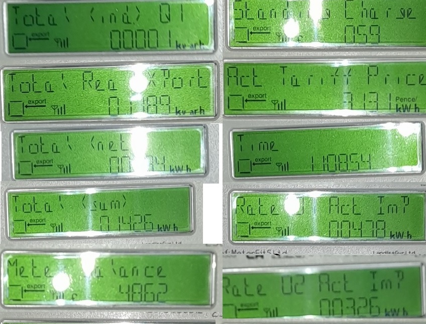

November 2023 I found I needed a Smart Meter, three visits before fitted, finally fitted January 2024, but lacking the new MPAN number for export, can't blame the solar panel installers, as can't get MPAN number for a meter no yet fitted. Moved suppliers end of April 2025, two weeks latter the MPAN number sorted.
In my case, I was only loosing money, annoying, but not life-threatening, for the heating system to fail, is far more serious. It seems so easy, one buys a plug in electric heater,
and one has heat again. But I have seen other old age pensioners, just because this old guy can sort things, does not mean all can sort things, and @SUNRAY shows how what should be simple, can go very wrong.That must be wrong, it is up to the supplier to do all required, for some thing the customers requests, like my asking for a smart meter due to having a PV array installed, yes, I have to arrange my new stuff, to line up with the meter, but to change existing to new system because the supplier wants it done, that is down to the supplier.Leaving instructions that they need to get an electrician in to reconfigure their heating CU wiring.
He said he was not permitted to change the fuse, but he did tell me that a 60 amp one was fitted, which was all I wanted to know, he did not realise CT coils need to go the right way around, but other than that, an excellent job.
Seems the suppliers have a problem with their training program.
