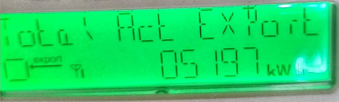

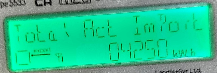

The meter with serial numbers blanked, so just button A and B
no other buttons. Each time pressed, it scrolls to next reading. But without any instructions, really no idea how to read it. Not really worried as the app tells me what they owe us, but to say easy to read, clearly it is not.What pink thing?

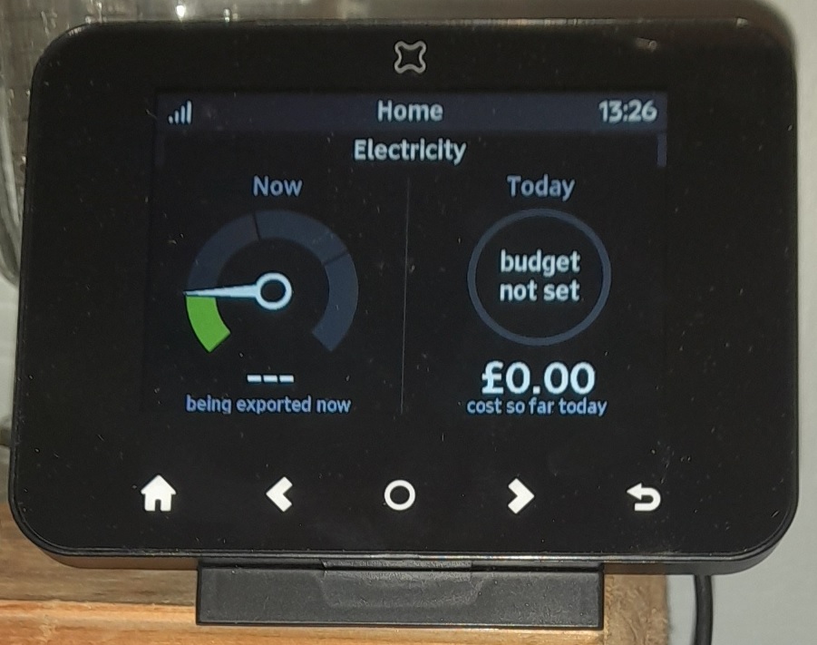

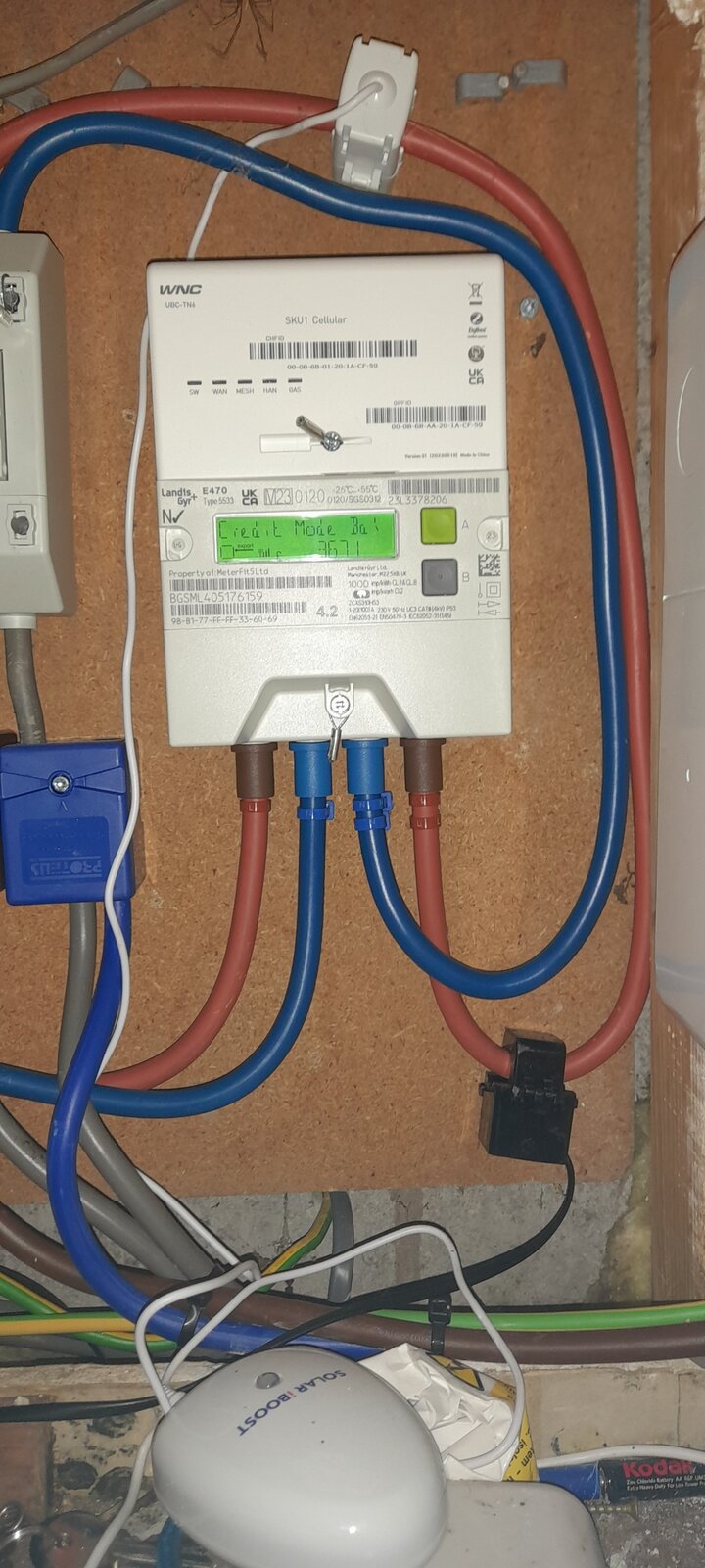

most of the day, what I want is how much am I using now, and how much battery is left, with 40% battery left I can simply put the dishwasher on before going to bed, with 15% left, want to set a timer so switches on after 00:30, so now exporting 1.6 kWh and 99% battery.I agree completely, the only reason I can come up with is the limited and conjested space between the fuse and meter but it is only a 60A fuse so could have used a bit of 16mm².That is nearly as I would have expected, I would have thought the neutral would use a Henley block, but seems unlikely to make much difference either way, but now it should work as normal, the meter doing the switching.
Glad to hear all now OK, hope every change is not like this, but it was three visits to get my smart meter fitted.Anyway all resolved and thanks to Rodders for pointing out the most obvious.
Mine wasn't smooth and a short time after installation provider requested readings as they couldn't access it but not heard from them since.Glad to hear all now OK, hope every change is not like this, but it was three visits to get my smart meter fitted.

Then continuesTo read a Landis+Gyr E470 smart meter, locate the display screen and the "A" and "B" buttons. Press the "A" button to wake up the screen (if necessary) and then press it repeatedly to cycle through the readings. Look for the "TOTAL ACT IMPORT" reading, which represents your current electricity consumption. If you have a two-rate tariff, you can access the different rates by pressing and holding button B to view the tariff display and then pressing A to switch between rates.
Pressing button A does scroll thought many options, includingDetailed Steps:
- 1. Locate the meter and buttons:
The Landis+Gyr E470 smart meter will have a display screen and two buttons, typically labeled "A" and "B".
- 2. Wake up the screen (if needed):
If the screen is blank, press button "A" to activate it.
- 3. Cycle through readings:
Press button "A" repeatedly to navigate through the different display screens.
- 4. Find "TOTAL ACT IMPORT":
The reading you're looking for is typically labeled "TOTAL ACT IMPORT". This is the total amount of electricity you have consumed since the meter was installed.
- 5. For two-rate tariffs:
- Press and hold button "B" to access the tariff display.
- The first screen will show the first rate's reading.
- Press button "A" to switch to the second rate's reading.
- 6. Record the reading:
Write down the numbers displayed in front of "M3" (for gas) or "kWh" (for electricity), ignoring any leading zeros or numbers after the decimal point.
however the button B asks if I want to enter code number, and if I want to delete data, but there is no off-peak that I can find, so same as last time I tried, without knowing peak and off-peak, the meter is a bit useless.Move house to a place without smart meter.So back to @DiyNutJob you say it is easy, please explain how to work out what is peak and what is off-peak, as I simply can't find it, I will as in wife's name ask her to get the pink thing, but should be able to read from the meter with ease, clearly that is not the case.
