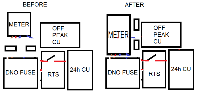

The big issue has been the space, the new meter is more than double the size of the old and it is all really crammed in, imagining a meter box on it's side won't be far off.

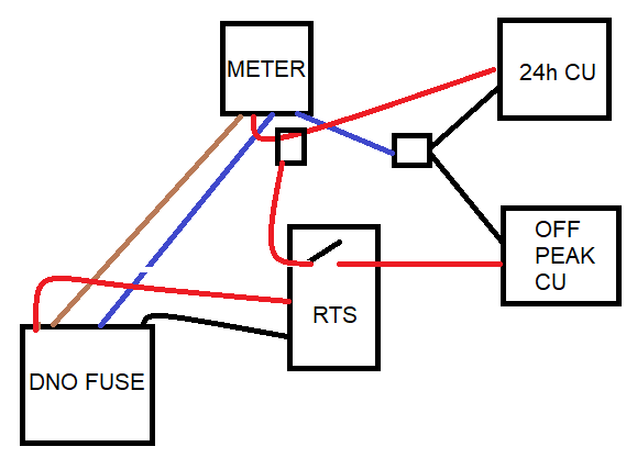

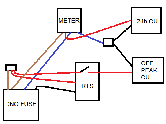

My main reason for posting this has been the way the offpeak RTS and CU is wired directly off the DNO fuse and not through the meter. I imagine due to the Henley blocks being moved to make space. Unless of course it's always been like it!
Without an isolator, there is very little an electrician could do. I did look at the smart meter which switches the supply, but for me, it would not really help as too much rewiring involved, it is a problem reminding my wife when things can be set off, the move from 00:00–05:00 to 00:30–05:30 when we changed suppliers, does seem to catch her out, in summer no problem there is normally battery left anyway, but most the heavy users washing machine, dishwasher etc, use high power when first turned on, over running at end of off-peak unlikely to cause a problem, except for dishwashers which dry the dishes.

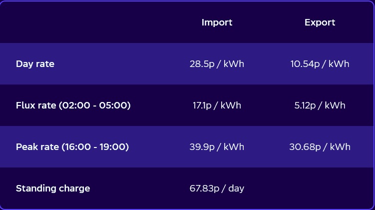

What I do question is the huge difference in off-peak tariffs, why should someone charging a car with off-peak pay very much less as to someone heating storage radiators? We are looking at as low as 5p/kWh OP for some EV tariffs, but economy 7 more like 20p/kWh, OP it seems robbing from the poor to give to the rich. Many poor people have storage heaters, only the rich can afford EV cars.
Yes, the peak also shifts, but looking at rate designed for solar panels Octopus Flux and compare with rate offed for non-tied EV users Octopus Go, and the Flux rates do not seem to make sense. Oct Flux end April.jpg the non-tied Go rates are 8.5p/kWh and 30.17p/kWh and export is 15p/kWh as long as the export rate is the same or more than off-peak, one can fully charge batteries overnight, but if export is less than off-peak, then one needs to be careful not to run out of room in the battery to store solar.
First 18 months of solar, I was not paid for export, and the second battery resulted in me loosing money with an off-peak supply, and I was better off with a fixed 24-hour rate.
So now, looking at Economy 7, does it save the user money? And what will be the result if they went to a 24-hour fixed rate? For the user, only heating rooms as required, can dramatically reduce energy used. I found this with oil fired central heating when I fitted 10 programmable TRV heads, so rooms only heated as and when required. So in spite of not getting off-peak, the bills could drop.
Isn't that a lot to do with EV's being able to use intelligent charging, the supplier being able to control the charge? Whereas charging SH's takes place, with zero control available to suppliers.

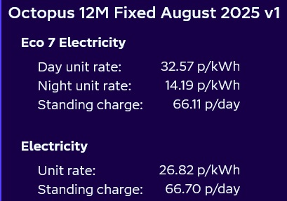

With intelligent charging, 5p/kWh off-peak, with user control 8.5p/kWh off-peak, solar 17.1p and Economy 7
Moneysavingexpert said:
Updated 1 July 2025. (1) Energy usage calculated at 3,900kWh/year. Average prices across all regions (average day rate 32.13p/kWh, average night rate 14.06p/kWh, average daily standing charge 51.2p/day).
So they pay more both day rate and night rate to me with "Go" with 8.5 p/kWh and 30.17 p/kWh 66.11p/day their gain is it is got 7 not 5 hours. Average Eco 7= 24.495p/kWh Go = 25.65542p/kWh it seems the rates have changed, but in the main without some battery and inverter in Summer we will use more in the day as to at night, so we still need to use power at the right time. And not lose it due to heating rooms when not required.

Oh dear, the property in question has 6 NSHs and immersion heater on 60A fuse (according to the paperwork left by meter fitter) on a looped supply.
Assuming all are 2.4KW, even the 2 large ones???
None of this has altered since the owner purchased the house new in the late 60's. Wiring shown red and black are the original black 16ishmm² tails, brown and blue are new 25mm², pressumably installed by the meter fitter.

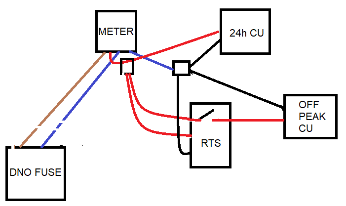

If that is true then he's never paid for heating or E7 hot water since that date. Has he got pics of before and after the smart meter install?

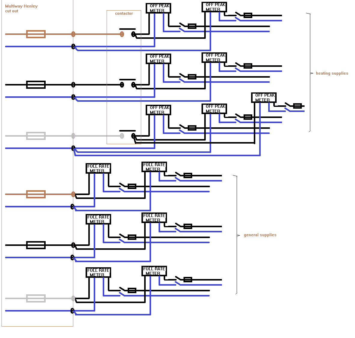

RTS installs often had two separate meters (peak / off peak) see the example on the energysavingtrust.org.uk/rts-meter-switch-off web page rather than single dual rate meters.
https://www.diynot.com/diy/threads/faulty-meter.557170/ has another picture of one: Note the RTS unit has an un-metered input from the DNO fuse (power for the receiver/ E7 load contactor coil) as well as the Live from the meter itself via a Henley and the switched Live out.

TRS installs often had two separate meters (peak / off peak) see the example on https://energysavingtrust.org.uk/rts-meter-switch-off/rather than single dual rate meters.
Yes that is just as I'd expect it to be connected:
However I've also seen plenty (especially where the meter is remote from the supply) where the permanent supply to the RTS is metered:
