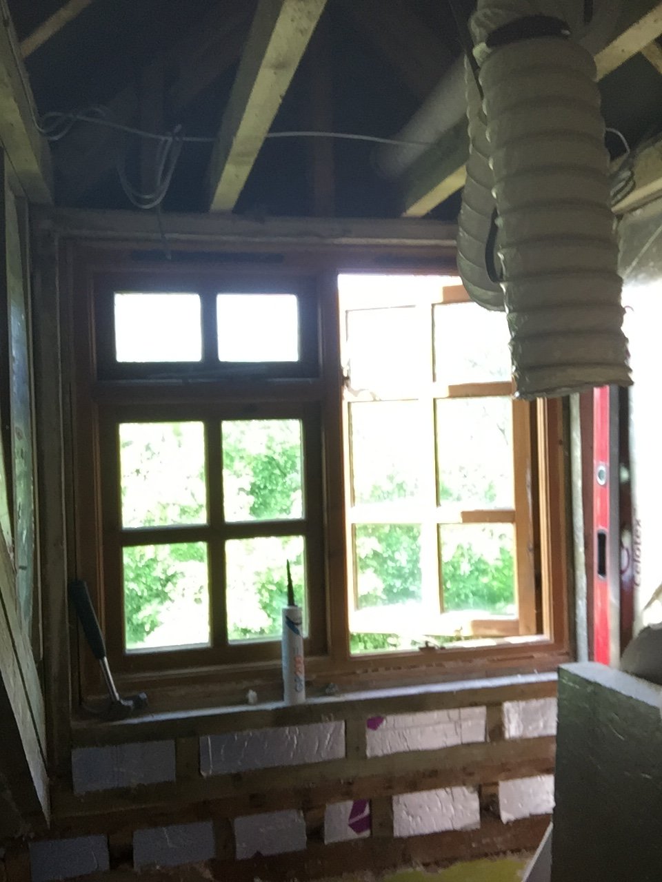

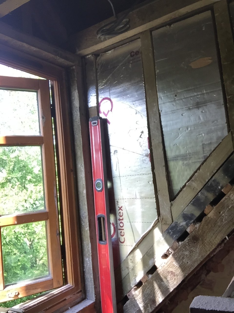

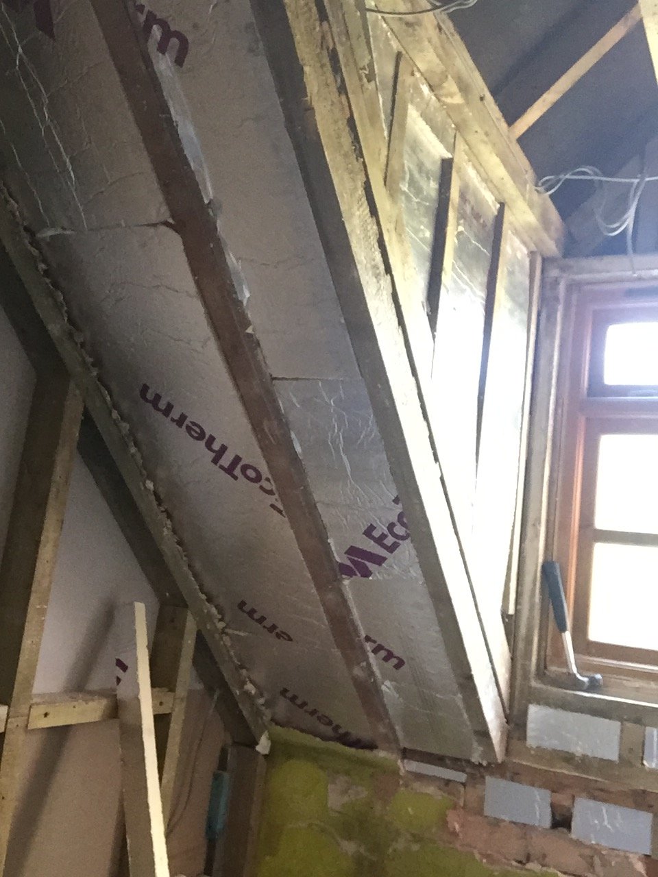

i have a bathroom to refurb for my niece and there are a couple of tiling issues that I would like an opinion or advice about please
The issues are the underside of the wing walls and the vertical sides leading to the window
They are going to be tiled, whether I like it or not, onto plasterboard, so can anyone offer any advice about keeping the tiles on the underside
Also the ceramic 600 x 300 tiles have a brown edge and she is adamant she doesn’t want tile trims , metal or plastic so any suggestions about an alternative method or something that will make the edges look reasonable
Thanks in advance

You could ditch the ceramic tiles and go for porcelain/stone tiles (you can "dress" the edges of porcelain/stone tiles).
Alternatively you could use a quarter round edge tile. The joins in the edging tile will not meet up with the grout lines though.
https://www.originalstyle.com/tiles/product/KB5916
WRT tiling on the angle, hopefully someone else can recommend a high grab adhesive. My experience is limited to the underside of window returns.

High grab adhesive or sticks like sh1t , they are going on there
Slight update about the job as of this morning
The ceilings and vertical part. Of the wing walls are being plastered
The underside of the one wing wall is being tiled . It is over the bath , that has a shower as well , so the water from the shower will splash on that wall so not a lot of choice.
