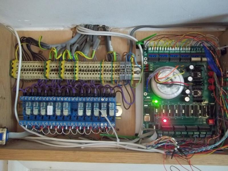

controls 4 lamps with dimmer function controlled by the buttons.
the prototype of the controller for 12 lamps ( own design )

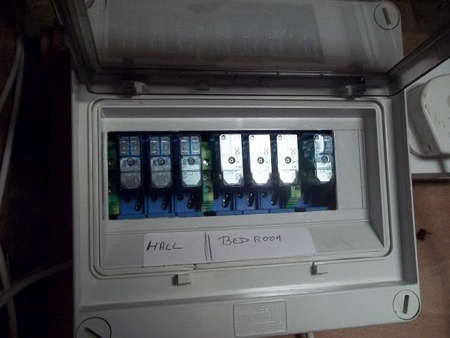

relays remote from the controller, allows for a single 12 core alarm type cable to replace a lot of 1mm² twin and earth
